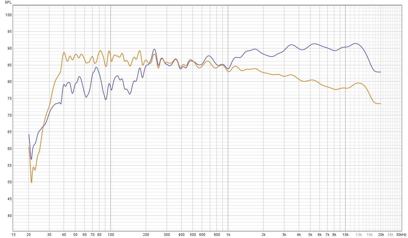

The cabinets spent a whole night under heavy weights. I measured it once again at 1 meter and then EQ'd it properly this time. It seem to have fixed issues I was having in the 100 to 200Hz region. Does that mean I probably had a leak, and I probably fixed it now?
I'm pretty happy with how linear the response is now.

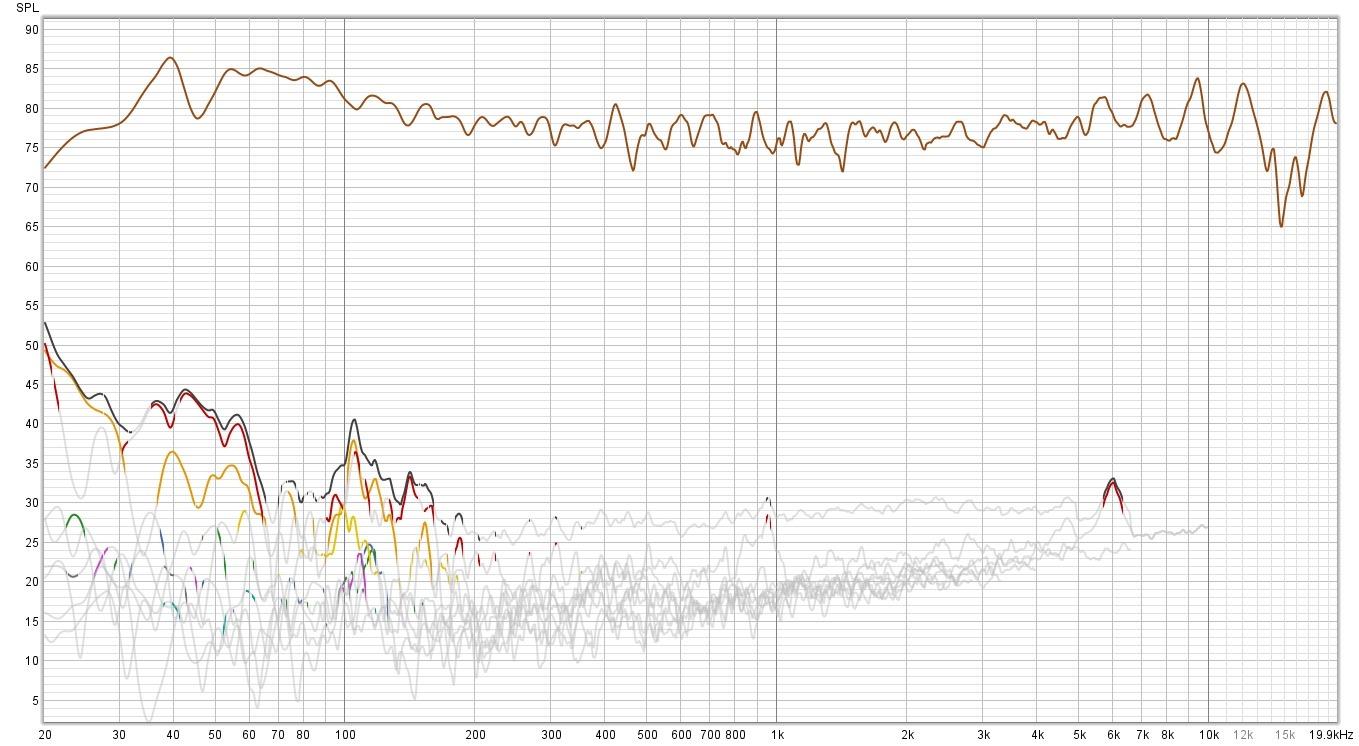

How are these distorsion numbers? I don't really know what to make of them. Distorsion is naturally higher below 200Hz because that's where I corrected the otherwise droopy response I was getting in that area, but it sounds right to my hear. Maybe a tad smudged, but also large and expansive, which is a good thing to me. Otherwise, what's the point of large cabinets?

My bad, didn't see your post. Indeed there seem to be something wrong when I first measured it. Here are todays measurements after some fixes to the cabinet. The measurements were done with the speaker on a stand and some weight on top of it. The cabinet is really light and needs some added weight.
Orange line is EQ and blue line is not EQd. It seems to have removed that massive dip in the 200Hz region.
Per Geddes, i tend to not pay them much attention.

i am sensitive to distortions, and looking at post 104, that’s way too much.
you are trying to beat the driver into a shape it does not want to be naturally.

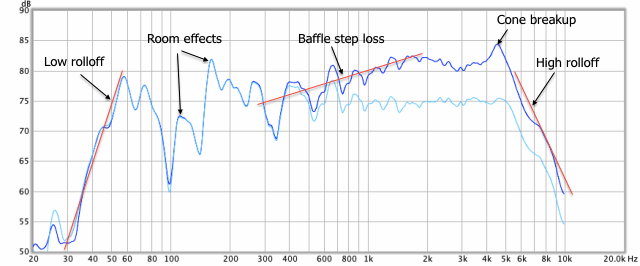

I've checked what baffle step looks like on a frequency response, and mine looks oddly in line with that, could that just be it?

The drop at 200Hz is not baffle step loss.

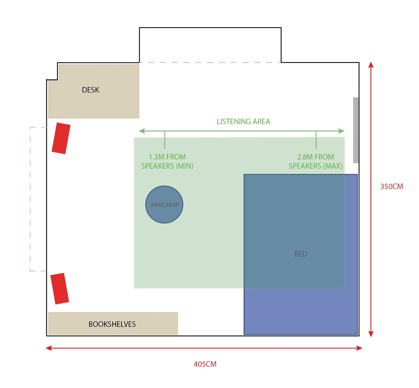

I'm trying to familiarize myself with enclosure design, but it's going slow since I have zero point of reference, apart from indulging in many of the forum's threads. So I was hoping someone could chime in and push me in the right direction.
Here is a plan of my room with hypothetical speaker placement and listening area.
The (hypothetical) speaker placement is represented by the two, toed in red rectangles. As you can see, they would need to be placed fairly close to a wall, I guess that's something that should influence the design I end up picking.
Here are a few pointers as to what I want:
- Cabinet size is not an issue, I can go pretty big.
- I would like to milk as much bass capabilities out of these drivers as possible.
- I listen to a lot of electronic music. Deep house, ambient, techno, and some more acoustic genres. So I'm looking for the lowest possible extension. I guess my room will play its part in that search?
- I will almost always listen to them at nearfield levels, sometimes a little more, but I'm not necessarily looking at concert level playback. Just enough to fill my room with sound.
- I intend to buy a UMIK-1 to measure the speakers and correct my room through EQ once they're built
- I like the Betsy-K design a lot aesthetically. I would prefer the speaker to be wide rather than deep, if that's feasable at all.
- I will build stands to prop them up to a good height.
Any advices welcome, thanks!

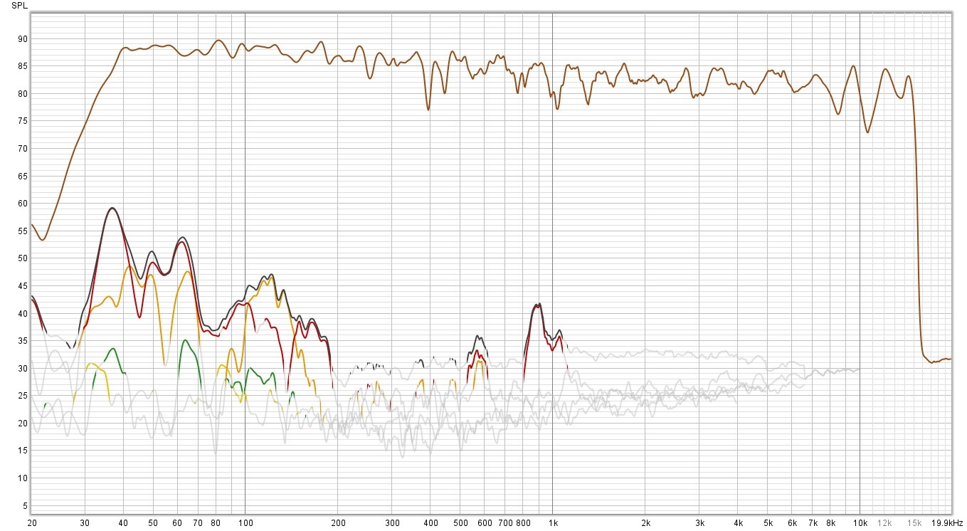

I finally got around to building the second cabinet. I implemented lessons from building the first one, and I also bought a new glue. It's so much better than PVA in every way. It sets really quickly, it's very strong, it can fill large gaps, can act as a sealant, and also remains sorta flexible, which I'm sure is doing some sort of job absorbing vibrations along the way.
Here are the measurements for the second speaker, corrected with Equalizer APO. As you can see, the distorsion is much, much lower than the first box I built, and the speaker is also somewhat able to dig even deeper (almost usable to 25-30-ish Hz).
Compared to the first box:
Overall, I'm very happy. Thanks again @Scottmoose for supplying me with the design.
