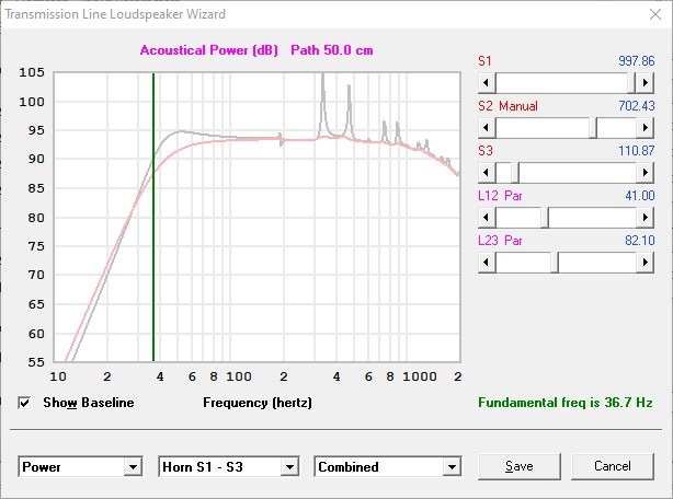

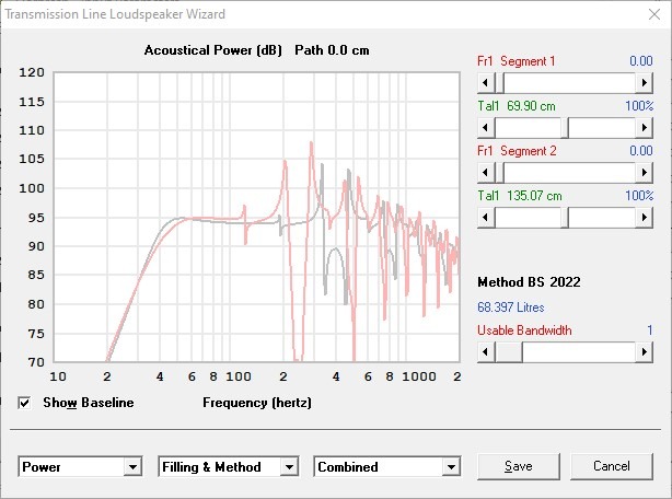

Using BS2022 method in HornResp gives a reasonable looking first draft in a 68L tapered TL for the SB20FRCP30-- light stuffing and guessed path.
Thanks for all your answers! I spent the better part of my night (got to bed at 4AM) playing around with HornResp and reading all I could about transmission lines. I finally somewhat made sense of how things work. I might go all the way with this and really try to design my 'own' speaker

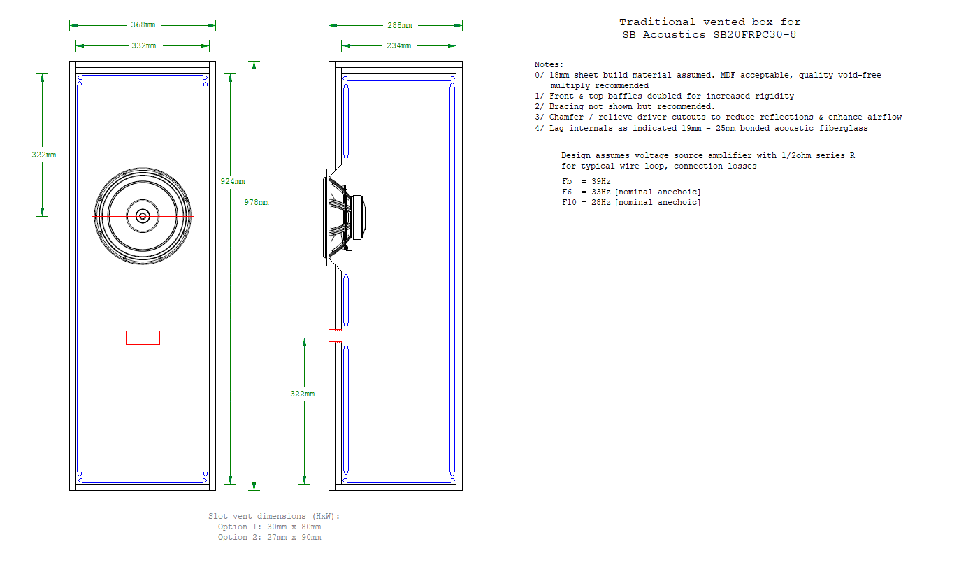

Agreed; I was thinking more alignment than the duct shape per se. I did have a look at a rectangular, but CSA was a bit smaller for the 36mm baffle thickness than I usually like & without being able to test it I wasn't sure how extreme we'd need to go in the aspect ratio for a larger vent area. That's probably just me being over-cautious; as a temporary SWAG though (it's about 0350 here 😉 ) a 14mm x 150mm slot should get us roughly in the region.
Reactions: GM and Mitch311
Hmm, anything over ~9:1 is moving towards aperiodic with Altec's A8's 12:1 damping this cab's horrible box modes.
Right, that was the idea; I was going for about as large an Av as I could there (while boss-eyed at some unnatural hour 😉 ) for the target Fb & 36mm baffle thickness, & relying on a bit of loss since I was winging it & couldn't check. Better (now I'm able to look at it) would be 30mm x 80mm, or for the frictional limit about 27mm x 90mm, with the 36mm baffle thickness. That's maxing out the CSA for roughly the target tuning without ducting it.

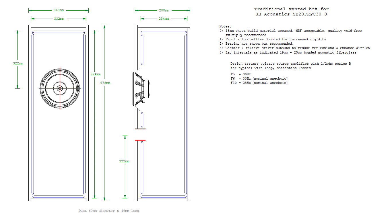

Sorry, I'm not following. This just a possible vented box for the SB driver, isnt it, rather than an MLTL. So wouldn't a round port be an option?
Functionally it is. This is basically GM and I having some fun as we're both paid-up fans of the old ways. 😉 He's just pointing out that because I used one of the traditional pre-T/S BR alignments for the box above (which were largely created by Western Electric / Altec etc.) I really should have used a rectangular vent of baffle thickness for the full 'authentic' design method, because that was how they were done back in the day. Corrected, or at least option now provided, above. 🙂
