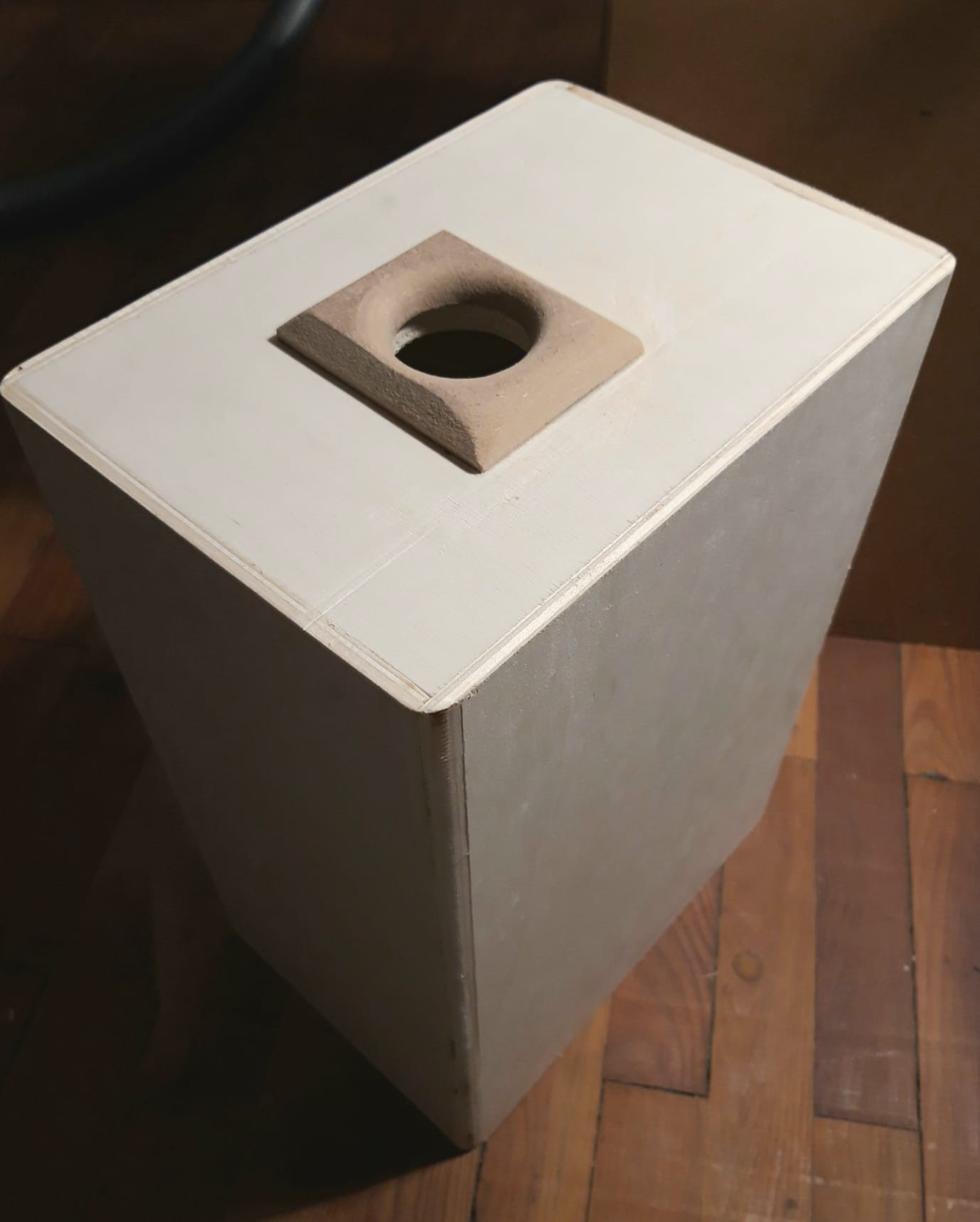

Well I measured the woofer and mid outside and came up with some good 4th order filters, I can still just hear something off with the port and bass.
I know speakers are compromise but I don't think anyone would be happy with what I'm hearing, really calls attention to itself. I've reached the point where I no longer want to troubleshoot this and would like to start over. I'm not sure how to avoid the same problems but I may make a new build thread and hope others can help sort out something better. I am thinking a separate bass cabinet that will save my back and allow flexibility with bookshelves.

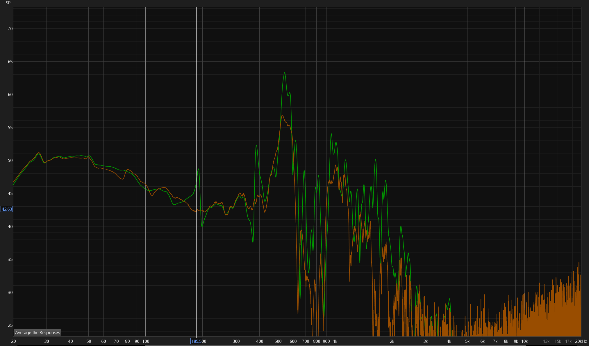

Well actually, it may be too early or abandon this cabinet. I did one last ditch effort measuring the speaker outside to see how my current filters respond to the raw driver response, while not as smooth as I'd like, look at the woofer. It has elevated response above 100hz that a simple low pass wouldn't work with. I believe this is the cause of my troubles. What do you think?

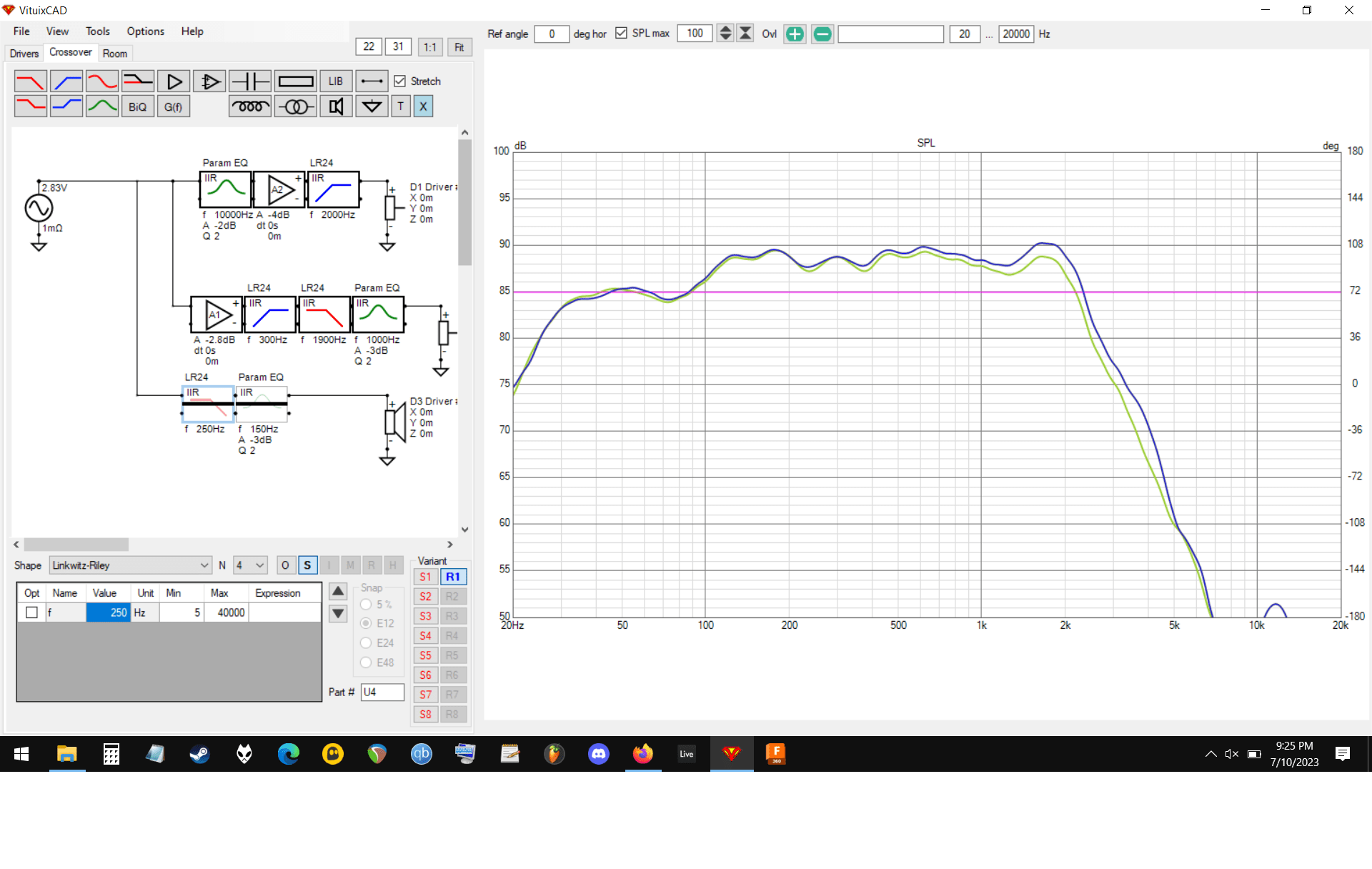

Hmm, not too sure how accurate that is. Speaker was about 5 feet off the ground, pretty much nothing around but some tree's, mic 1m away at tweeter height. When I tossed the pit viper crossover on it, vcad gives me much different results than what the speaker actually measured with the passive network. Not sure what to make of this.
The problem is obvious; I had similar one.
Your cabinet is quite tall, so a standing wave forms in a woofer operating range. Appr. 160 Hz resonance corresponds to ~1.1 meter half-wavelength, which seems to be the vertical dimension of your enclosure. Pressure maxima are near the boundaries, i.e. cabinet walls, right where you placed the bass port, where standing wave influence is as strong as it can be. The solution is to move the port to the middle of back panel, where vertical standing wave have a pressure minimum.
Another, more complicated option is to add tuned Helmholtz absorber inside the cabitet at the top boundary. By doing so in one of my designs I was able to kill two first modes of a tall cabinet with a set of tuned absorbers. My cabinet was slightly lower, so it resonated at 180-190 Hz instead of 160, but underlying principle is the same.

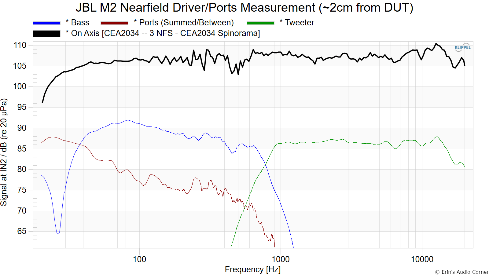

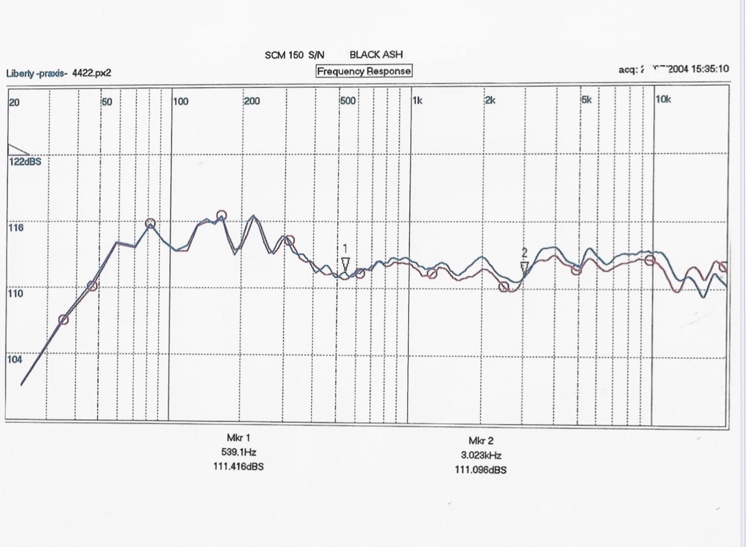

If only they didn't suffer from the same problems. The esteemed JBL M2 have tons of resonances in the midrange and kinda subpar cabinets. Original ATCs resonate too.
JBL M2 resonances at 250 and 600 Hz
It really takes a special effort to tackle box and surround resonances. Most audio companies don't care.
As a stopgap solution you can cross sd315a and dc130 at 100-150 Hz, so the longitudal cabinet mode (mostly) won't be excited by the LF driver.

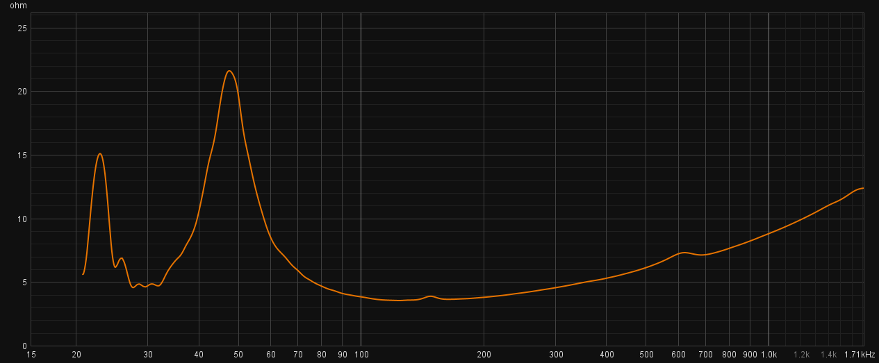

Reflex has 2 peaks. First peak defined by volume of the box , and any cabinet leakage issues will cause a drop in that peak.
Second Lower Notch is port. Same thing any leakage issues will be shown by a drop in that impedance.
Looking at the lower peak. It is very low around 15 ohms

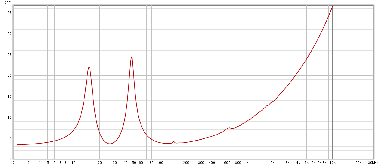

This seems to be another impedance measurement after you wrapped the port with Rubber.
Impedance for lower peak went from 15 ohms up to 22 ohms. 7 ohms difference
Extended models for T/S use 100 for no loss port and 0 be full loss.
Equivalent model shows almost Qp of 8 to match what you have, and to get up to 22 ohms would be roughly Qp of 15 to 16
So pretty big change occurred. And with round tube efficiency usually very good around 60 to 80 in a model.
Cabinet Q changed by 2 ohms. So that is a jump but smaller jump.
first measurement shows a lot of Port loss
Second measurement seems more " normal" compared to models at cabinet leakage at 7 to be around 28 ohms
So to match your first impedance peak in a model, leakage would need to be very low at 3 or 4 when 7 is about normal
I would say port is experiencing extreme losses, and overall cabinet is experiencing losses as well.
Aside from vibrational losses would look at actual gaskets just in case.
Seems if you can feel or hear the actual port rattling or vibrating and the cabinet vibrating.
that is where most the losses are happening.
So add braces, and add a few supports under the port so it dont vibrate.
actually the cabinet looks ok and was planned pretty well.
Matter of bad luck.
Ive built ports with PVC pipe and worked ok.
Actually first try was a disaster. I wouldn't be too discouraged.
Actually after you wrapped the port it seems like a pretty normal curve.
Looks like a reflex with somewhat low tuning and overall leakage of 3 or 4
when it should be around 7
Basic Bracing, and add glue / supports to the port
