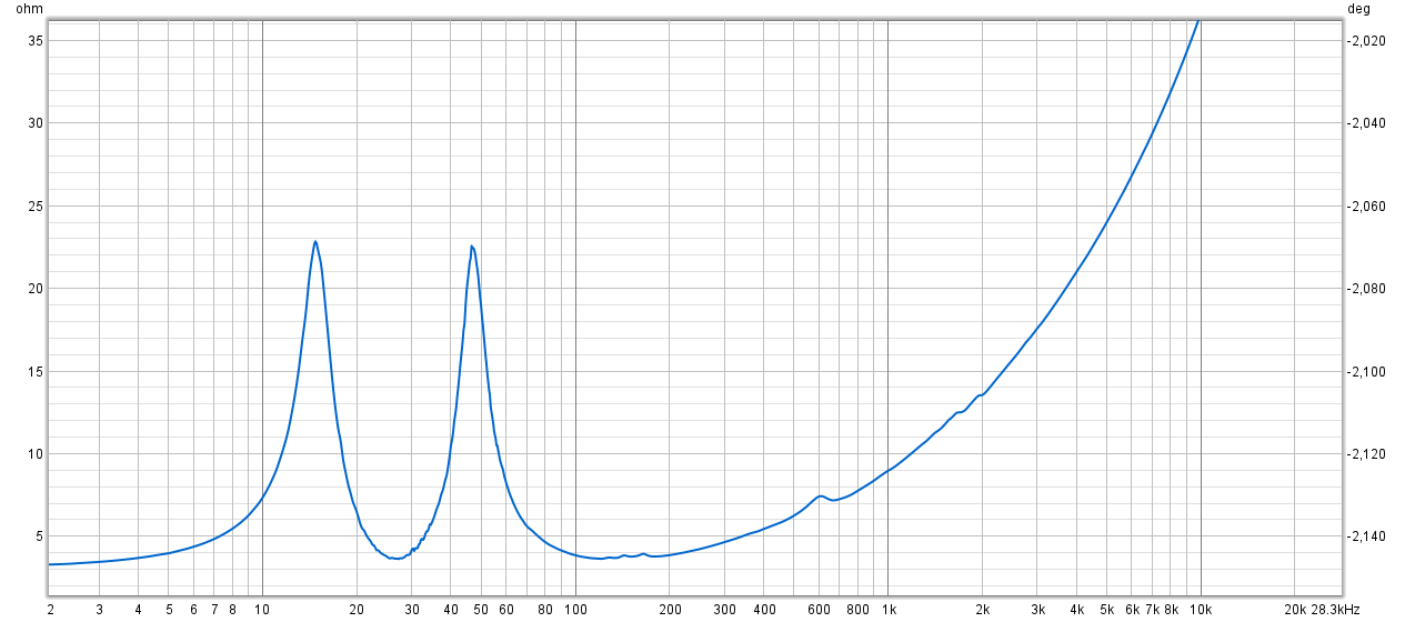

Found a piece of 3" inch pvc and cut the length, wrapped it in gasket tape to make a snug air tight fit inside the 4" inch port. Resonances measure louder while port output went down.
I cut some braces from leftover red oak, put in two, one just above the woofer magnet and in the middle of the cabinet, and one between the port and woofer, no measureable changes.

However tempting the path of least resistance is, it's leading nowhere. It's not the braces, nor the port tube itself, it's a column of air resonating. Make a tube 10-15 cm in diameter, (your cab inner height)/4 in length, close one end, place it inside the cab so open end is near the top corner. That's your tuned absorber. Or plug the front port and make a new one in the back at H/2. Or both.

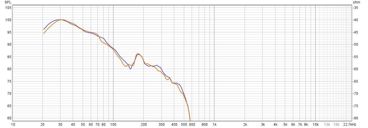

orange is with 7 inch tube.
with tube impedance, I lost my test resistor and my multimeter is giving me overload with no leads connected, its a very old fluke, so the imp is reporting lower than it really is. I had to guess on the 100ohm.
I don't think this a solvable issue. No suggestions are working and some don't even make sense to me, the resonant tube really did nothing and peoples confidence in things that don't seem to work is a little exhausting. I do mix work and I cannot work on anything with this resonance, I simply do not trust what is happening in the 150-200hz region. Some songs, the resonance just absolutely screams at you. The only thing I have to try is to cut the ports and try some other rear mounted ones. I'm open to suggestions on port sizes, quantity, and location. Then again if the issue is dimension related this could also be a waste of time.

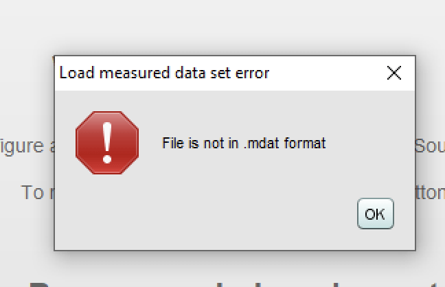

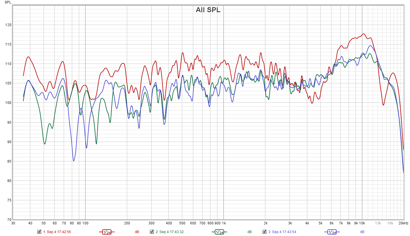

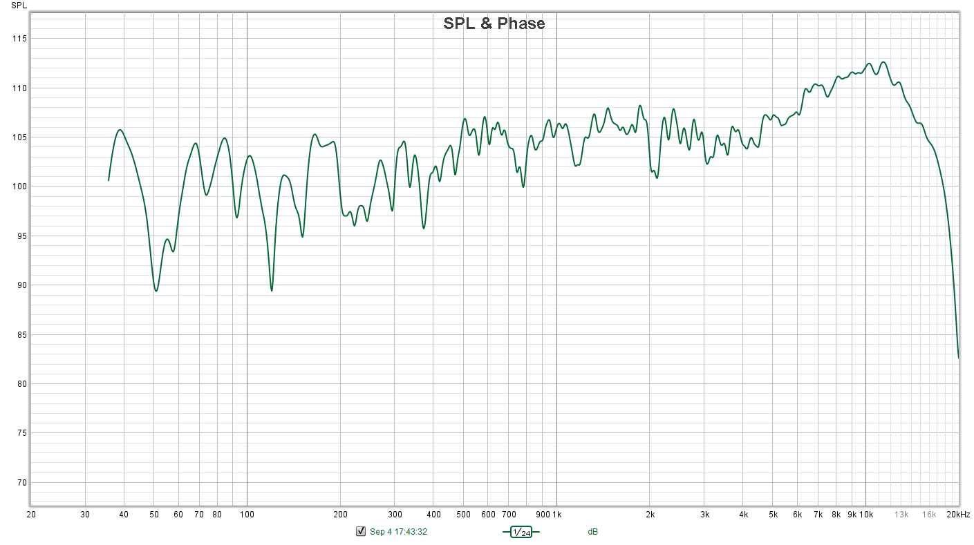

Feel free to look at this mdat. Just some quick measurements. Left mid and tweeter are louder to help with hearing imbalance. Hopefully ou know what REW is because last time I shared an mdat someone here actually got mad at me because they didn't know what REW was. That was a strange interaction to say the least.

Holes at 67 and 142 Hz are your room modes. Nothing to do with speaker itself. Any speaker at that position would excite them.
Not worried about the holes, yeah that's the room and placement.
I really think it's that ~178hz peak on the port graph, because a parametric EQ filter levels it out, it is audibly "fixed". Of course I'd rather not have that at all. I did try removing the port but there's no way it's coming out.

You were right about needing to update/reinstall.

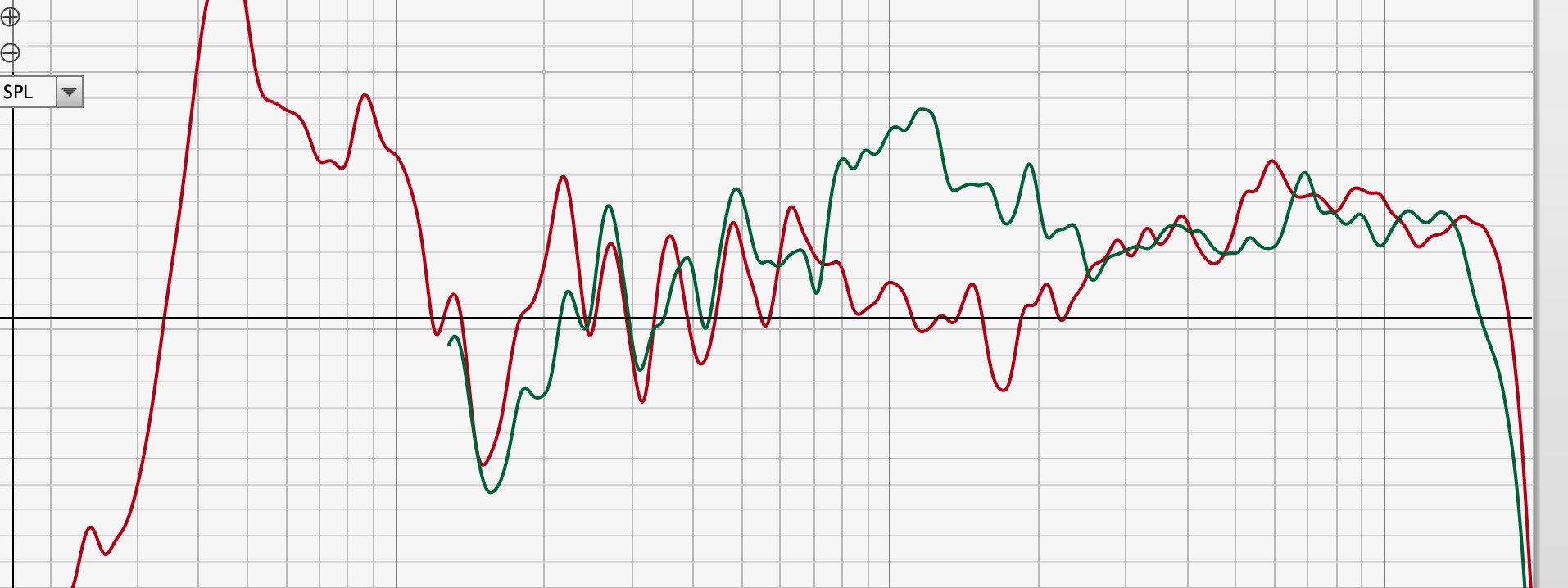

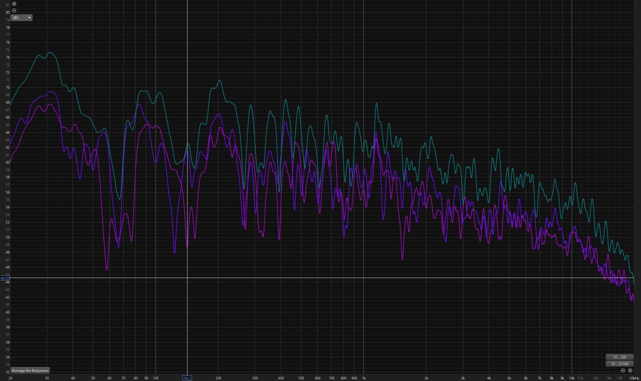

These are two REW measurements I'm hoping will help you understand the room mode theory and why EQ is your best solution. If these problems don't exist in free air, they are the room. Taking it outside and getting some 4pi measurements is all about eliminating reflections from the measurements. Here are three speakers that do not have box resonances demonstrating serious resonance in-room. The first two are my friend's B&W 807 S2's in green and the red is Sonus Faber Lumina II's. Each speaker is corner loaded to some extent and the result is an impossible to remove suckout. The next picture is my own set of three-ways demonstrating a number of rippling resonances. Green is left, blue is right, red is L+R. You can also see a cross cancellation between 4-5khz when the beamwidths overlap. All of these speakers have hard edges which diffract sideways. By smoothing them, you can reduce the resonance of the room. Hope this helps.

I'll have to try to measure them outside again and get better low end results but that's really hard here.
If this were a room problem, why do I not hear it with other speakers in the same spot? Also the issue is at like 178hz which I can't see the baffle edge having much effect over.
