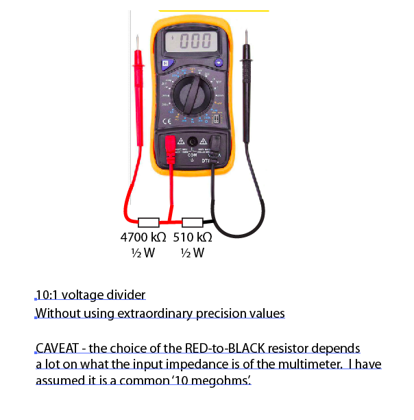

I only have my Arduino-based multimeter to test voltage and it only goes up to 40V. I will test a few and tell you.

Will make a resistive divider to try and measure the high voltages with my DIY multimeter which has great accuracy (16bit ADC with calibrated 11.1M-1M resistive divider)!
PS... using a simple voltage divider, you can safely test higher voltages with your ~Arduino~ based multimeter. 2 resistors.
Here's the diagram
(ps - you do NOT need precision 'absolute', but relative value accuracy. It is an all-too-common fallacy to lust for absolute precision in measurement, when it is hardly ever required. I used to be 'in metrology'. )
Here's the diagram
Yes, i'm currently trying to measure the test points.PS... using a simple voltage divider, you can safely test higher voltages with your ~Arduino~ based multimeter. 2 resistors.
Here's the diagram
You are right! But hey, everyone loves good accuracy 🙂
Because of the crude voltage divider, I have to round the numbers and stuff.Well, that was fast.
