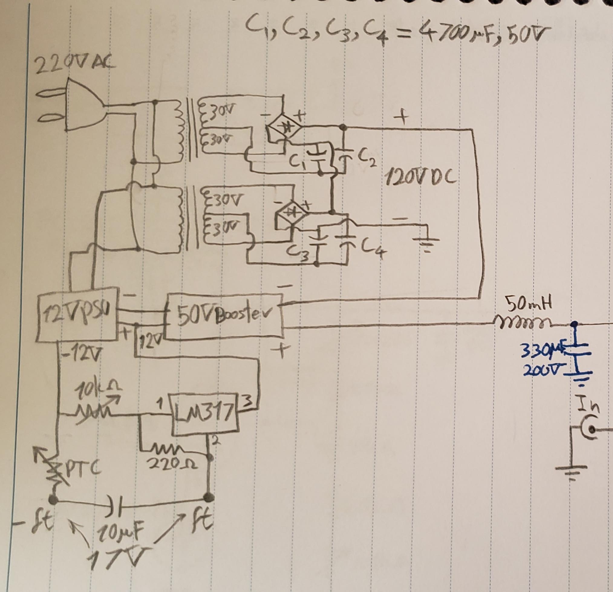

Help with 12AQ5 class A low gain and distortion

OK umm... I'm running the tests now and without any negative feedback, it's looking pretty clean :|
I really don't know what's going on.
Although, I suspect that it was because of my sound card. It has a bit of distortion after a certain volume and I think it was at 12% last time and now it's at 8% (which I discovered yesterday after those tests that it has almost 0% distortion at 8% volume).
AbaddonD, what circuit are you using? We went thru a number of iterations. Anyway … I wish you well. -= GoatGuy ✓ =-
The latest one with only one 6AQ5 in circuit.
I have attached 4 pictures below.
It seems a lot cleaner. I think the previous tests had a lot of distortion from the input. Now that it has clean signal coming in, it also has clean signal coming out. I forgot to take pictures of the distortion graph, but on the last one (500R) the THD seems oddly high at about 55% average but I think it's wrong or something. The D2 seems more reasonable though at a max of 3.03% at 30.0Hz and it's least D2 at 51.3Hz at 0.06%.
Also, I think that spike on the first graph is an error or something.
