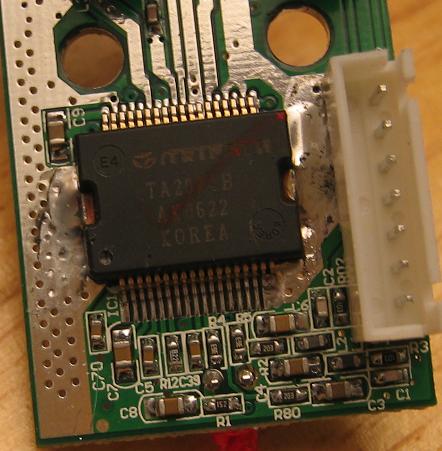

Well I've got my upgrade parts for the SI. But I'm suffering from a bit of confusion - the board pictured in audio1st's diagram seems to be of a different revision than mine. As (hopefully) you can see, c3 and c4 are both on the top side of my board.
On the top I've found R1 (1.5 Kohm) and R2 (20 Kohm) and R02 (10 Kohm). I saw a post way back down the thread about the R2 / R02 label scheme being confusing, so I'm assuming that R02 (as mentioned on the actual diagram) is the correct resistor. But I can't seem to spot R01. This is as of last night. Maybe fatigue was setting in. But as I look at these pics I took of the board, I still can't see R01.
Any of you jokers mod this particular board revision and remember where R01 is? Also, is R01 10 kohm as R02? Maybe I can find it with my DVM...

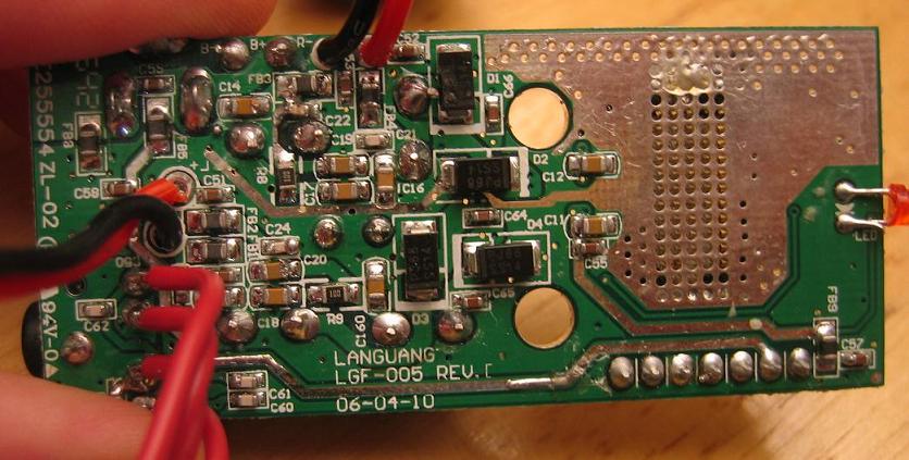

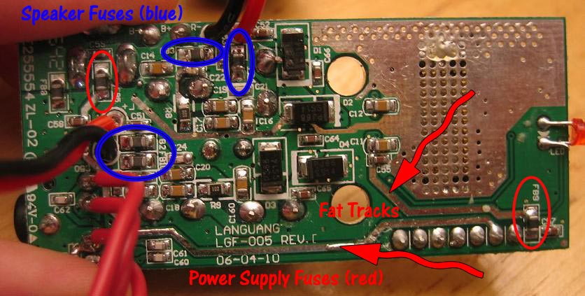

There seems to be a new version of the Sonic Impact shipping now. I think picklegreen was the first to point it out.
I have one on the way and will have a look. Seems like it's time to update all the info!
Can you hold off for a bit? Or there might be someone else here who has the ew version and can help.

R01 should be right by L1, which looks as if it's right next to L2. Could it be under the plastic cup for the volume control plug? I usually tear that thing right out.
Interesting to see that board. Looks like they have heavied up a lot of the power traces.

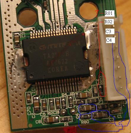

Here is a pic identifying (I think) R02, C3 and C4. I haven't been able to spot R01 yet. Note that R01 is not the same as R1. Hope you can make out the pic... 🙄
It has been suggested that R01 is under the big white plug. I have discovered that carving away the plastic of the plug while not carving away anything else is somewhat difficult (with the tools I have, anyway). Careful examination shows that the plug seems to sit pretty flush against the board, however, so I don't think anything is underneath it. But I guess you never know.
I am considering doing a "just the caps" mod rather than the initially planned "stealth" mod (as per panomaniac's site), since R01 is hiding from me. I'll have to go back and re-read the merits of the various mod styles to come to a final decision on that.

Are you sure that C4 on your picture is an input capacitor?
I tried to change that to one 2,2uF cap I've bought (I only tried with C4 alone, not both C4 and C3), and all I got was lots of noise in the speakers when i turned it on.
I'm 99% sure that it was the C4 on your picture i tried with. Or does both capacitors need to be the same value to make it work without a lot of noise?

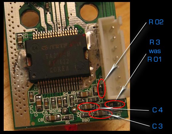

It looks to me as if C3 and C4 are still the same, R01 has become R3, R02 is still R02 and R1 is now R80. So for the Stealth mod, the only thing different seems to be R3 instead of R01..This is just my opinion from the photos as I don't have a new board..
