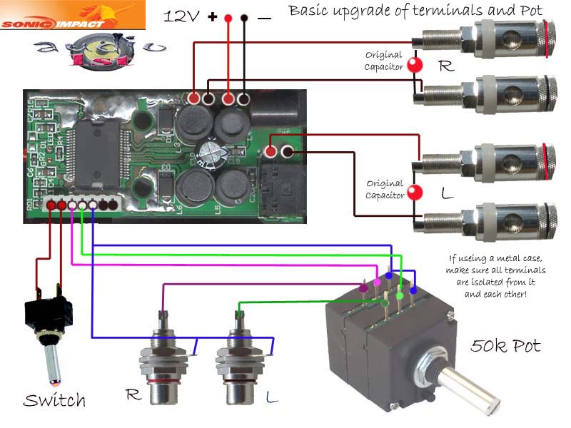

Can someone explain the wiring sequence for connecting the amp to an ALPHA 50 K (3 post) pot? This would be using the "5" available white wires off the stock connector. I don't have a double pot on hand and would like to use this one but can't figure out which wires are soldered to which post. I've tried the obvious websites, but all references I've found refer to the ALPS double pot (which I don't have and would surely cost me more than the amp to order!).
She powered up once with sound in the left speaker, nothing in the right. Rechecked all solders, figured I wired the pot wrong. Unsoldered the pot and tried numerous permutations, no sound only a low buzz in each speaker. LED lights up and no smoke. Did I kill it?

The schematic from Mike Mardis may help -
You need two potentiometers (ganged for stereo is good).
The ground goes on one end, the input on the other, and the ouput (to the amp) from the middle.
Go back to the original potentiometer and hook it up again. This way you can tell if the amp or your pot is is the culprit.
PCH

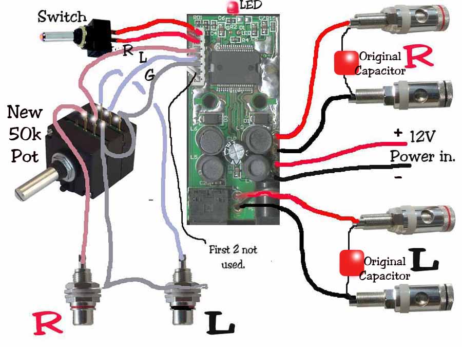

I can read the pinouts with no problem using the old pot PCB. It's the application of these 5 wires to a 3 post pot that has me confused. Are all the white wires going to the pots, then 1 extra wire each going from there back to each input RCA center pin (Li and Ri)? I understand left, right, and ground....it's the other 2 wires that I can't sort out.

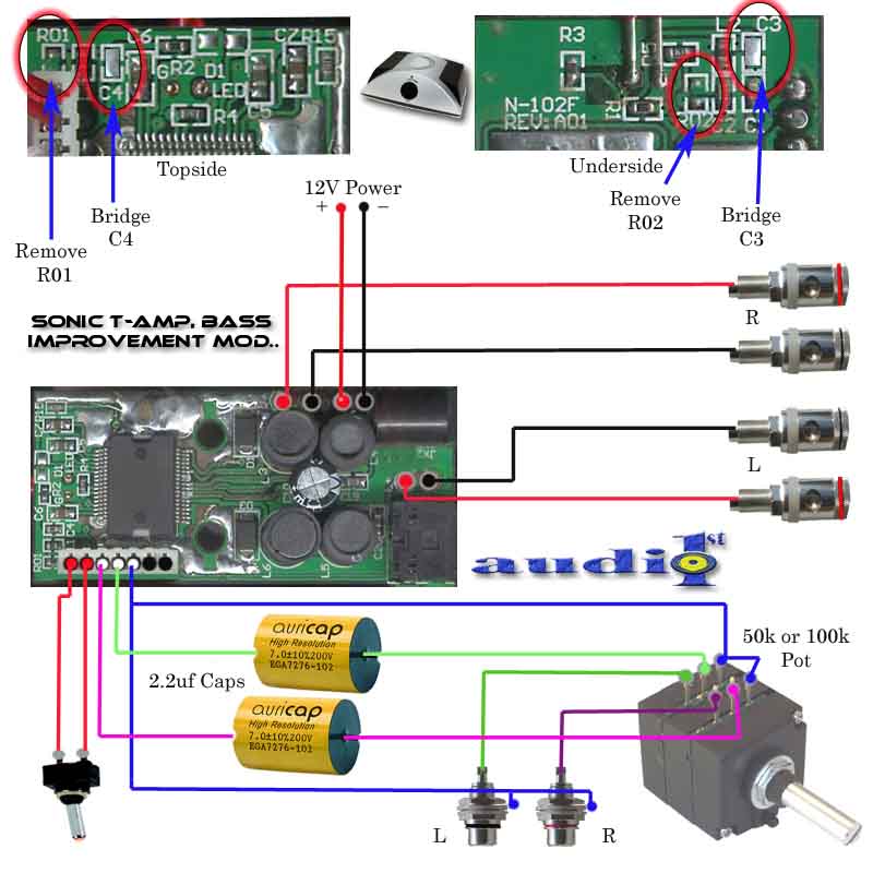

panomaniac said:audio1st, I like your diagram! Not the prettiest but it sure is clear.
Thanks for that. Sometimes photos just work better.
Thank you Panomaniac,....revised picture, prettier I hope ?

Audio1st, I bow in your presence! I unsoldered the + and - on my inputs from the PCB, ran them directly to a 100K dual pot (closest quick one I could get at lunch today), wiring as your diagram shows. She fired right up!! WOOHOO!! I had a little over 100 hours of continuous run time on this amp before surgery. I'm going to connect the amp to a pair of NOS Radio Shack 4-inch fullrangers in Z-hornets (or maybe even the 6-inch fullrangers in Voight pipes) and let 'em run for a few days. I am still using a 12V wallwart (for now). Thanks again Panomaniac, PCHuggs, and BWRX as well. I certainly owe you all a round, thanks.
