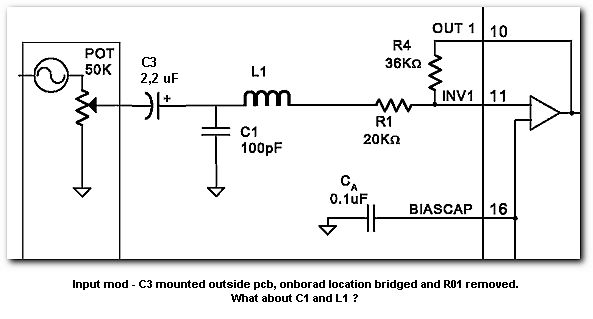

Very nice job audio1st.
Based on previously postet schematic I 'moved' C3 and removed R01 acording to your diagram (see posted image below).
According to other threads it is common to move the inputs to the bridged C3-C4 and bypass both C1 and L1.
Being the nob I am I'm curious as to how this filter now work with the C1 and L1 still in place?

Hello HansR,
I have read on other posts of the other mod improving bass but the mid band loses out. Keeping the C1, L1 filter in may prevent this side effect. Panomaniac says, quote(The 100pF cap and the inductor are meant to drain off some of the RF that may be present on the input.) A slight treble roll off may be noticable but if it wasn't a problem in the unmodded Sonic, it shouldn't be a factor here. (it may be a good thing)?
I just thought it was an easier soldering mod than the other, leaves more SMD's intact and may even sound better.???
I'm sure this mod was suggested by SX881663 ( Roger) some time back.??
It sounds OK to me, but I am not as expert as most of you.
Just trying to help..

This is where I got the information..sx881663 said:http://www.diyaudio.com/forums/showthread.php?postid=571880#post571880
In this post (#21 in this thread) there is a drawing of the input circuit. As can be seen if you jumper out c3, c4 you will be connecting r01, r02 directly to the input. This causes a DC offset and will shut the chip down. The solution is to remove these resistors and jumper out the caps at the same time. Then put the quality 2.2uf film caps from the volume control wipers to the input connector on the board. The easiest way to do this is to find the wires from the volume control PCB that connect to the main board and cut them in the middle, splicing in the caps there.
Roger

audio1st said:Here is a Sonic T Amp, Bass Mod' dia'
Nice job, Audio 1st!
Maybe you'll give me permission to use your diagram on my site? Full credit, of course.
I like this version, as it retains the input RF filters. Good for those big caps that might pick up RF noise.

Thanks for your comments and you are welcome to use any of my pic's..
Panomaniac, after reading one of your replies on another thread, I did the filter bypass version on the 5066 mod thread..
I was concerned that the 100pf cap after the input cap would show a resistance of 80k at high frequency and raise the output voltage to the speakers, or is it not enough to worry about?
Barry...
Lostcause said:Hi Michael, is this exactly your 'Stealth' version?
Exactly the same. I just called it "stealth" because we were sneaking in ahead of the filter. Might as well use the filter if it's there. I won't affect the audio, but should clean up some noise.
I don't think the little 100pF cap will hurt the output. It certainly doesn't effect DC offset. As you know, R01/R02 must be removed, they will cause massive DC offset if used in this version.
I'll try to do a little more research on the effect of the 100pF cap. If anyone else does, please let us know. Maybe someone can spice model it.
