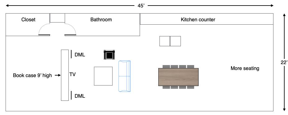

I wonder if a Sonotube cylinder would advantages over an H-frame? Would they have less standing waves? Just wondering.
I have four Eminece OB-A15neo: 15” Neodymium Woofers (from an old PureAudioProject build I did some years ago) sitting in boxes.
I've thought to stick 2 of them in 2 sections of Sonotube (and mate them with DMLs).
16" x 4' Sonotube costs about $20.00. I think the drivers would fit nicely.
That said should I look at larger diameter Sonotubes?
Given less volume in a Sonotube tunnel vs a standard H-frame of the same length, would I need a longer tunnel vs an H-frame?
I have a large room (a loft in an old industrial building), roughly 16' wide X 60' long X 12' high. See attached rough floor plan.
My DMLs hang from a large bookcase/room divider and would hang above the subs.
Any suggestions on what length of Sonotubes to use?

Last night, I found myself looking at the large freestanding bookcase | room divider in front of which I have my DMLs.
The bookcase, 18" deep, opens to both sides.
It seems like I could pretty easily build in the sub woofers (I'd do a pair) - embedded H-frames.
I'd likely need to give some thought to massing up the frame or isolating it from the bookcase.
Thoughts?
Sequestering the rear wave in a large hollow hard tube is not good. The interior walls forming my 17-foot labyrinth were made from a kind of compressed shredded cellulose fiber used for "acoustic" ceiling tiles. And then, like all TLs, filled with lots of stuffing. That de-tuned the labyrinth without too greatly blocking it.
