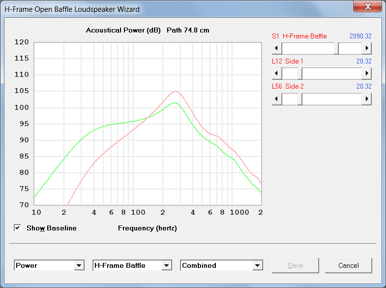

H-frame and U-frame open baffle loudspeakers are acoustic dipole systems, meaning that bass performance will be significantly compromised no matter what. I would be very surprised if it was possible to achieve a flat frequency response between 40 Hz and 100 Hz, and even more so in the case of your proposed compact system.
Be careful when comparing Hornresp results to those produced by other simulation software, as sometimes only the response from one side of the diaphragm is given, which can be very misleading indeed. To illustrate, the green trace in the attachment shows the output from one side of your H-frame system design. The red trace shows the total system output.
Furthermore, measurements are often done with the microphone close to one output only, which can also lead to an inaccurate assessment of overall bass performance.
Perhaps it is time to download a copy of Hornresp, and try experimenting for yourself? By far the best way to learn, is by doing... 🙂.

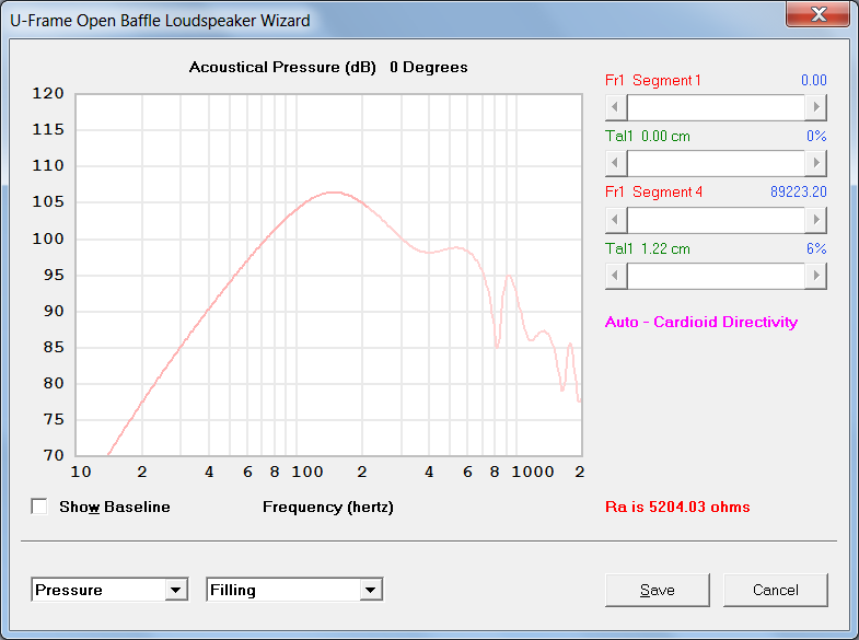

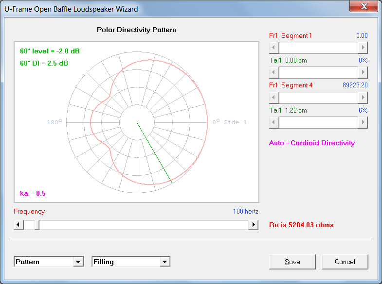

Hornresp takes into account the solid angle into which the H-Frame or U-Frame system radiates. The simulation model is valid at those frequencies where the dimensions of the system and the distance from the wall or walls are small compared to the wavelength, and where the system radiates symmetrically into the solid angle.
To illustrate, Attachment 1 shows the on-axis pressure response of a resistive U-Frame system optimised for cardioid directivity, radiating into quarter space (pi steradians solid angle). Attachment 2 shows the polar directivity pattern for the same system under the same radiation conditions, at a frequency of 100 hertz.
