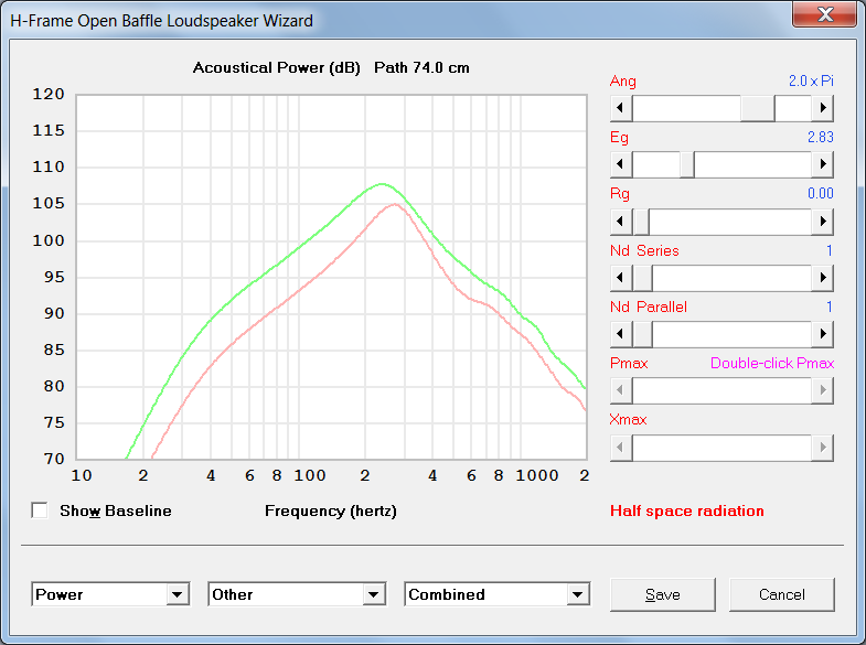

In that case, assuming that the H-Frame or U-Frame baffle is still sitting on the floor, I would probably just play it safe, take a conservative approach, and specify Ang = 2.0 x Pi rather than Ang =1.0 x Pi for the simulation. The actual performance would hopefully lie somewhere between the predicted results for the two settings, but I don't really know. As I have said before, I have no practical experience in such matters.
In the attachments, the green trace is the quarter space response and the red trace is the half space response. I would expect the actual performance to be somewhere between the two, probably biassed somewhat towards the green trace.
All together, that means you have to have your DSP ready to EQ the tone once you carry your new OBs into your music room (north of 100 Hz only) and not to believe everything will be fine when you start the music because you think your engineering was so totally well thought out.
Exactly, and of course that really applies to any loudspeaker installed in an enclosed space, not just to H-Frame or U-Frame types. Most speakers are normally simulated as point sources radiating into a given solid angle and most commercial products are usually tested in anechoic chambers, so actual performance will obviously be affected any time that those ideal conditions are not met.

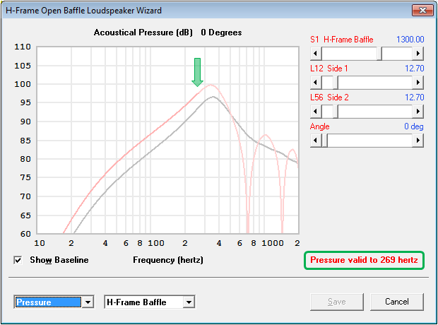

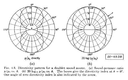

Adding a bit to what DMcBean and Bentoronto have been discussing:
At low frequencies where the piston/baffle sizes are small compared to the wavelength, H-frame/U-frame/flat-baffle woofers can be modeled as a set of two point sources. The separation distance between the sources is defined by the acoustic center theory mentioned in Post#17. A few figures from the AES papers, shown in Attachment #1, illustrate that at low frequencies the point sources should not be positioned at the driver cone or H-frame opening but rather a distance in front. The distance to the acoustic center is mainly defined by the size of the baffle, but is also affected by the size of the driver, and the depth of the cabinet. Accurate definition of the separation distance is important since the acoustic output at LF is directly dependent on it. The predicted response is accurate as long as the sources continue to behave as point sources. In general, acoustic theory sets the threshold as ka=1, or when the wavelength of sound is similar in size to the circumference of the radiator or baffle. Hornresp identifies this threshold for the user both numerically, and by bold/light transition in the response curves.(see Attachment #2)
At its core, Hornresp is a power response modeling tool. For both dipoles and monopoles, it calculates the total acoustic power radiated(not just on-axis) into the radiation space the user selects; sphere/hemi-sphere, etc. This being the case, the LF power response curves give you a good representation of what the average room response will be so you can use them to predict/compare LF energy levels. This is the key benefit of the Hornresp model; that you can accurately compare the LF power radiated into the room by a dipole with that from the more familiar monopole subwoofer. Both the monopole(single point source) and dipole(two point sources) will energize the room with their net radiated acoustic energy and you will see peaks and dips from room modes superimposed on the power response curve based on woofer and listener locations and proximity to each other. Some years ago there was an interchange between geddlee and John K. on the topic. They started out with quite different ideas on how monopole/dipole/cardiod woofers interacted with a room, but eventually they reconciled on most points. Here is a link I had saved to a key post at the latter end of the thread. Cardioid Bass

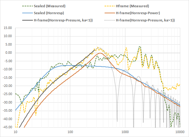

With that background, here are a few more details on the H-frame model and some comparisons with measurements from last year.
Two pieces of information are needed for the two-point source model of an H-frame woofer:
- the frequency response of each of source
- the separation distance between them
The magnitude/phase response of each source is defined by the woofer parameters, the size/shape of any tunnels in front/behind the woofers, and the radiation impedance loading the tunnels and/or woofer. For symmetric H-frames, the two sources will have response with equal magnitude but 180deg difference in phase. If the H-frame is asymmetric, or damping is added to one of the tunnels the source responses will be different. Note that both the radiation impedance and the acoustic center locations are a function of the radiation space.
Here are some example measurements of an SLS-12 woofer mounted in a symmetric H-frame baffle.
Attachment #1: A comparison of the near field response for one side of the H-frame was used to evaluate the Hornresp radiation impedance model for 3 commonly used radiation spaces. 4-Pi measurement was with H-frame on a pole stand in middle of garage. 2-Pi was with H-frame on the floor. 1-Pi was with H-frame on floor up against one wall. Hornresp can accurately calculate the near field response of the dipole sources for all 3 placements in the room.
Attachment #2: For evaluating the accuracy of the acoustic center locations, measurements were taken of the same SLS-12 woofer in a sealed enclosure and H-frame at a distance of 2m outdoors in the driveway. Although wind was causing more LF noise than I would have liked, you can clearly see that the level of the LF pressure response calculated by Hornresp for the H-frame lines up well with the measurements relative to the sealed enclosure response. This indicates that the calculated acoustic center locations are correct. It also looks like ka=1 is a reasonable cut-off point for where the sources stop behaving like point sources and directivity due to source size ramps up.
Attachment #3: Note that the power response for the H-frame in Attachment #2 is roughly 4.8dB below the measured on-axis pressure response. This is because of the DI (Directivity Index) inherent in dipole sources. In other words, a dipole source will measure 4.8dB louder on-axis than a monopole source of the same strength. Or conversely, for the same on-axis SPL level, a dipole source radiates less total acoustic energy into the room than a monopole.

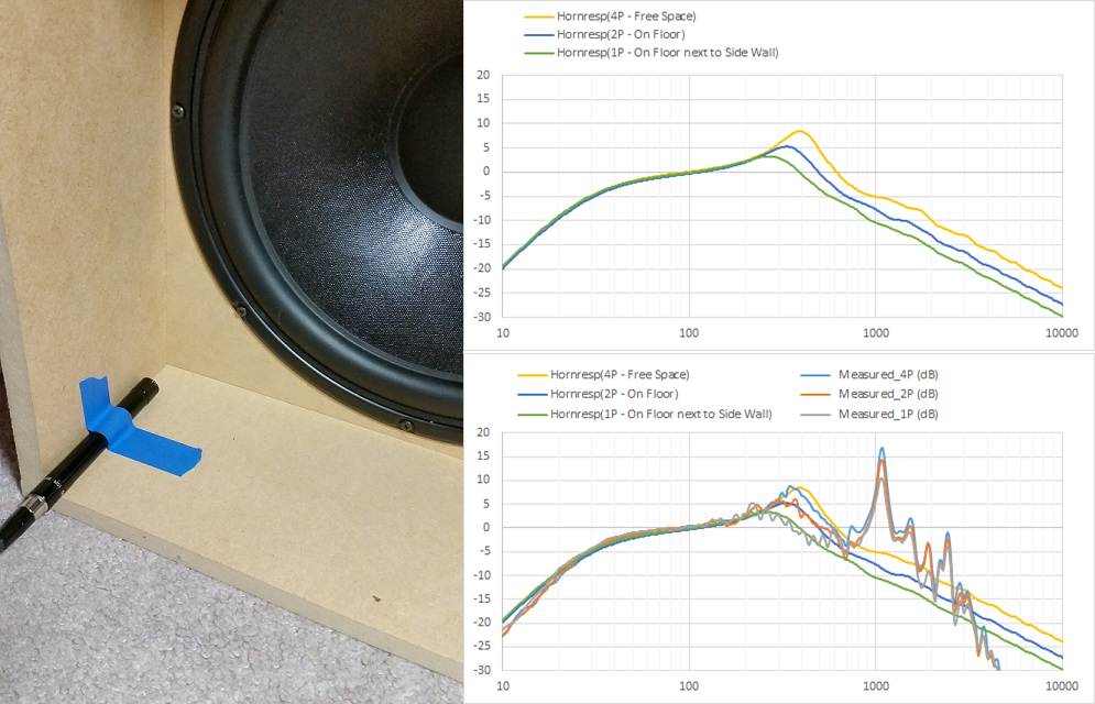

I wonder if you, bolserst, or David, can comment on the method I have been using for generating the free-field response of a dipole (e.g. H-frame). I first build it and then install the driver. I then take nearfield measurements at the front and rear, in the plane of the mouth of the H-frame tunnel. Next I import these responses as FRD files into a program for crossover modeling. For the rear response, I make sure that the phase is inverted (this may or may not be captured in the measurement depending on what type of phase response was saved). Then I delay the rear by some amount of time that represent how long it takes for sound to travel the front-to-rear pathlength difference. Finally I reduce the gain of the rear sound by the ratio of the distances of each source (the front and rear mouth openings) to the listening position for which I am generating the free field response. Finally, I add the two responses (these are complex quantities) and get the sum (magnitude, which is converted to SPL). I take this as the free field response at the position that I am simulating.
I like this approach because the measurements capture the tunnel resonances, which I don't like to model. It also correctly captures the driver's response when mounted in the H-frame, where it will experience some extra loading from the air mass in the tunnel. This can influence the F and Q of its response compared to e.g. free air.
This requires me to build the enclosure and take measurements and cannot be used to do a priori modeling. But it is enough for me to get data that I can then use as part of the system crossover design and I do not need to go outdoors to make the measurements so I can do it anytime.
Any thoughts on that approach?

I use this approach for H-frame subwoofers only. Therefore I do not need to have an accurate picture of the FR above, say, 200Hz. This nearfield-only method is not accurate for higher frequencies, of course.
Because I am generating the "free-field" (4Pi) response I usually have to adjust the level down by 3dB or so to match the rest of the system. I do that by ear, along with other minor tweaks to the crossover, after I have developed and implemented it, as a final "tuning". Also, one may want an elevated bass response (or not) and so I feel this can be left as an adjustable parameter to some extent. Yes, I use DSP and its a fully active system, so I can do this ad nauseum (but hope not to!).
As long as you are crossing over below ka=1 where the two sides of the H-frame are still behaving like point sources, your method will give you results that should match what you measure outside quite closely. Even the path difference you use will have only minor effect on the response shape below ka=1…only changing the level. As you approach ka=1, path difference selection will start having more and more effect on the response.
If it is important to have more accurate response above ka=1 where directivity of the H-frame sources is coming into play, you might consider using an approach similar to what JohnK recommended many years ago. Basically do the combined NF approach like you are currently doing, but supplement it with far-field measurement of the H-frame using a measurement window long enough that you can splice it in at ka=1. I would think an indoor ground plane measurement with mike 1-2m away should give you what you need. Later this weekend, I will have access to the data used for the outdoor example I posted and can use it to compare this splice approach with the "full-up" outdoor measurement.
Right, I am basically following Kreskovsky's method, but do not do the far field measurement for higher frequencies because they are out of band and I don't need that information. He described the method here:

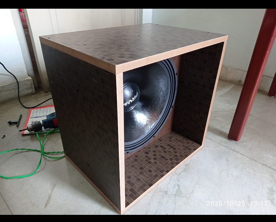

I made the h frame (please see the attached image)
But I have to wait for a few days before I test it.
I'm occupied with some other activities.
Hopefully I will update listening impressions soon.
Once again thanks a lot guys
