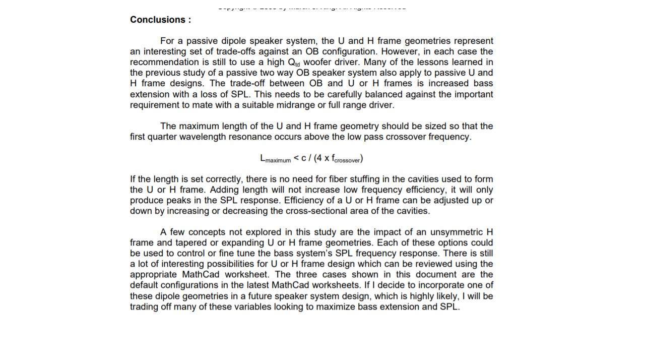

Hi All,
I am going through H frame subwoofer design by Martin J. King. (PDF attached)
Please see the attached images also.
What does he mean by L(effective) & R(effective) ??
Can anyone help me understand please??
All I need to know is an ideal H frame dimensions for height, width, and depth(front depth and rear depth) for a 15" driver. Lets say Crossover is at 100 hz.

He wants the length to be shorter than c/4(100Hz). If "c" means 1125 fps, then the tunnel length should be shorter than 33.75". This keeps any tunnel 1/4 wave resonance far and away from your 100 Hz crossover frequency, while adding distance between the front and back wave of the driver. This distance is an improvement over simply putting the 15" driver on a reasonably wide baffle board, by rearranging the geometry form - without getting into trouble from resonant peaks.

The "r" stands for radius, hence it's "effective" because the cavity is rectangular. I'm not sure whether this calculator may be useful Cavity Resonance

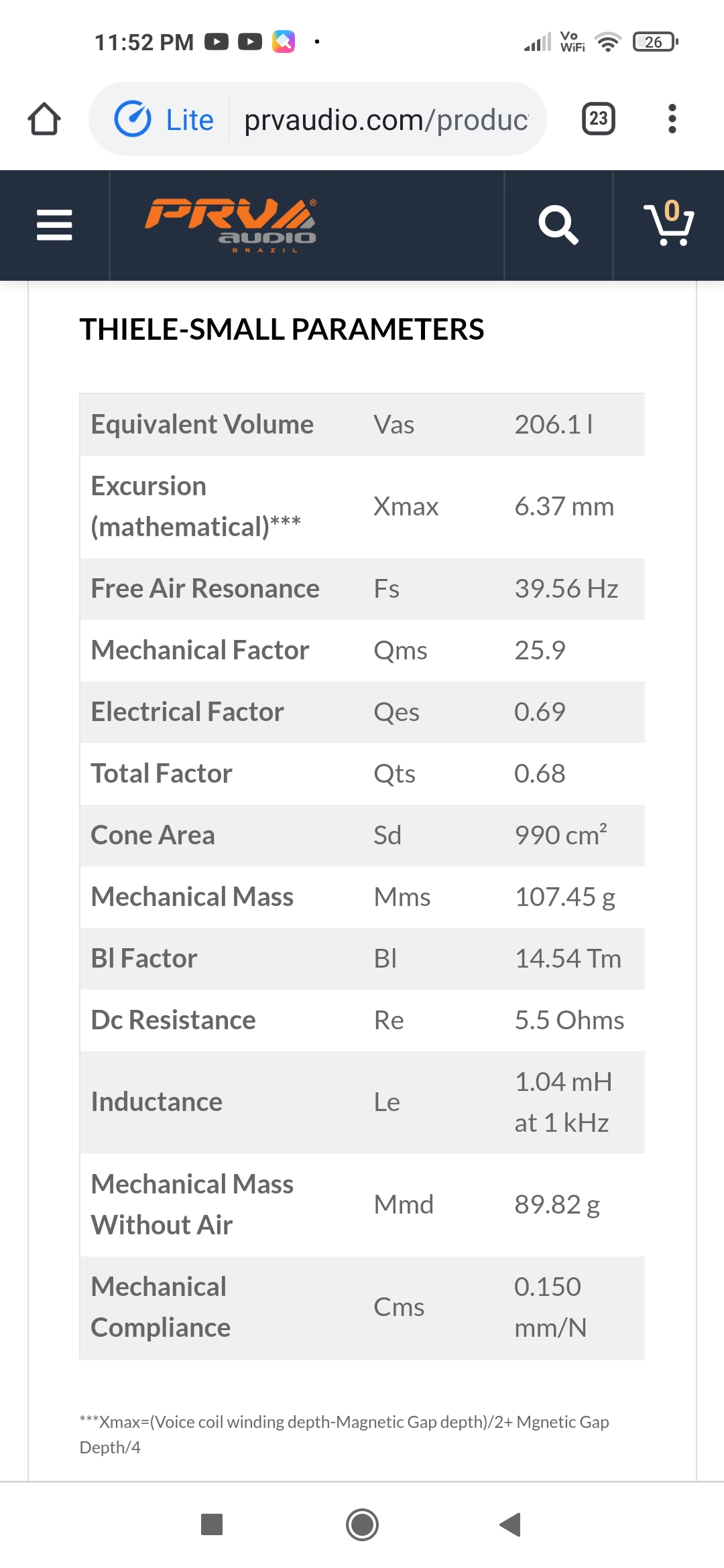

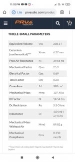

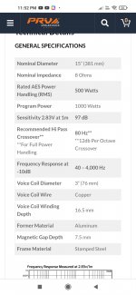

I will be using PRV 15W1000V2. (Ts parameters attached)
H frame size I prefer as compact as possible.
Something like 18" wide and 18" high, and front cavity depth 8" and rear cavity depth 8" ( if these dimensions are possible)
Crossover point anything that works between 80hz to 150hz with that h frame size.
Room size is small 11ft x 16ft.
Amp power is not a problem.

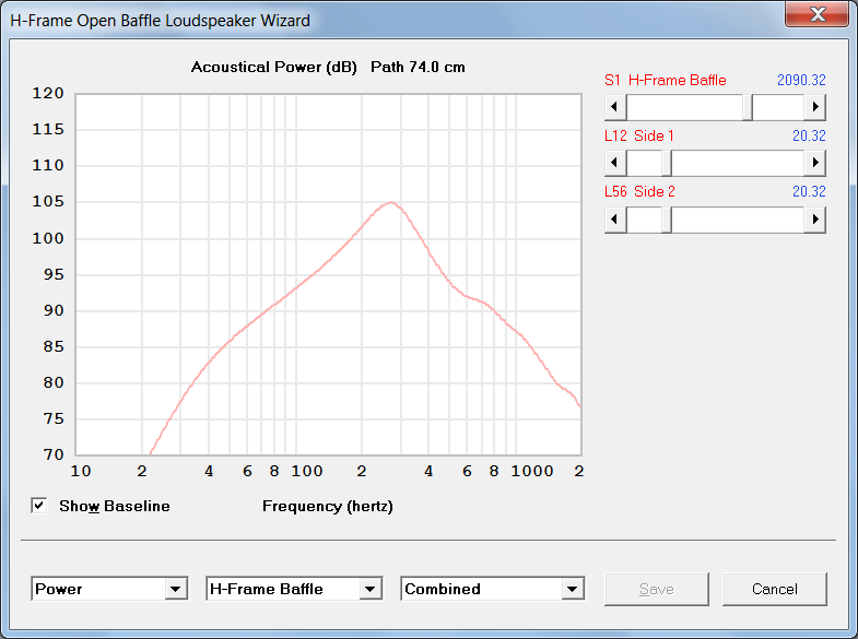

Thank you so much for the simulation.
So for a 18" x18" h frame with 8" deep front cavity, and 8" deep rear cavity...
This graph shows there will be just a peak between 200hz and 300hz ???

Remember, the frame or tunnel is supposed to operate well below your crossover, so the sim is saying that peak is 2-3X higher than your cross at 100. Martin wanted 4X.
You can go a bit longer in the tunnel or lower in the cross, just stay away from the peak ;')
Correct, using the H-frame dimensions and driver parameter values you provided.

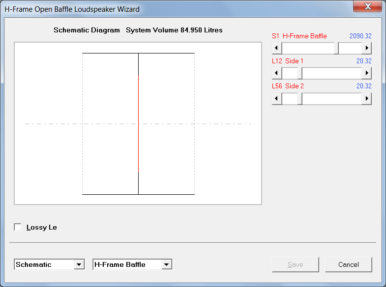

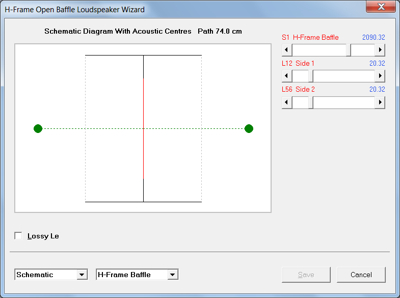

Big thanks to you David for developing Hornresp with sliders for H-frame OB dimension designing.
Can I ask how Hornresp models resonance in an H-frame? Are there two sources?
1. quarter wave of the depth?
2. half wave of the opening dimensions eg width?
Hi kazap,
Hornresp analyses the H-frame open baffle system as a compound horn, with horn 1 and horn 2 being cylindrical segments having identical cross-sectional areas. The lengths of each segment can be different, if so desired. Resonances are automatically taken into account by the horn simulation model. The acoustical impedance loading each side of the diaphragm is determined, and the two acoustical power outputs are then calculated. For the purposes of combining the outputs, Hornresp calculates the positions of the two acoustic centres (shown in green in the attachment) using the method described by John Vanderkooy in AES Convention Papers 6912, 7102 and 7992.
Kind regards,
David
Kind regards,
David

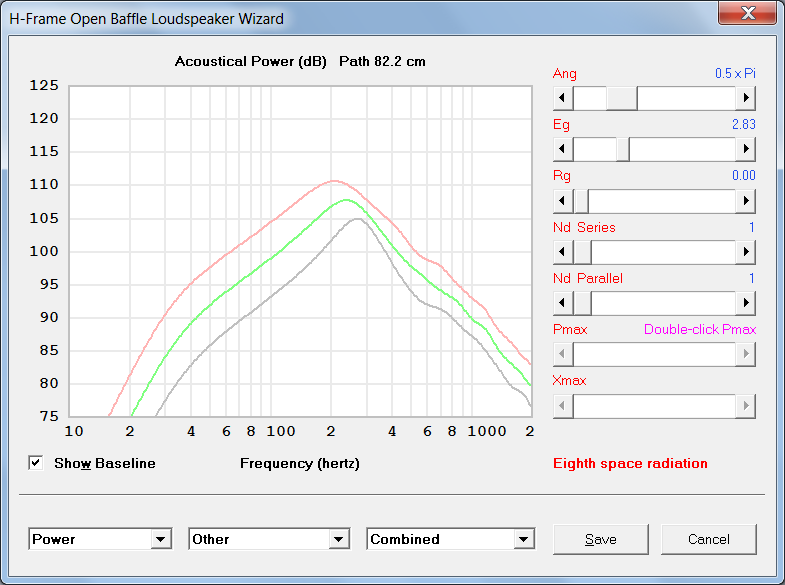

You can put an H-frame against the side walls, it will give more output and in a small room make little to no difference to the sound.
Grey trace - located in centre of floor
Green trace - located on floor against wall
Red trace - located in corner

...But there is always a peak. ...
The way to read this chart is to examine only the vertical change at a given frequency (attention: scottjoplin).
At 40 Hz, the benefit of moving from worst to best is 13 dB. But at 600 Hz, it is like 6 dB.
So it does change the character of the sound based on the physics of air mass the driver faces and in a whole bunch of other ways too.
Which is why a separate sub makes sense in a lot of ways. A corner brings up the bass although other locations may have better all-around sound. Measure.
