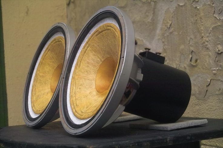

Good morning digitalthor
A recap is probably a Good thing at this point
You went from a small hifi system to a bigger PA system - but want to keep the same "type" of midrange sound?
The system that i used till recently i bought in a store and i was actually starting to get annoyed with it.
To much vocal sound and a subwoofer that was impossible to callibrate.
My reference sound is a SVS speaker called prime tower. It's the best sounding complete speaker that i heard.
I would like an adjustable sound and of course alot more weight power and warmer sound.
Also a Little more detail
I dont know if i would call this a PA system
You want to go fully active - but do you have all the hardware ?
Yes i have all the hardware, exept for the analyzing tools.
And midrange driver
You still need measuring equipment ?
Have you tried to measure and analyze the data before ?
I suppose i do, i am trying to learn about it now
Cant remember - how big is your room - 30 sqm ?
Yes 30sqm
I'm simply trying to pick up on the basics here. I know it's super exciting to look for the best driver and talk specs. But I have been through that journey too, looking for the greatest driver. And did not really understood what to look for, cause I needed some very basic understanding of what different drivers do and how they interact and produce a complete sound image.
Maybe - just maybe. What you liked about the small Dali speaker. was the elevated tweeter, cause it's around 5dB higher than the midrange - on axis. To get them linear... you need to toe them in around 25 degrees. 5 dB level change between the tweeter and the midrange.... that is a huge difference in my view... worth looking into.
I learned so much from this discussion already.
And i think using an active system allowed me to learn even more just by trying different settings.
I definitely missed out some basics.
I do like and elevated Tweeter but i am very sensitive to shouty sound
Very Good points, the Dali speakers sound pretty good when i i plug them in to the Active system but not so much before that. Too much midrange i believe
