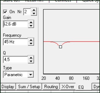

You got some nice juicy standing wave there at 40Hz. I have one at 45.
Its good but you should put on a good bass kick song and make a cut (if it sounds swollen). Boom but not swollen
This is a good song to take control over the standing waves
Rammstein - Los (Official Audio) - YouTube
The bass standing wave yes, it's the infinite baffle crossed 45hz
It is one eminence kilomax 18.
It does a pretty good job but won't go that low so i suppose the kick is because of its rolloff
now this is not a good measurements because i have turn the left channels off and the infinite baffle was still on.

Really hard to get rid of the standing wave
i have crossed my infinite baffle subwoofer on 45 Hz
I have a separate filter with No EQ
Should not be a problem but it is
The eminence kilomax18 won't go so deep so it need some gain to compensate.
I think the se ib18ht Will be alot better don't you?
