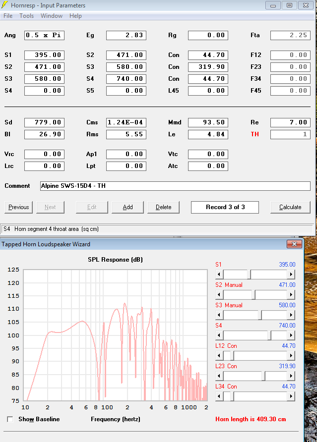

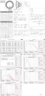

Here's what I came up with (please double check the TS parameters - especially Bl since the data sheet didn't list all of them, had to use hornresp to calculate the missing parameters).
This is for a single driver with voice coils in series (not sure if the supplied Le is for series or parallel connection). The enclosure size is 217 liters and should hit the low notes. and is single fold friendly 🙂 Perfect for a prototype. Assuming I got all teh driver parameters right, you should be able to tweak the length and cross sectional areas a bit to suit your size & response requirements
PS. Don't be alarmed by the droop towards the low end. Room gain should fill it in.

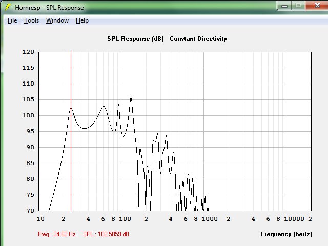

I done some more diddling with a T-TQWT, this time starting with Eazy Horn's suggestion. I can do as well or better with a "reasonable" (maybe single fold) TH sim. My best performer can do (supposedly) 95 db or better 15-137 Hz (not flat, but peaky > 48 Hz. However, this is with a L23 = 698 cm, that would be some folding. I can't recall reading anyone claim a T-TQWT did better than a TH, in fact quite the opposite. My "testing" would seem to confirm that. Now, whether my TH will do any better than your basic sealed box, remains to be simulated 🙂
I have posted my current hornresp.dat here, if anyone would like to download it and see the latest sims. I guess the next build should have a name. I have been calling it the Ijit Mark II or just Ijit II, what do you think?

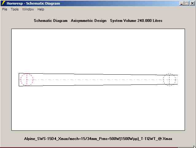

Hi Soldermizer,
Post #79: "Tell me more..."

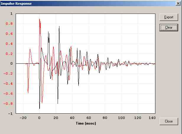

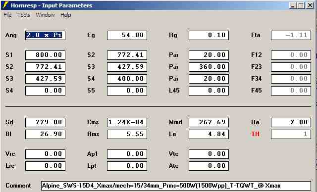

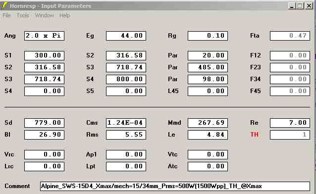

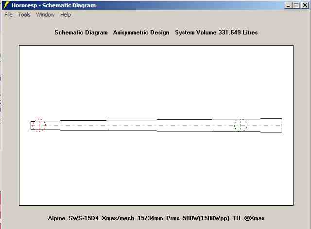

I'm having some problems w/ the latest update of Hornresp right now, so I don't want to spend a lot of time w/ damping, and the Filter Wizard, but, for starters, here are two older examples of the enclosure forms in question:
