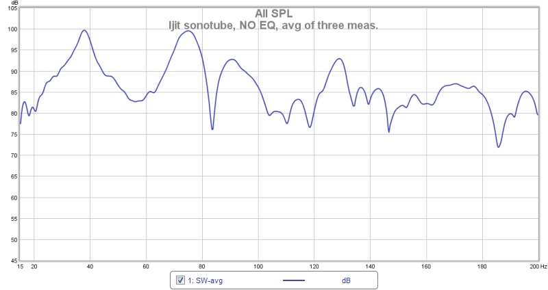

Yes, that sounds about right. I've updated my hornresp.dat file if you want to download it. The current Frankenclosure is #024 (has the 7.5 cm port). It does chuff some. While I understand the concept of keeping velocity below a certain speed, I have yet to find out how to sim this in hornresp. I do see that making the port diameter bigger/longer I can tune for a similar response, but again, how do I know when it's big enough? Can someone point me to a page showing how multiple ports would work? I have lots of 4" PVC and a lot of small holes might be easier than one big one.

Multiple 4" PVC ports will work well, just simulate w/ a single port to get the needed total area, and divide it by the area of the 4" pipe that'll give you the number of ports you need. The length(s) stays the same. Dual 4" ports is just about a minimum for a single 15" driver, so as a starting point you might want to try 4ea. 4" ducts. Calculate the port length in Hornresp (or, e.g.: WinISD...). I often helps to make the ports a little too long that way you can cut them off a little. I like to use an internal flange, e.g.: the circle cutout from an 8" woofer hole (or some piece of scrap), and I round the port edges inside and out w/ at least 3/4".

I finally have discovered Hornresp's secret (how to get the particulate velocity at a port) and ... for the Frankenclosure a 12" diameter port approx 1 meter long will tune it fairly flat. So rather than butcher my 10 1/2 Sonotube I bought a 48" unit at Lowe's and forthwith took jigsaw, enlarged to prior 4" hole to about 12", glued on the new tube and it works ... a few leaks but WTF? It's a perpetration in progress... 🙂
