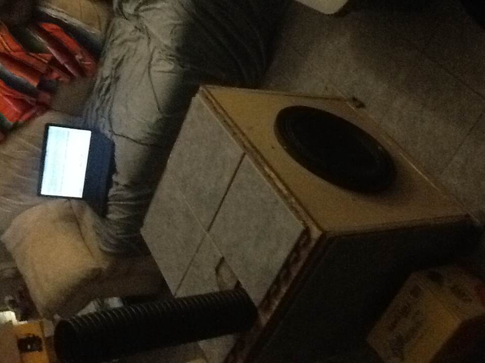

I'm having too much fun with my Frankenclosure right now. Today I made it "ported". 15 minutes to cut a 4" hole and glue on a 50 cm length of 4" pipe I had on hand. At least I arrived at this from hornresp sims -- claims I can get 14 Hz tuning. Sounds ok so far, no "chuffing" but as I understand it, a LLT only begins to work really low, and not much music down there. Meanwhile, my NU6000 went on strike so off to repair shop it goes (conveniently, one downtown Tampa).

Current Frankenclosure
Oops, I don't have the sketchy ad yet. Here's Frankie as he appears tonight.

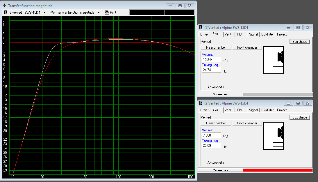

Those 2 drivers really want to be in a circa 10 cuft enclosure. You have something around 7.5 cuft (i"m guessing). Either way, a port tuning of about 25 Hz seems about right.

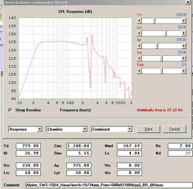

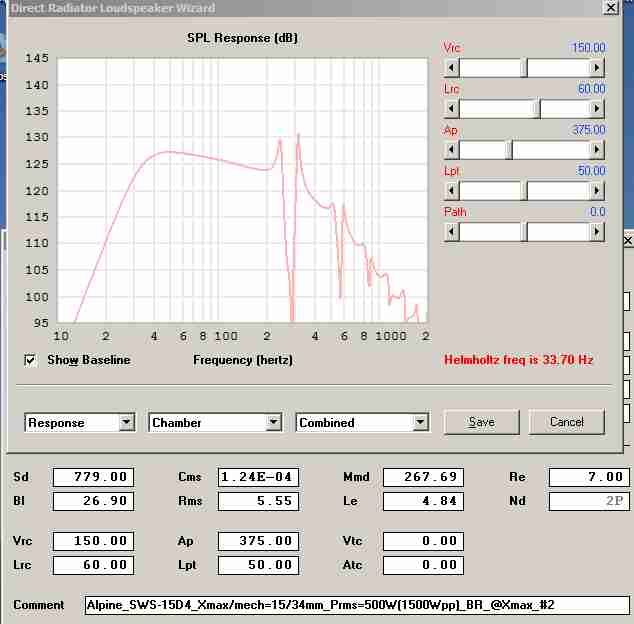

Hi zobsky,
That's pretty much where I was (I just added the squeezed box simulation, same port):
