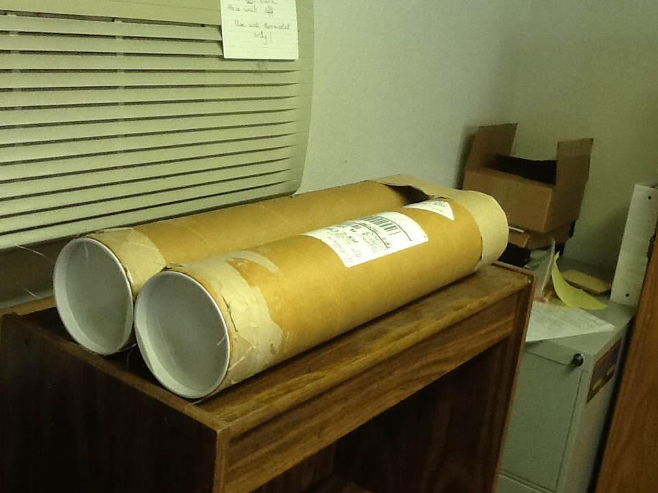

Help the Ijit..simulate and plan his 2nd (working) TH.
First, here is the photo of the mailing tube that I briefly considered making a transmission line from. (Some of you guys are even sicker than me! Go ahead...I expect replies on this thread like: "well you can put two Dayton 5" subs in each and you should get a low corner of 50 Hz..." Don't disappoint me.)
Secondly, the "gotta build something!" feven has broken -- temporarily. During this period of sanity, perhaps brief, I would like to do the following:
1. Read and plan about tapped horns. Simulate known "good" designs, as well as make my own abominations.
2. Plan to build a real one, either of my own design or more likely a good one.
Right now, hornresp is my only sim tool. Does anyone know of a collection of "good" designs in hornresp format? While it's not difficult, it is some work to have to type in all the numbers from the screen shots.
Also, I am trying to apply myself just a littlle more to my studies. The semester is half over and important deadlines are coming up real soon, just like a spoonful of Ipecac syrup 🙂
