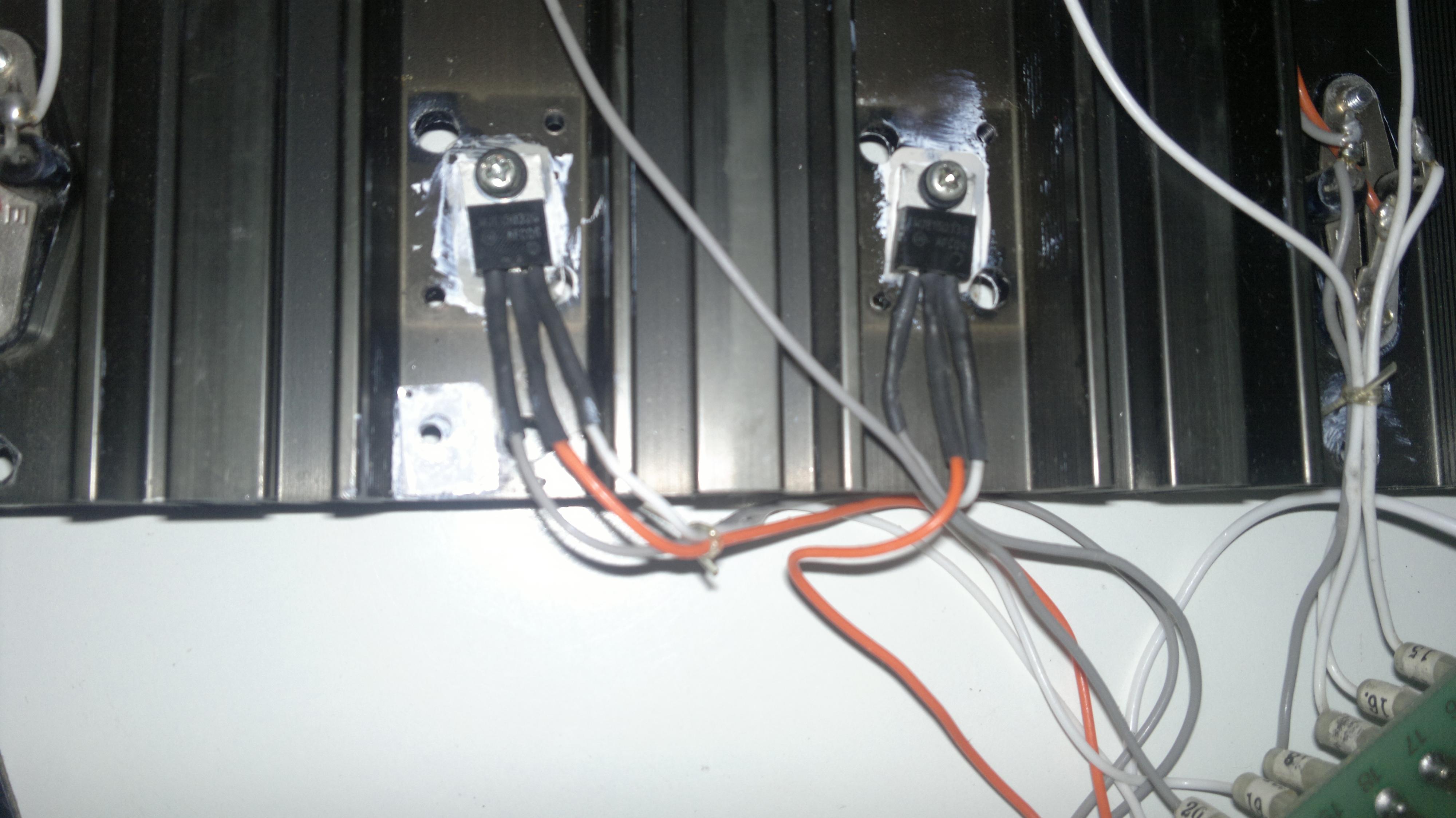

Harder than expected and I had to ruin my precedent work, by the way cables seem fine

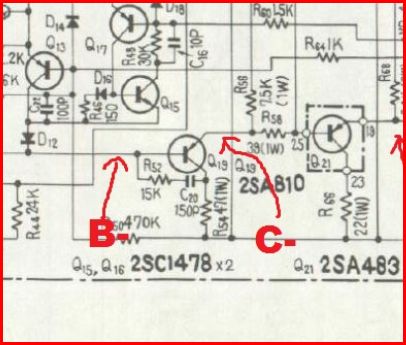

Thats great. A to A- is reasonable. Things really go amiss with the B and C readings. With plus 26 volts across B and B- you should really see that reflected across to C and C- and its not. It could be either an open or a leaky transistor so we need to try and pin it down.
Let me try and explain that a bit better. Voltage B and B- is obtained from A and A- so on the face of it it appears there is a problem with or around Q18 and Q19
So we need a more few quick tests around these transistors. This time connect your black meter lead to ground and leave it connected there.
Measure on B and C, and B- and C-
So thats four readings, all with the black lead on ground.
Administrator
Joined 2007
The stand out result there is B- to C- Thats showing around 67 volts between those two points. Do you agree ? Look at the circuit and those points are actually measuring across the base and emitter junction of Q19. That transistor is definitely faulty to give that result. Whether there are more problems remains to be seen.
Pleased to see you are using the bulb too.

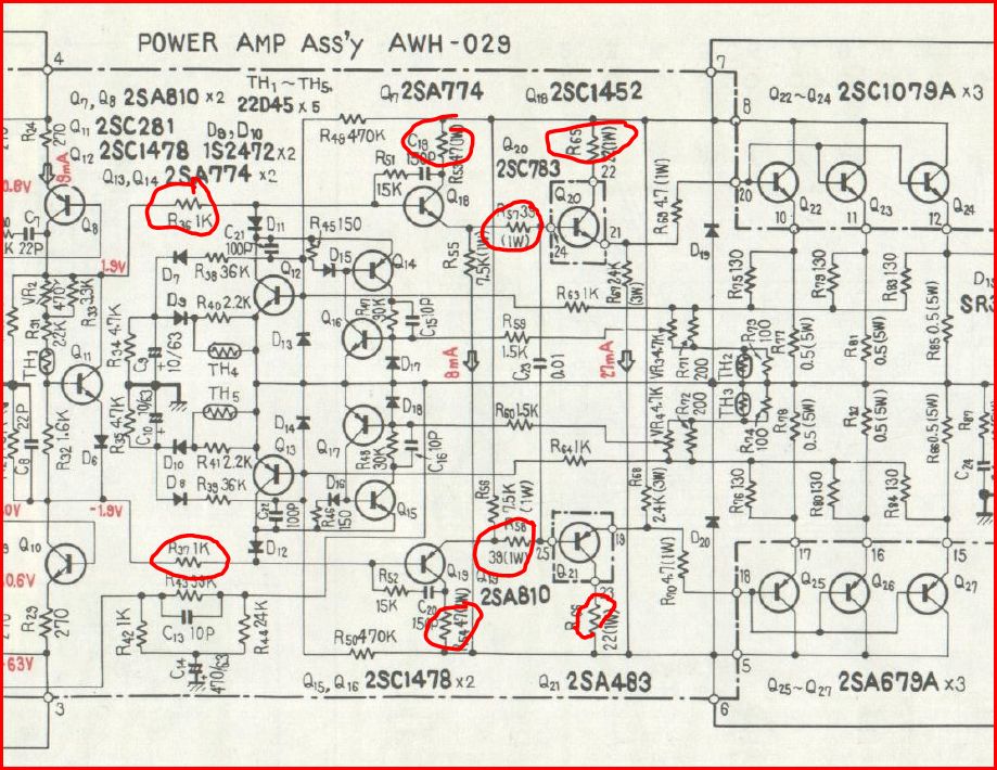

Well they were the best we could come up with at the time if you remember but they should OK for those locations (Q18 MJE340, npn).
It is a dificult fault to diagnose without having the unit to actually work on... far more difficult than rebuilding it all as we did before. That transistor is faulty though given those readings. I would recommend you check (with it off) these resistors too.
What did we fit for Q20 and Q21 ? Was that MJE340/350 as well ? Or did we leave the originals ?
Replacing that transistor has to be the next step though.

I'm tempted to say replace both MJE340 and the MJE350. Leave Q20 and Q21 as they are.
If you altered the bias (I think you said you did) then set it back on the minimum setting for testing. You should be OK with the bulb though.
Lets see what replacing those transistors does. When its all working again we could look at some alternatives but for now lets just concentrate on getting it back to where it was before.
Administrator
Joined 2007
R66 looks faulty. Its a low value resistor and should read OK in circuit. If you've a good connection with the meter leads to the resistor and it still reads faulty then take it out and check. If it is faulty then we need to look at replacing the four transistors. Also if the resistor is faulty then does Q21 read short circuit between collector (the pin the resistor goes to) and either of the other two pins.
