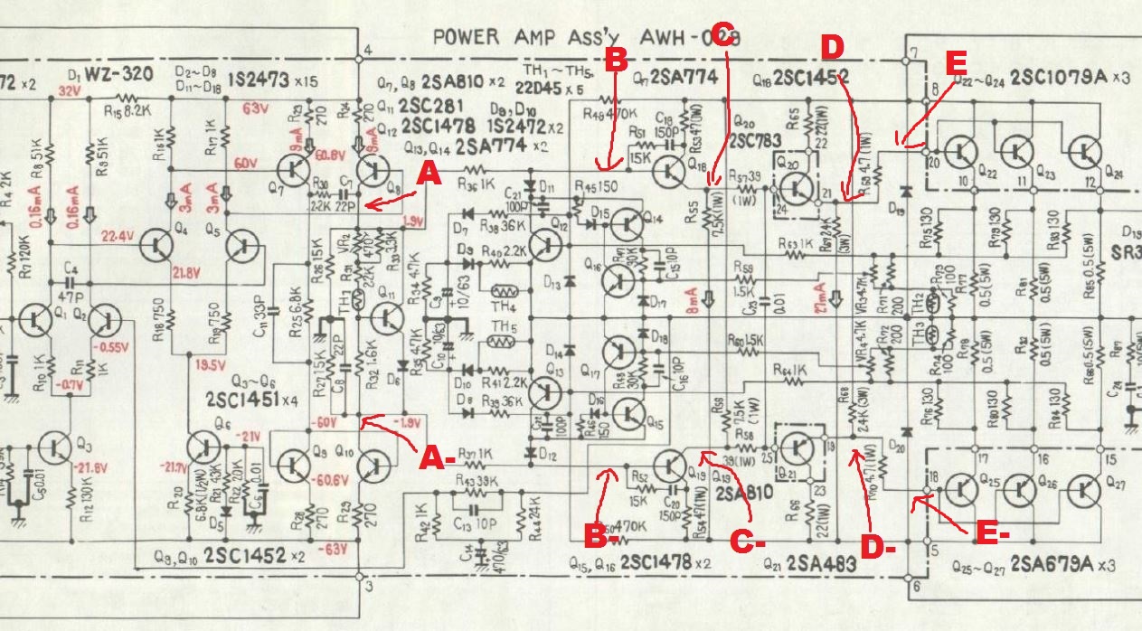

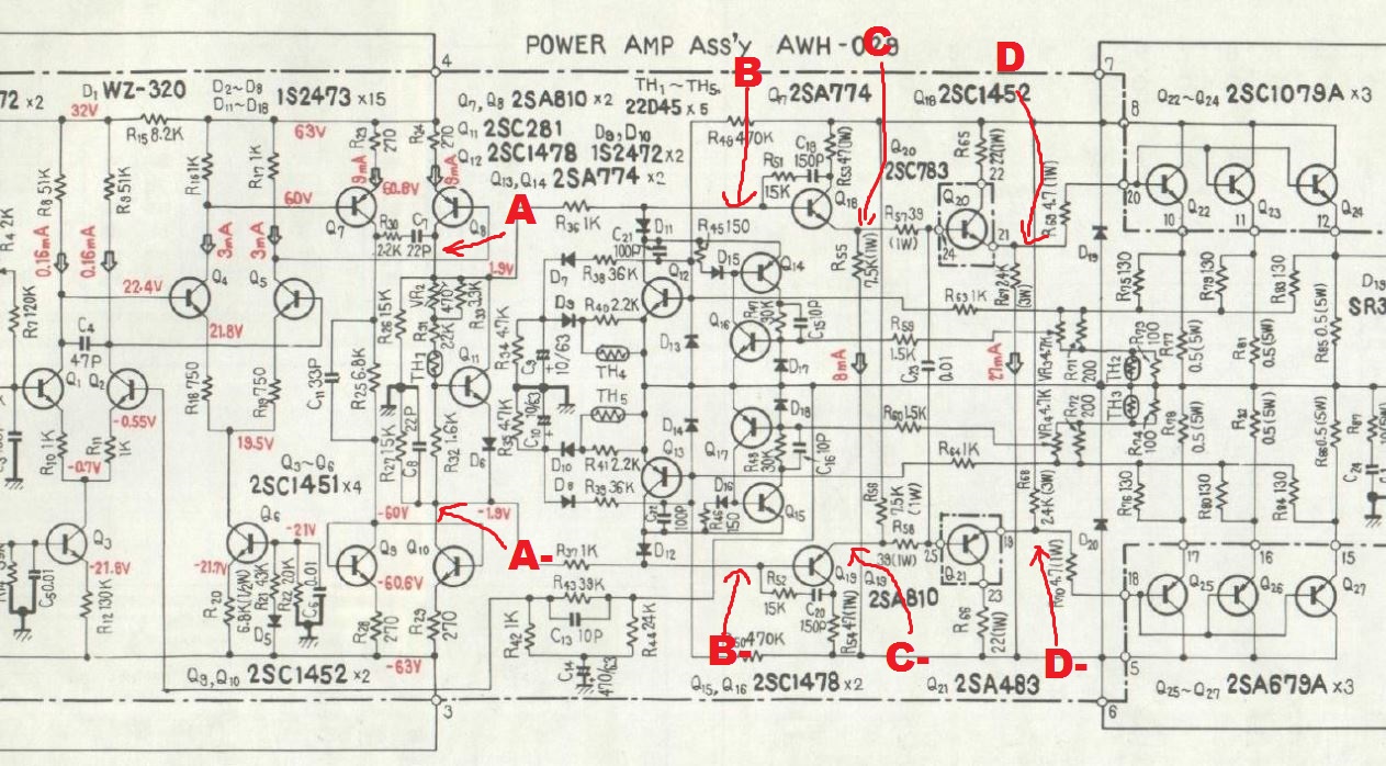

Measure and record these voltages in the same way. You are measuring across points A and A- (which is the 56 volts you measured... recheck it and be sure) and then B to B- and C to C- and D to D-
So one meter lead on B and the other lead on B- and read the result. Then do the same for C and C- and D and D-
Maybe one of the drivers or pre drivers is open circuit but you need to be extremely careful measuring. If any transistor has more than 0.8 volts across its base and emitter then its faulty. That's a good check on those four transistors and worth doing but remember one slip of the meter and it all goes up.

I'm not sure I understanded what you mean with A and A-, B and B- etc. etc
I mean one lead on A and one on A- Then measure and write down the result. Then do the same for B and B- by putting one lead on B and the other on B- and again write down the result. Do that for C and D also. Four readings in total 🙂

I'm sorry, my mistake. Did I not attach the diagram. I've deleted it too... I'll do it again.
A 3.1V

Its really between those letters we want A to A- etc
Can you measure now between D and D- Put the red lead on D and the black on D-

Lets concentrate on the D/D- at 9.5 volts because it should literally be on fire at that. Can you check (with it OFF) that those two 4.7ohm resistors are OK that go to D and D-
That 6.5 ohm reading may be down to your meter and its added lead resistance. But something is very wrong with that voltage reading so lets pursue it.
Can you measure the voltage at the other side of those resistors. That's between pins 18 and 20. In other words between the bases of the output transistors.

What you need to measure now is the voltage across points 18 and 20 (that is measuring between the bases of the output transistors). I've marked it E and E-
You measured 9.5 volts between D and D- so something is very wrong around this area of the circuit.
