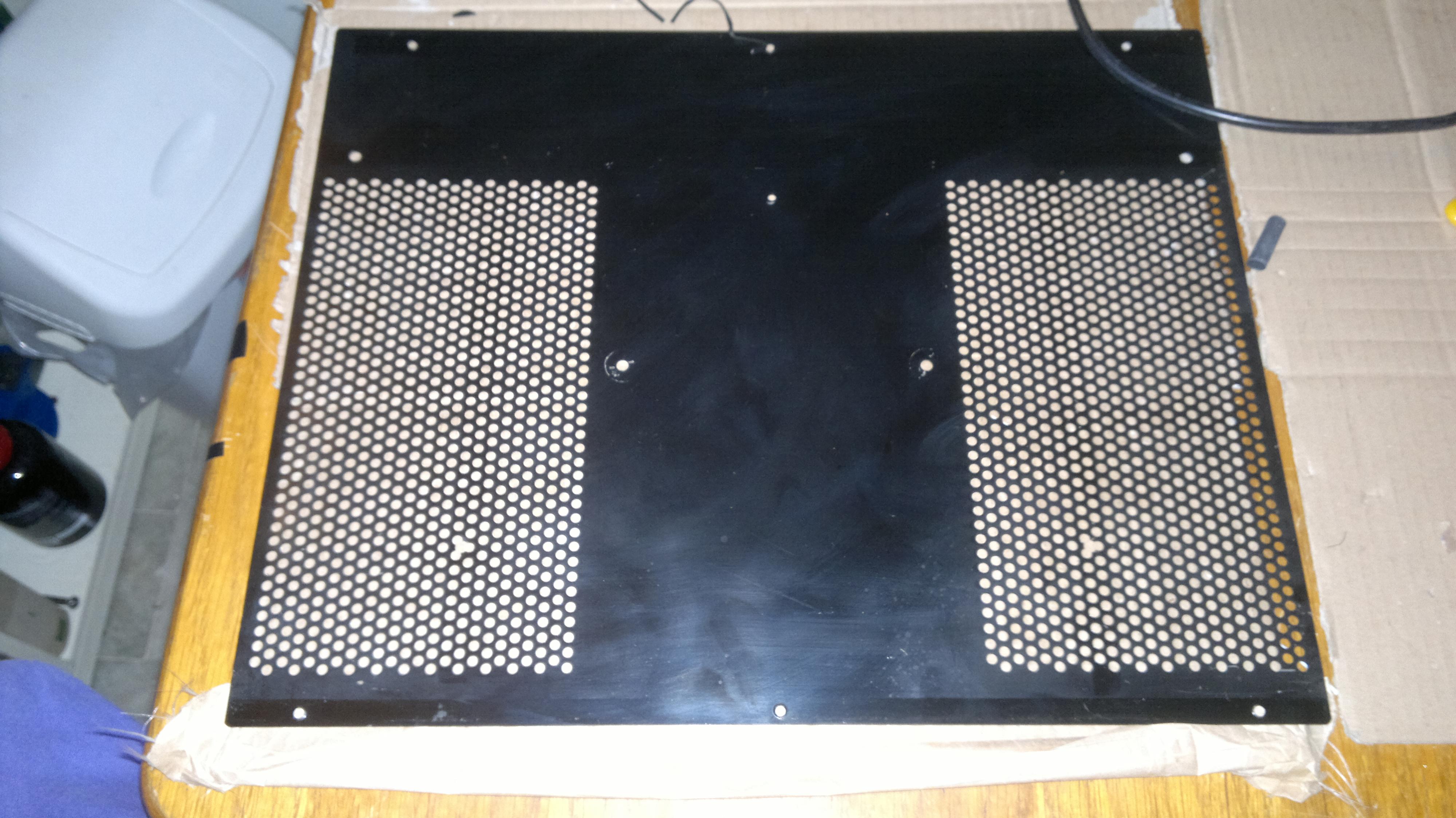

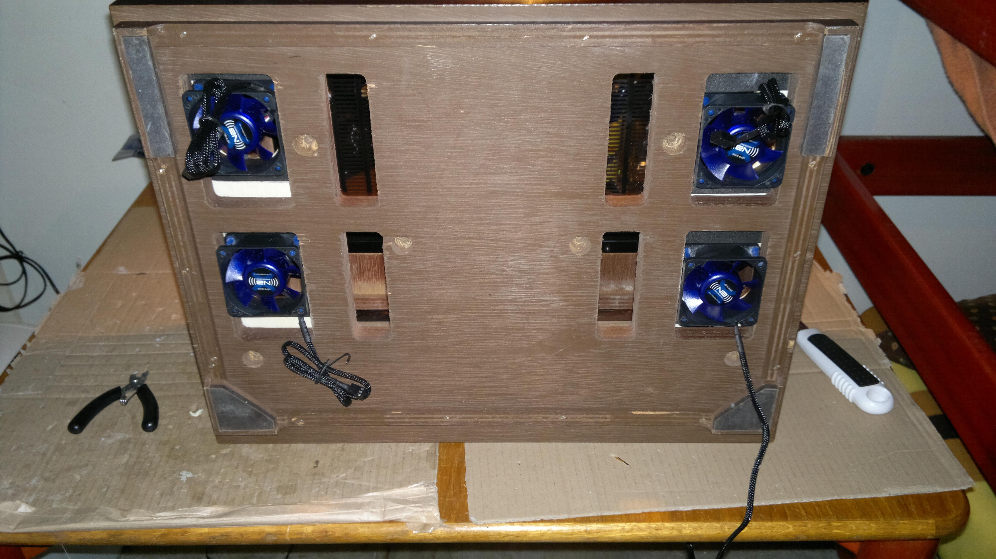

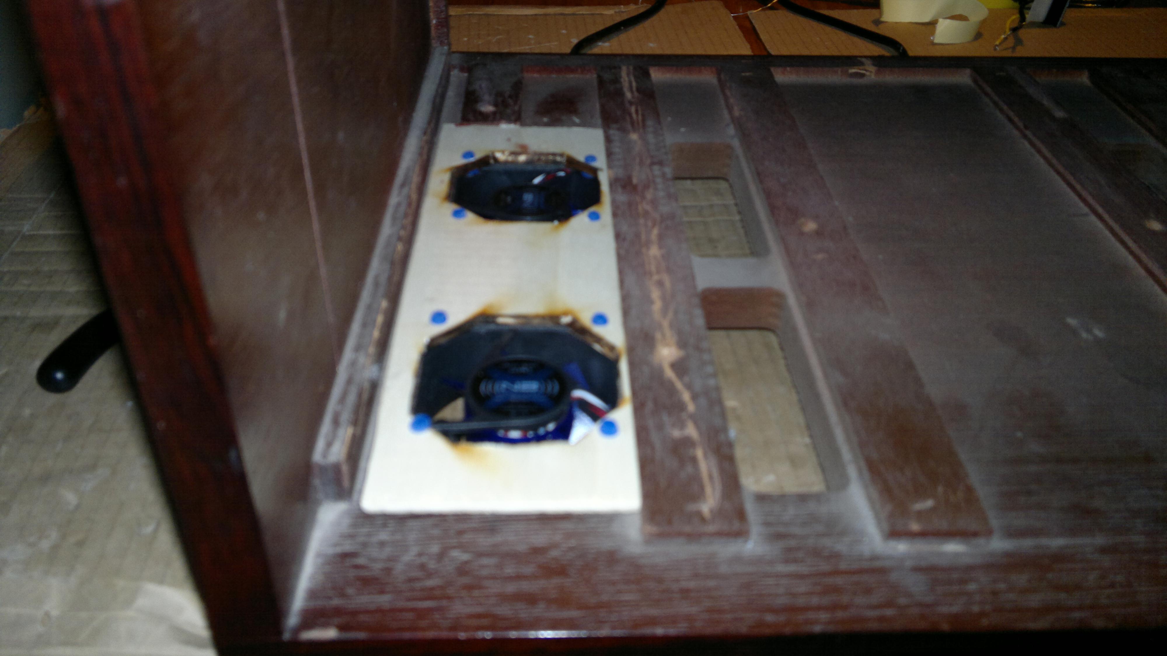

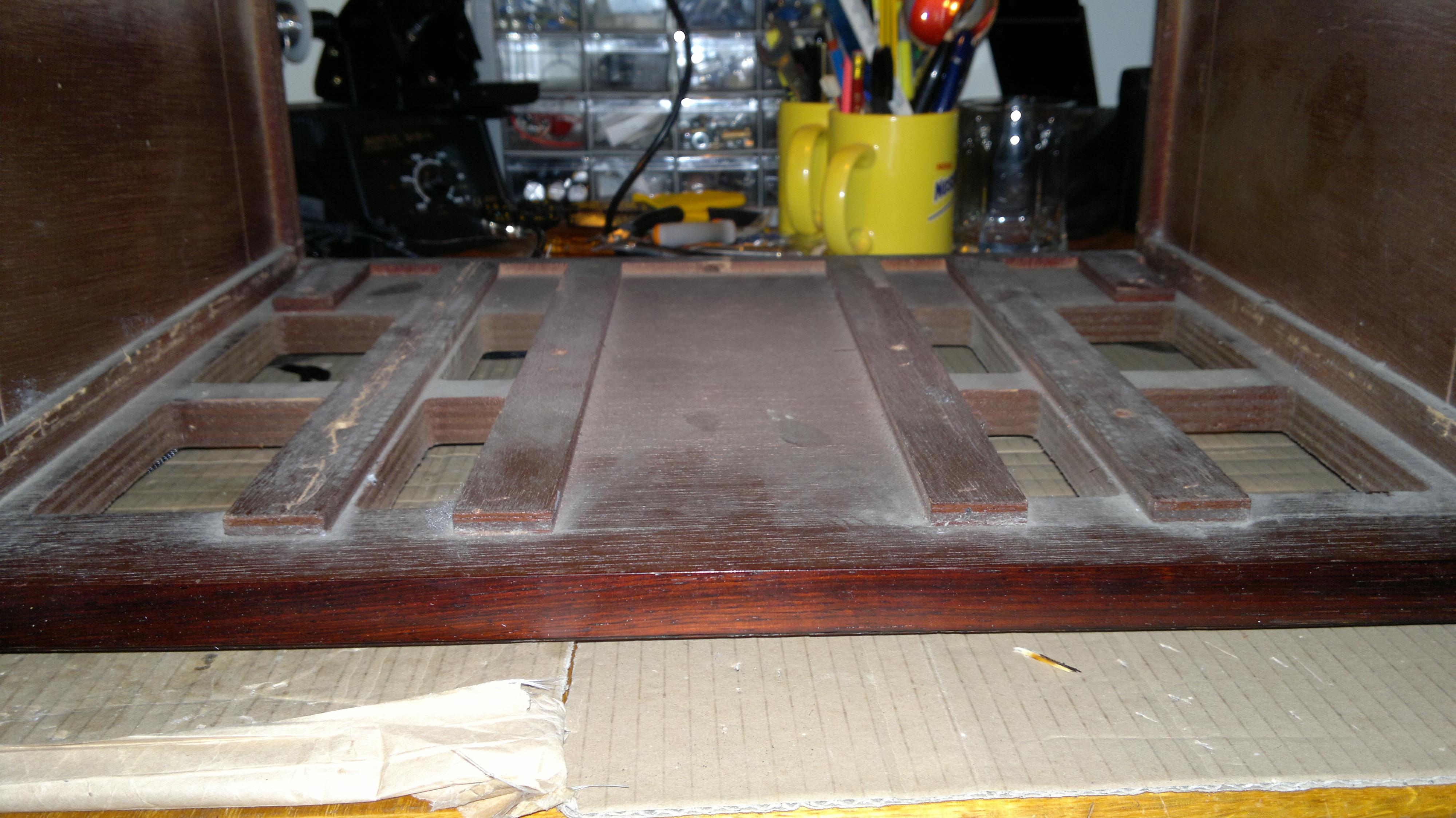

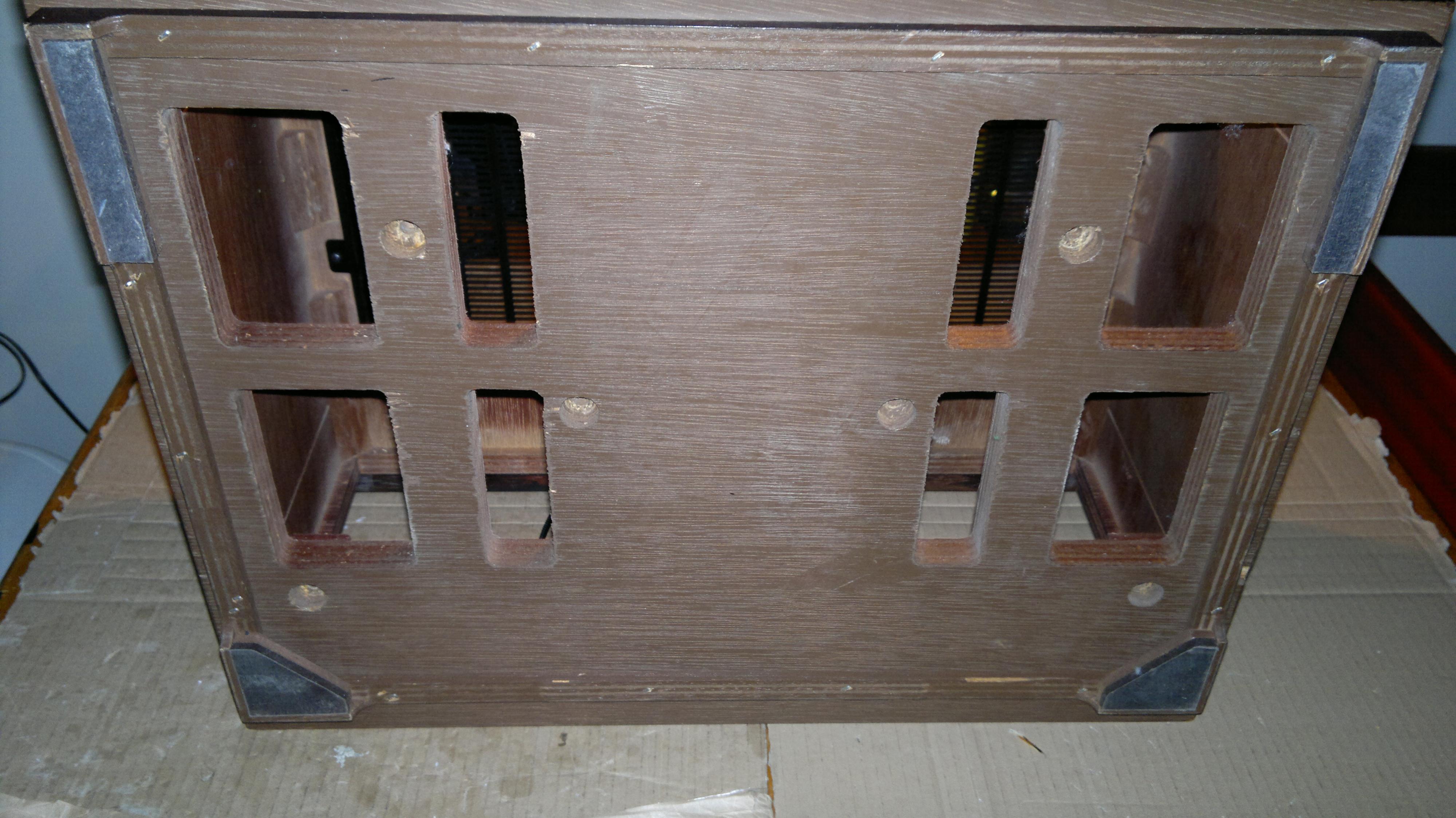

A little update, after 50/60 hours the amp is running fine, I also quite like the sound is really warm but detailed, probably more close to a tube amp than a solid state. Sorry if I can't explain myself in a better way but is allready hard to describe sound in my own language 😀
To be sure the amp will last I added 4 fans and I removed the bottom (pictures will explain better).
Instead of the Noctua €15 I ended up using the Noise Blocker XR-2, 2200 rpm 15db 24m^3/h, for only €6. I'm really satisfied with this fan and I can strongly recommend it for audio equipment, if you need a small low noise fan this should be the right choice
