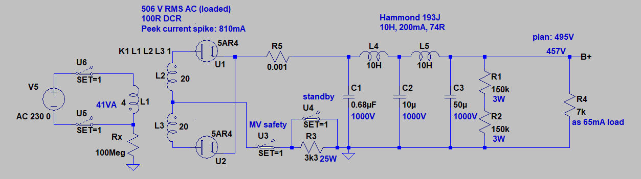

banpuku,
Your transformer high voltage secondary in your schematics is 500-0-500 Vrms.
The 5AR4 maximum rating for the high voltage secondary is 450-0-450 Vrms.
That is a major problem, not enough rectifier voltage rating.
You should use a pair of damper diodes.
You should use a separate 6.3V filament transformer to power the filaments.
For example, use a pair of 6BE3 single rectifier diodes.
They use a different socket.
Damper diodes are soft start, no more switches, no more relays, no more Pops!

Please see attached. For a choke input PS design (which I will achieve by removing the 0.68uF c1), the max is 550V. That said, I may consider the TV diodes like you stated. This will be a change that will take some time to achieve, but likely headed in that direction.
Pat
When switch 2 is open,
won't the lower leg diode be conducting ???
IF that is the case, you have a half-wave regulated
PS running. 45B can sing at that point.
What is B+ when switch 2 is open ?
Switch 2 controls both legs of the diode. The way it is setup is as follows:
1. Switch 1 sends mains AC to Power Transformer, which in turn sends AC to filaments. Also, this creates the 500/500 legs. BUT, both legs are only sent to switch 2 which is OFF at this point.
2. Switch 2 now has 500/500 legs, but is switched OFF. Once Switch 2 is turned ON, both legs of the 500/500 AC are sent to the rectifier.
Hope this makes sense.
If you included an ss diode in series with each plate of the 83, you could use just a single 'switch 2' that is in the HV CT link. In that location, the switch has one pole at ground level, although only 'switch 1' should be used to turn the whole amp off (as the switch 2 contact would have a hard time to open the circuit as it is effectively DC current). The ss diodes ensure that no reverse current flows.
You could have a 'switch 3' to short the speaker, so as to effectively mute the 'pop' caused by the OT primary DC current rise from zero to idle.

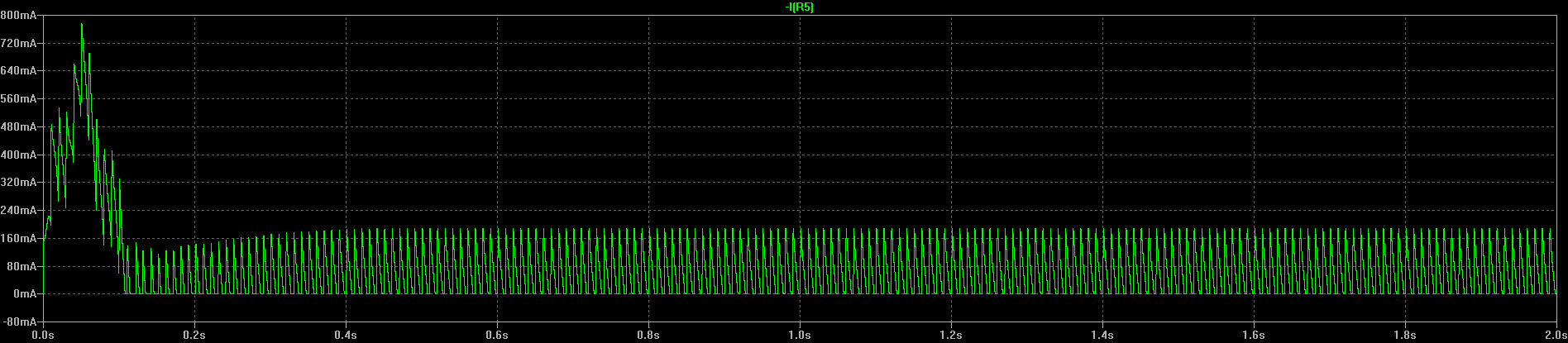

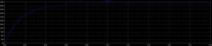

Without "Standby" the MV inrush current reaches almost 0.8A (pic 2).
(pic 1)
All switches OFF.

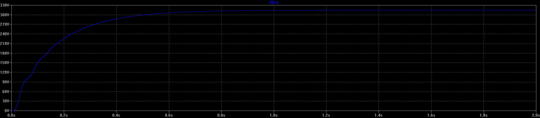

1.) Main switch ON: each tube heating. Mercury evaporating.
2.) When mercury evaporated, "MV safety" switch ON.

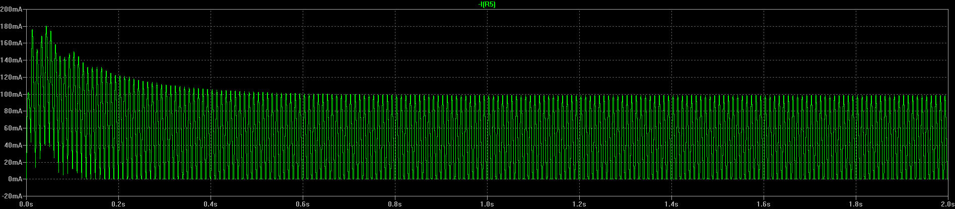

MV tube reduced current flow through R3 (pic 3).

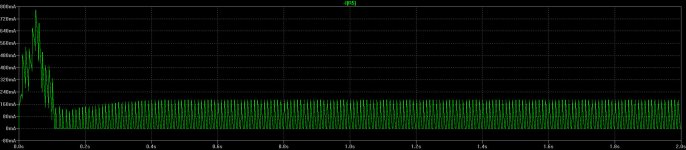

B+ slowly rising to its reduced size (pic 4).
3.) 1-2 seconds later "Standby" switch ON, B+ is on full magnitude.
(pic 1)
All switches OFF.

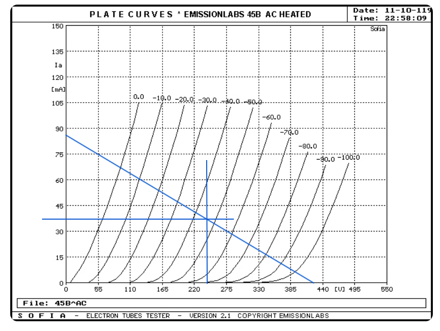

So, here is my first attempt at operating point selection. The 45B grid voltage curves & load lines are attached.
1. Load Line: from 425V (plate voltage) to 85mA (425/5000 = .0085). 5000 is the OPT primary impedance.
2. Operating Point Selected a point midway along the Load Line: roughly -45V (halfway between the -40 and -50 grid voltage curves). This operating point gives: 37.5mA, 240V
3. Cathode bias resistor: 45 / .00375 = 12,000 ohm resistor
Sound good? I want a good balance of highest output power and about 26-28db of 2nd harmonic distortion.

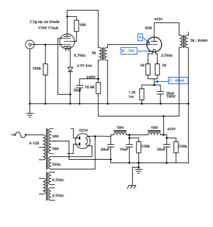

I put the 1,200 ohm cathode resistor in place. I am getting some odd measurements:
the ammeter measures 40mA (measurement location C, see attached)
45B grid vs. top of cathode resistor = -70V (measurement locations A & B, see attached)
hmmmmm. Thoughts?
hmmmmm. Thoughts?
Yes: 45 / .0375 = 1,200 ohm resistor.
hmmmmm. Thoughts?

The 70v makes sense. You are running a high plate voltage. At 58mA. calculated, you have 355v A-K which is @ 20W plate dissipaton. That's close to the table values you posted earlier. Can't explain the ammeter reading of 40mA.
Figured out the ammeter. The ammeter requires a change to its own resistors any time the cathode resistors change. It now happily measures ~57mA.
So, how does do you get that 70V makes sense?
Just general experience, and the table values you posted. With a high plate voltage, I wouldn't expect the bias voltage to drop from @90v to 45v with a cathode resistance change from 1.8K to 1.2K R.
banpuku, your loadline doesn't show a class A SE configuration. I suggest you translate the 5kohm loadline 'up' so that it intersects with the idle operating point at approx 370V and 50mA. Perhaps do some reference text reading on SE amps.

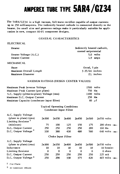

The 5AR4 max voltage is too close to your B+ secondary voltage 500V versus 490V.
Your Pop! is the result of a warm 45 tube filament, and then B+ coming on suddenly when you switch the 83 B+ switch.
The 5Z3 is only rated for 450V transformer, not 490V transformer.
And the 5Z3 is almost instant on, because it is a directly heated filament (no cathode).
Find another tube rectifier, which meets the voltage rating of your transformer, and current draw of your amplifier.
They will have a little more voltage drop than the type 83.
Be sure to use a tube rectifier that is an automatic slow start, (indirectly heated cathode).
That way, you do not have to use a B+ [delay] switch.
No more Pop! at the amp turn on.
This problem can be solved with the right rectifier, you are not going to be able to solve it with the type 83 rectifier.
It is really worth learning ohm's law. If you are feeling lazy... bookmark this site:
Ohms Law Calculator
70V/1.2k=58mA
Purists might say 70V/1200 Ohms = 0.058 Amphere's

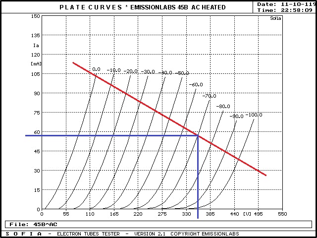

In another thread I kind of went over this for banpuku. Right now I think he is running these very nice and somewhat pricy 45B tubes a little on the hot side... just my opinion..
According to banpuku
A-K (Anode-Kathode) voltage = 425 - 70 = 355V
If you want to know why it is Anode-Kathode, remember that batteries are chemical elements, and in the late 19th through into the early 20th century the language of chemistry was very much a German domain...
From Ohm's law already, we know that the 45b is drawing 58mA
I took the liberty and drew a 5k "Load Line" on a screenshot of the plate curves (from the manufacturer's website) and moved it around until it overlapped with the point corresponding to that 355V and 58mA. This "Load Line" is not 100% true since our speaker is not a resistive device, but inductive. Nonetheless, it gives us a decent idea of power range the tube/valve will encounter.
Personally, I would be thinking of ways to get the A-K down to maybe 300V biased for 50mA. The plate would probably be at around 360V and the cathode (still using this 1.2K cathode resistor) should be around 60V for this to happen. Yes, this will mean less power, but there is a big benefit if it is done right. Basically I agree with trobbins. 🙂
This should still sound excellent, with great linearity, and allow for decent power and a bit longer tube/valve life.
