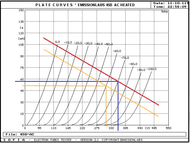

Thanks for the input soulmerchant / trobbins. Very educational.
Why does lowering the B+ and moving the operating point make sense? Is it because we want the operating point in the middle of the load line between the -0 and -100 bias points and thus will give the amp more breathing space before saturation?
Please see attached load lines reflecting the proposed new operating point (orange lines). Roughly, this equates to 52mA and 305V. Question: once an operating point is selected, how important is it to dial in the exact voltage? Given our target is 305V, is 300 or 303 or 308 or 310 OK? Or is this done via ear/listening? Or measurement via an oscilloscope?
The 425V B+ assumes the 0.68uF c1 (in the power supply) is removed from the circuit. So, in order to get B+ lowered even further, I will need to insert a resistor after LCLC, correct?
How much did you pay for that tube, and how long would you like it to last? Why do you want to drive it to or past its max ratings? Are you just experimenting? Your PT isn't really suited for that tube if you don't want to waste its power with B+ dropping resistance.

"The operating point is the intersection of the plate load line and cathode load line. Notice how the bias point is just about in the middle of the load line from the 0 grid volt line to the bottom of the chart. That means this triode is close to being "center biased" which minimizes distortion and allows the maximum plate voltage swing before symmetric clipping begins.
A lower value cathode resistor will "warm the bias" by shifting the operating point to the left and up along the red load line. A higher value cathode resistor will "cool the bias" and shift the operating point down and to the right. Moving the operating point away from the mid point between the 0v grid line and bottom of the chart will reduce clean headroom"

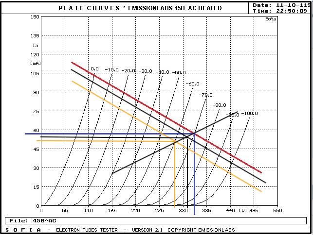

This aligns with keeping the tube life longer, minimizing distortion and maximizing headroom. The attached load lines now identify the cathode load line (Black). Looks like the orange load line and operating points are a good balance of warm/cool bias, aka middle bias point.

good idea, 20to20.

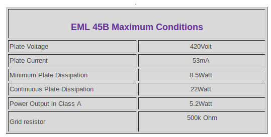

Pat, forget anything I've posted for this. That table of suggested operating voltages is confusing because it says Vb and Ua are different by Ug (-87v). That means Vb is the plate voltage, and I have no idea what Ua is if it isn't anode voltage. So carry on and good luck getting this set up for reliable operation. Not to mention reading somewhere that the 45B has a 420v max plate voltage.
I reckon Ua is actually Uak, by inspection of the Emission Labs webpage:

If you ballpark 50mA idle, and the Vak=400V examples on the Emissions Labs webpage, then Vak would swing from circa 150 to 650V. How well that keeps away from saturation and cutoff, including for inductive loadline, is perhaps best checked by measurement.
A+
OK, EML says 420v max plate.
And that prior posted table is for SE cathode biasing and Vb is supply B+ not plate voltage and Ua is plate voltage.
