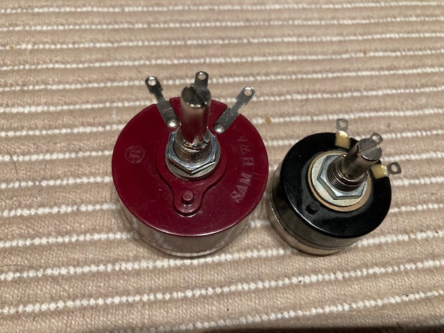

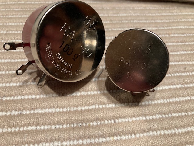

Here are a couple of pots that I have used in the past. One is 100 ohm, the other is 50 ohm.
Both are wire wound. The center tap goes to the top of your cathode resistor.
You can also just use a couple of 2-3 watt 50 ohm resistors from each AC filament to the top of the cathode resistor, but you won't be able to fine-tune it.

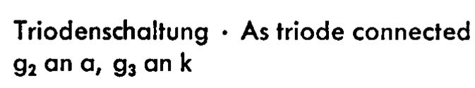

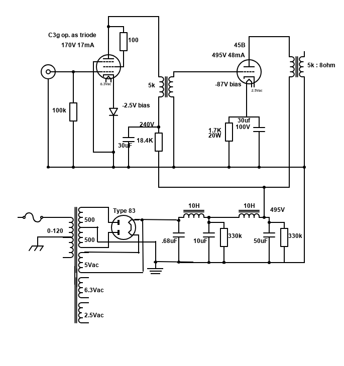

Here is the latest schematic. The EML 45B does not have a center tap, only 4 pins. 2 for heater, grid and anode.
Ok, connect G3 to the cathode on your c3g tube. Connecting it to ground will probably not hurt it but it might reduce gain. Its not like this in the specs sheet..

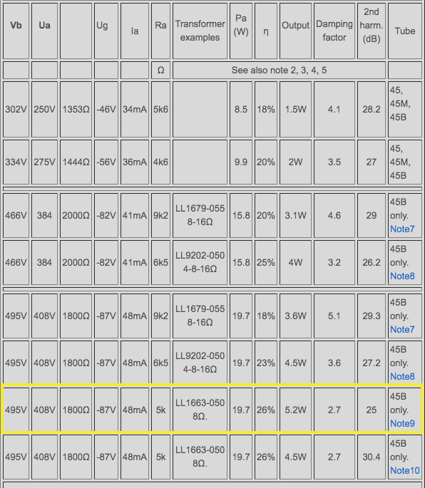

I think someone indicated this already, but your cathode should be around +87 Volts since you are doing "auto-bias" or "cathode-bias"
According to the emission labs specs for the 45b tube it looks like are trying to run the tube at 48mA.
so, this means with your 1.7K ohm cathode resistor, you want to measure around +81V at the top of it relative to ground.
IF you are measuring significantly MORE than +81V, then use OHM's law to calculate how much current your tube is passing as it might be TOO much.
In this case you will need to reduce your B+
Pay close attention to their Maximum conditions quoted by Emission Labs. Don't push it hard.
Running hotter will probably sound great, but your tubes will likely not last as long.

Team - progress! I did the following:
1. Per soulmerchant, connect G3 to the cathode on your c3g tube
2. inserted 2 x 56ohm resistors attached to the AC filament supplies (at the 45B filament pins). Tied the 56ohm resistors together and attached at the top of the cathode bias RC network.
1mV hum (undetectable from close to the speakers)! Yes!

OK, more measurements. Note, I am trying to hit the EML 45B recommended operating points (see attached, Yellow highlighted operating points).
1. 45B anode vs. ground : 475V. If the 1st C in the power supply is changed to 0.8mF instead of 0.68uF, then, according to PSUD, we get the extra 20V needed to hit the 495V target. Are there other ways to increase the B+ besides increasing the 1st cap in the power supply?
2. Top of Cathode resistor vs. ground : +83V
3. Top of Cathode resistor vs. 45B anode : 391V
4. 45B current still running at 49.5 - 50.0 mA. Is this too hot? I would like 48mA to match the recommendation from EML. What would I change to hit this target?
