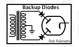

OK, back to the 83. Does the attached schematic look correct for use of the backup diodes to help with the "pop" issue that is causing the 83s to die?

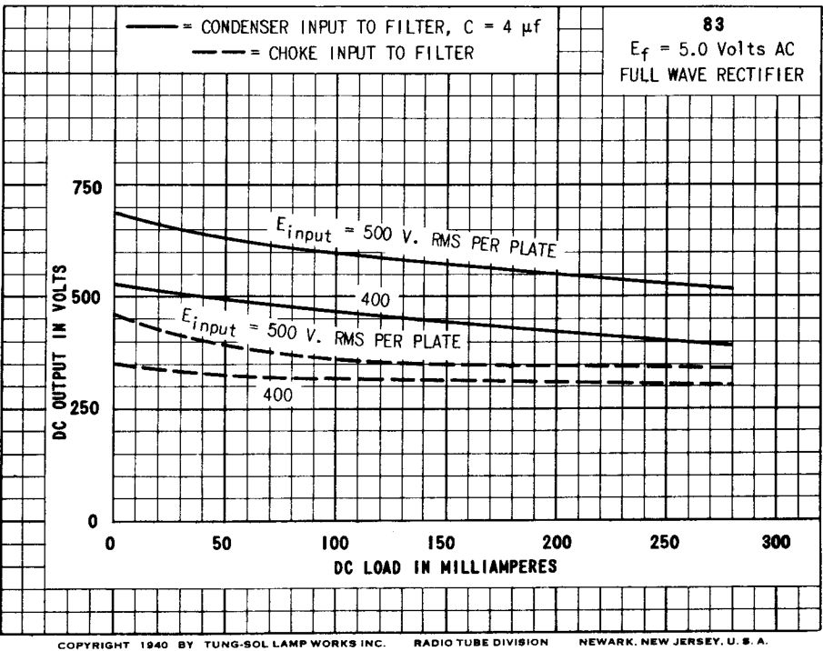

IMHO 83 is too "tiny" for this job.
I regularly use mercury vapor rectifiers, but within the limits (not more than 80%).

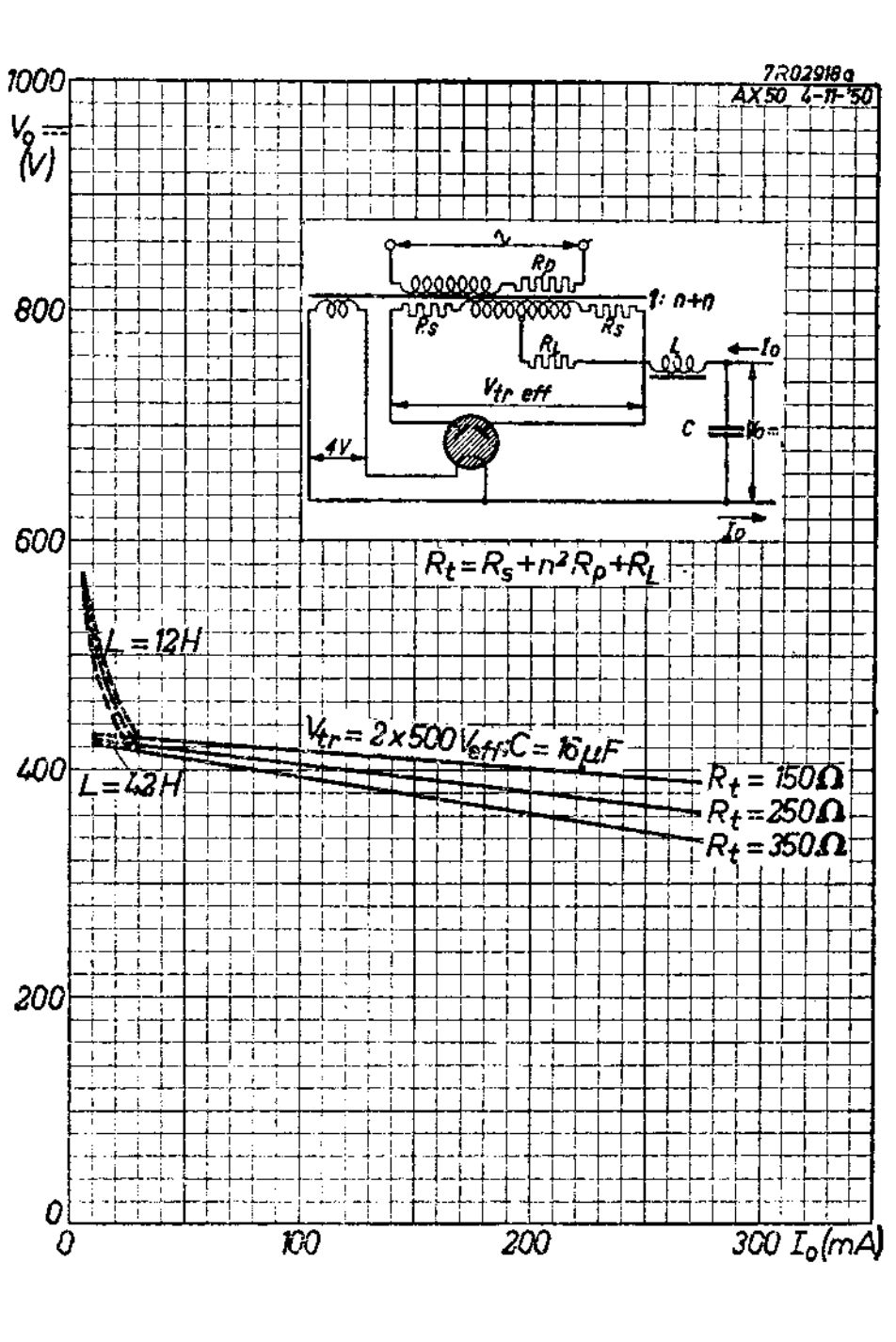

My AX50 tubes are more robust ones than 83, but not "all purpose" devices.
If I wan to use rectifier tube over 500V, I choose kV capable tube (for example Tungsram PV200-1000).
83 datasheet is laconic to AX50 datasheet.
Minimum inductance (at choke input case) is only one parameter, if you don't understand devices behind it, it's meaningless.
As you see, the AX50 define relatively small capacitor value after choke.

Adding 'back-up' diode as shown in your last post effectively stops arc-back, as the external diode experiences the inverse voltage and stops any reverse current. The external diode has to withstand 1.4kV with some margin (margin for a higher secondary voltage, and margin because you are using multiple diodes in series). I recommend using three 1N4007 (from the same batch) in series.

The RGP02-20E-E3 is a low cost 2kV 500mA diode, available at Mouser and the like. Takes the worry out of series-string diodes. Use two in series, if you want to be extra certain!

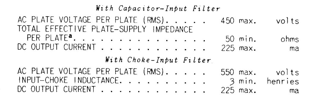

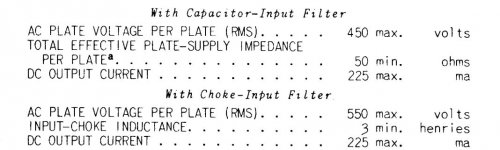

What the OP hasn't done is to provide a PSUD2 simulation to confirm the peak plate current doesn't exceed 1.0A during energisation of the supply.
