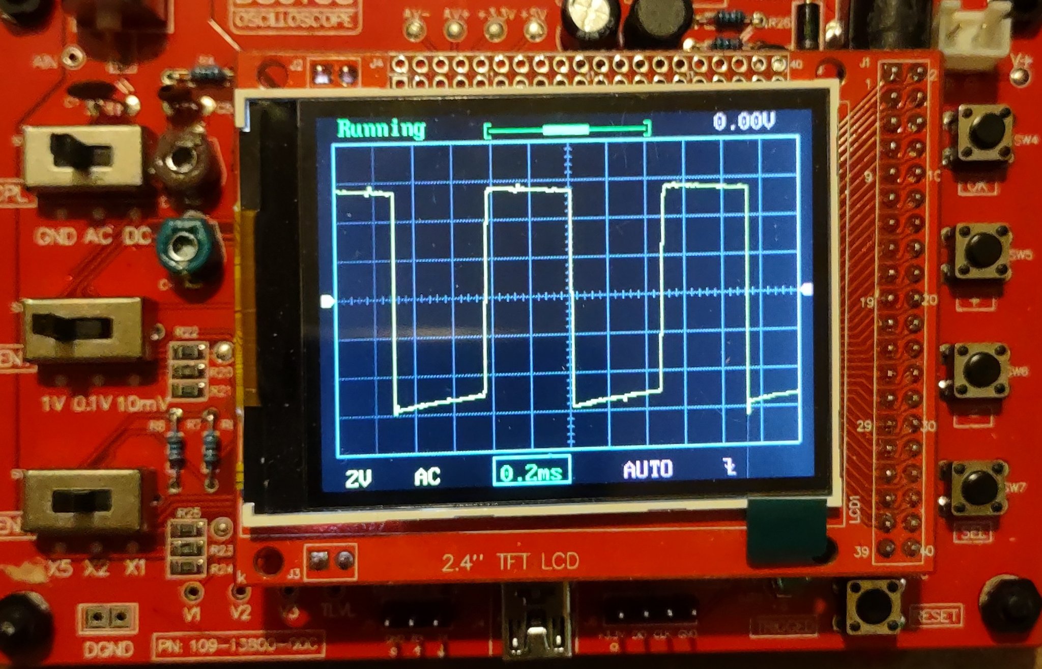

Gentlemen, yes, this thread is a nice example for good information of basic problems.
Today it seems I am in didactic mode :
Post 1: as others said for a simple tube amp this is a quite nice 10 kHz square wave.
Consider the bandwidth of the simple scope also - as said in post 18 and 19 and good
advice in post 37.
Post 5: the 1 kHz wave also looks good. Set the input switch to dc and show the result.
The hf ringing you see is from some transformer resonance. It looks small for me but
will increase without load as said in post 10.
Post 6: which frequency ? With the given remarks it should be 1 kHz.
Post 8 : the explanation is square wave contains a sequence of frequencies up to infinity
(with deceasing level) and this signal can never be transferred in a perfect way. The hf
information is in the edges - see post 14, 38 and others. The flat part contains information
about frequencies even lower than the fundamental.
Post 10: yes we should look at the response of your scope to the input signal from the
generator, confirmed in post 11 and 25.
Post 15 : post 10 is fine, except "tweak feedback" ..
Post 24 : for a test like this it is perfectly adequate to use direct wiring and no probes.
Remember this is a speaker output, no hf device (remark to post 26 also).
Post 26 : I think it is more like nine harmonics ..
Post 27 : you should not expect perfection from cheap and simple set ups.

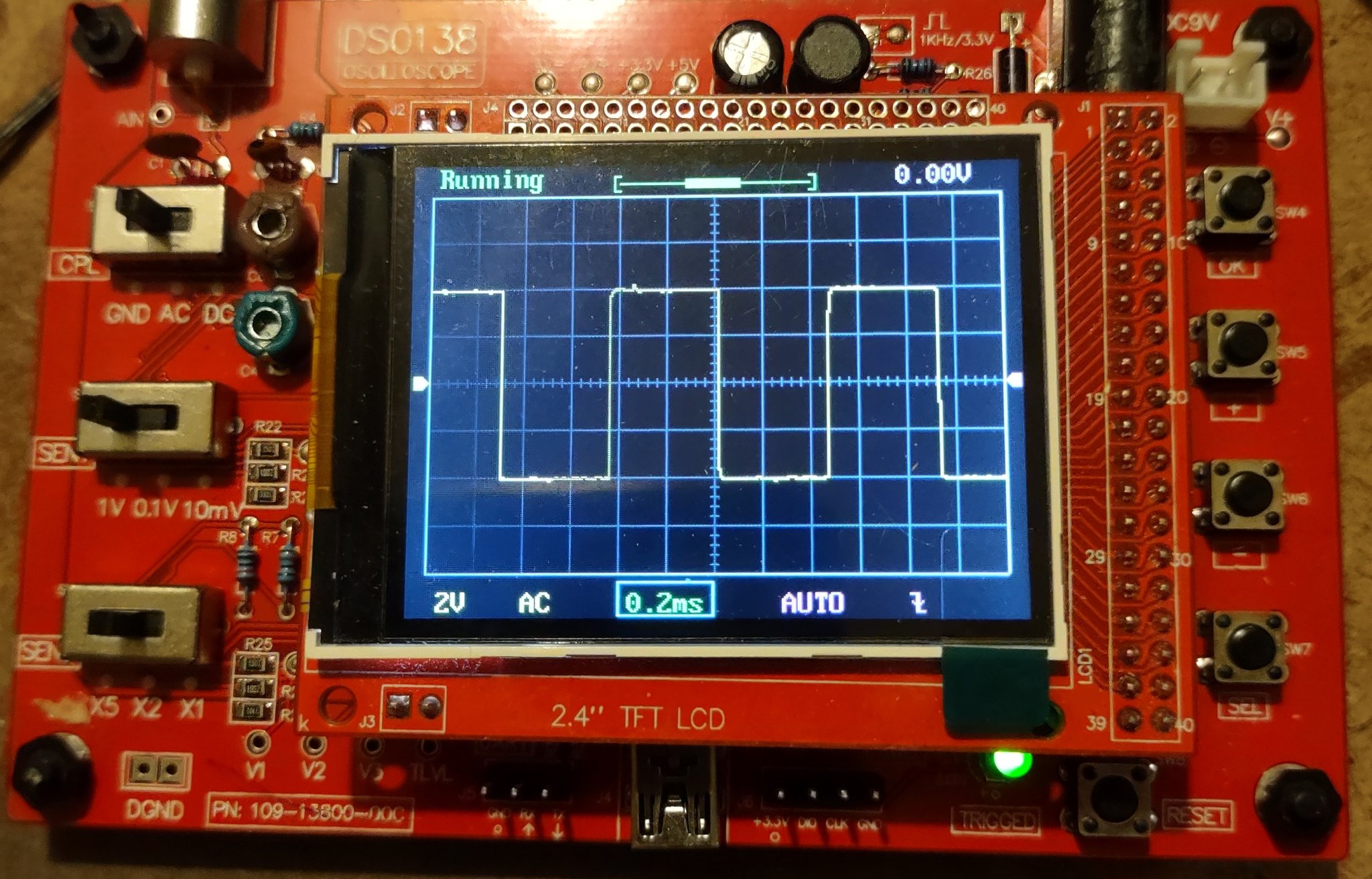

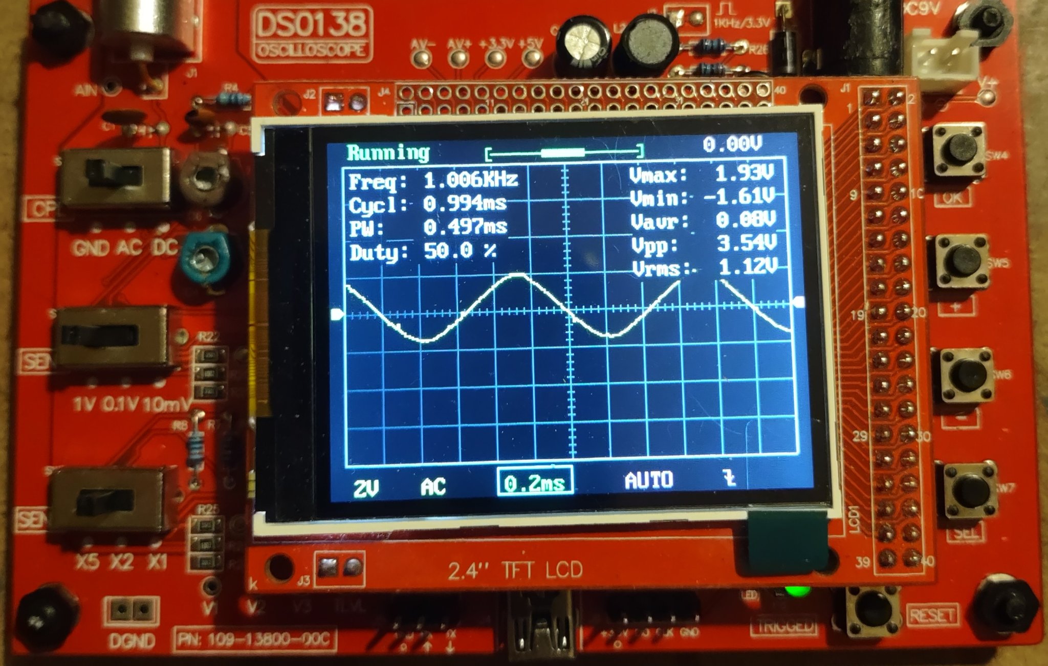

Here is a 1kHz wave direct from my source to the scope.
Also trying to figure out scope terminology. So, it's set at 2v. Is that 2v for every Horizontal line away from the center(zero) line? And 0.2ms, is that per (vertical) division as well?
Anyway, here's the same signal run thru the amp with the volume pot open:
So not quite 2v gain?
This sees to indicate a gain of only 1.5 ..
For a power amp you would expect 10 .. 30,
but here we have only a single driver stage.

Or it's just clipping. The square wave signal is sneaky 🙂
Turn the volume pot down until the amplifier signal is +/- 4V. Then measure the amplitude at the potentiometer output.
Depa, editing your post 50 later makes my reply useless.
"The square wave signal is sneaky" : yes, it is 12 Vpp, not
sure it is clipped, the test should be repeated with sine or
triangle wave.

The numbers in circles are the pins of the double triode not voltages ... grid is 0V , cathode 1.7V and so on , of course the clipping possibility is real .It is clipping for sure. Grid voltage of 6SL7 is 1.7 V and
Input signal seems to be 8 Vpp. I recommend to use sine wave. Then possible clipping can be seen.
hi...please put vol of your amp to max ......and control sig amplitud by sig generator ... check a gain 10khz sq.Best scope I've ever owned 🤔
