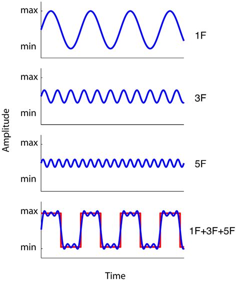

A square wave can be thought of as the sum of a sequence harmonically related sine waves with set amplitudes. An ideal square wave requires an infinite sequence of harmonics. In the real world changes in amplitude of the harmonics diverge the shape of the wave from square.

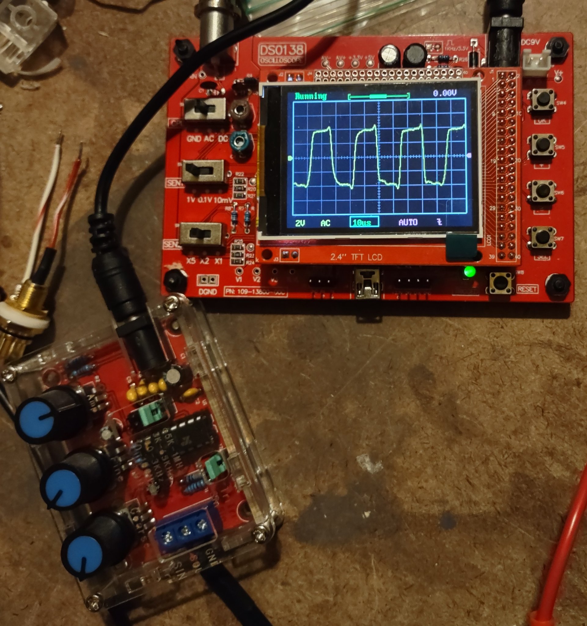

I just asked my wife to get me the kit for the DSO138 for Christmas, along with the clear acrylic case. You've inspired me. I have a PicoScope 1542D, and 2 Tektronix digital scopes. I also like those clock kits that don't quite keep time but are a lot fun to put together. LOL

Hi Rayma, It is a 200kHz scope, so even with a proper probe (they do come with one) it will be challenged to display a near perfect 10kHz square wave. I asked for one of these scopes for Christmas because it looks like fun to put together. They cost literally nothing. 🙂

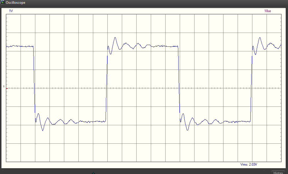

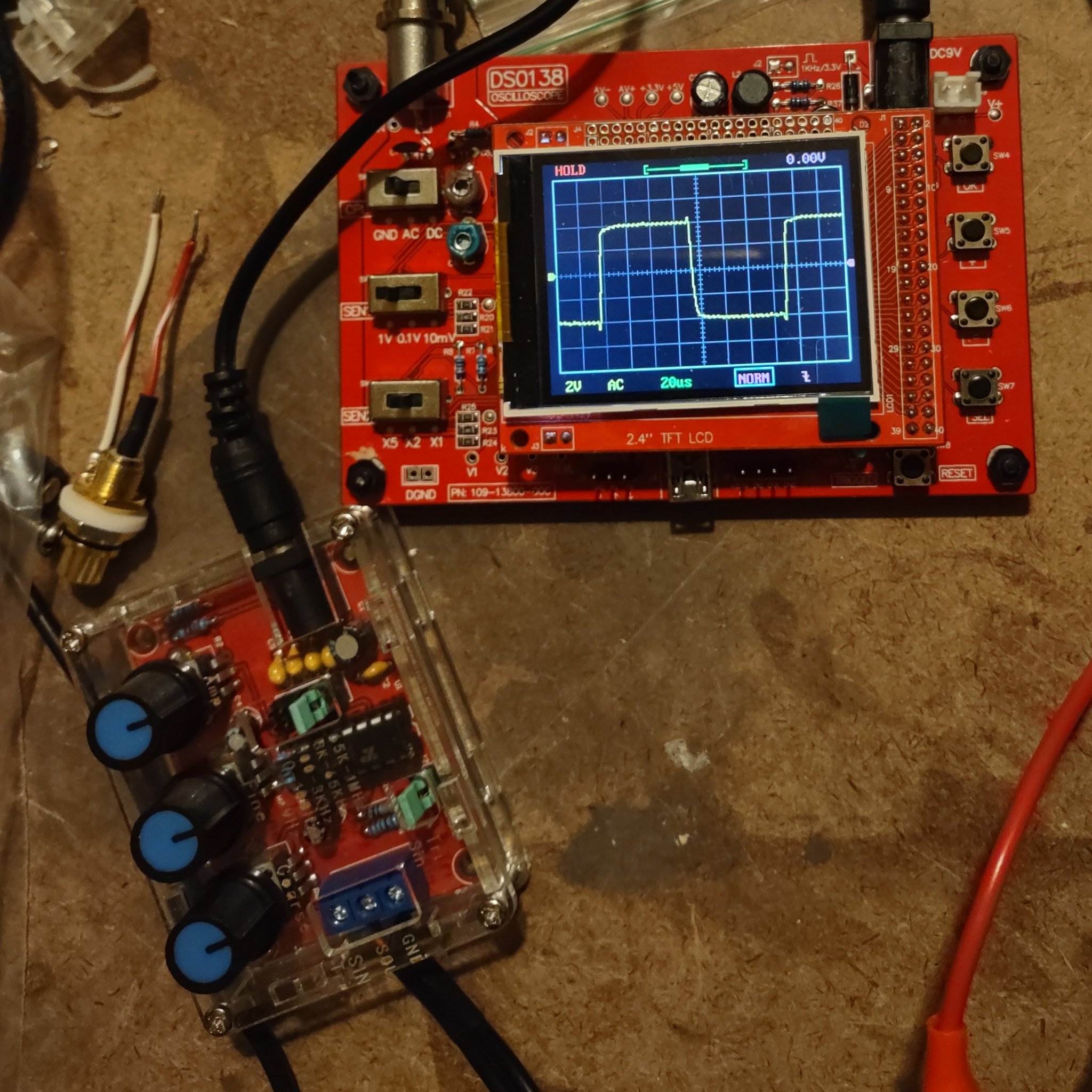

Show us what it looks like with probe connected to signal generator, i.e. no amp involved...
Something around 10-20k straight from the gen to the scope. Hard to tell exact freq coz it's just a knob. Range is 3-65k.
The generator or the scope can't keep up in the 65k+ range. This shot is the top end before the square gives away to a shark fin:

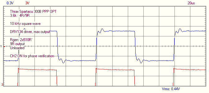

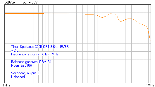

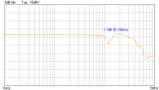

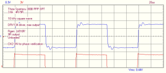

It may be helpful to understand that a square wave is build up of a sinewave at the fundamental frequency, plus a sinewave at 3 x fundamental frequency, plus sinewave at 5 x fundamanetal frequency etc.
For the square wave to be really square, these sinewaves need to be in a precise level.
The 3rd needs to be 1/3 the fundamental, the 5th at 1/5 the fundamental, etc.
Since all amplifiers are low pass filters, the 3rd, 5th etc components will be attenuated with respect to the fundamental, which gives the rounded edges.
So it is absolutely normal, in fact if it wasn't it could indicate a non-flat frequency response.
Jan
Reactions: kevinkr and dubadub
I'm attaching some square wave vs frequency response comparison, so that you get a hint of what is happening one vs the other.
