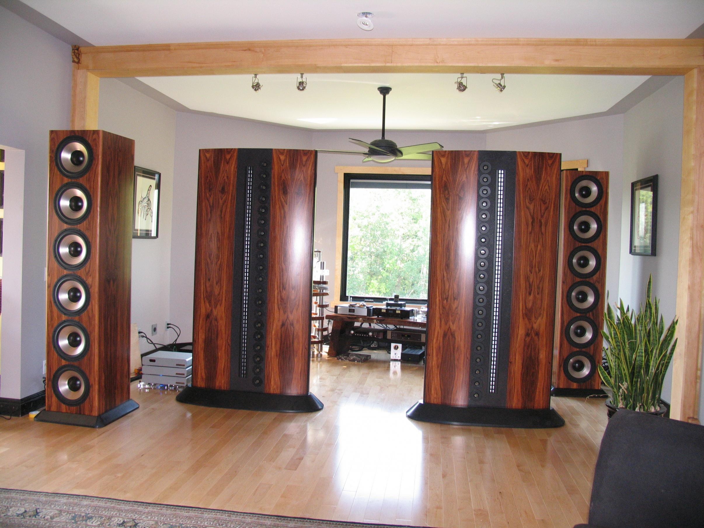

this is beautiful!
I have to respectfully disagree:
Three ways coming.
David
How very "Vernish", Steampunky. There is something great about that stuff. It still hasnt hit full stride as accepted decor.

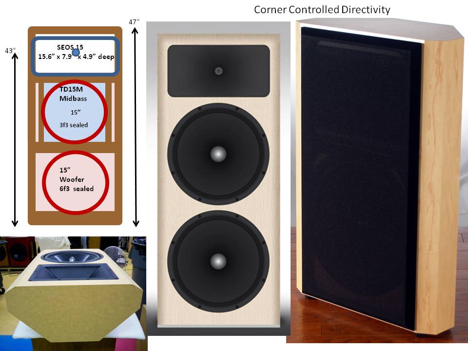

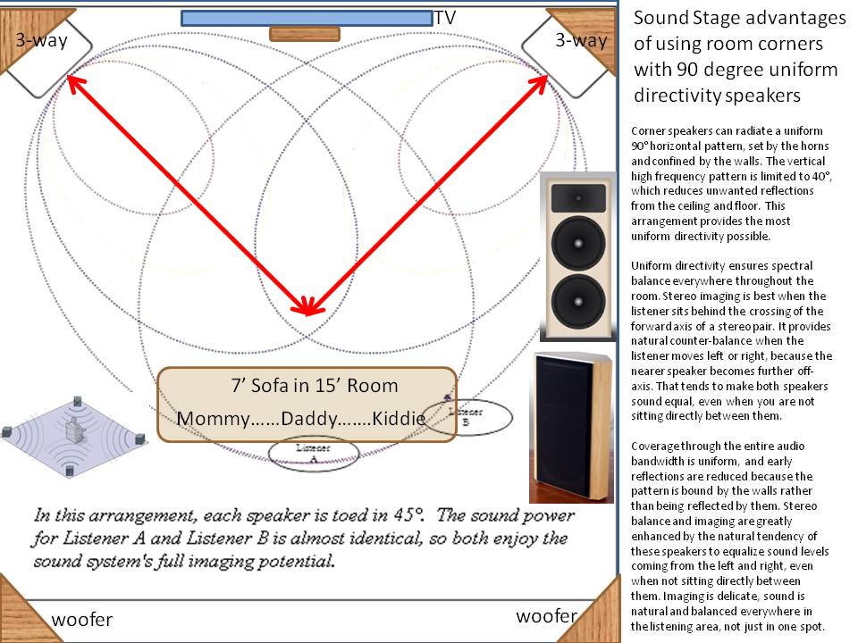

To me, a corner design is very simply *the* starting point. The room must be made and furnished to accomodate it. Holy grail imo, point source as much as possible eminating from corners. It gets no better.
The above design has hundreds of things going for it including the waffy thing.
naaah, its too big for any WAF

That would be a great idea (maybe a 10" version) , if the room was more rectangular. Now there is no corner where the right speaker should be mounted.Honey, I will Rock your World!
Corner Controlled Directivity Speakers.
