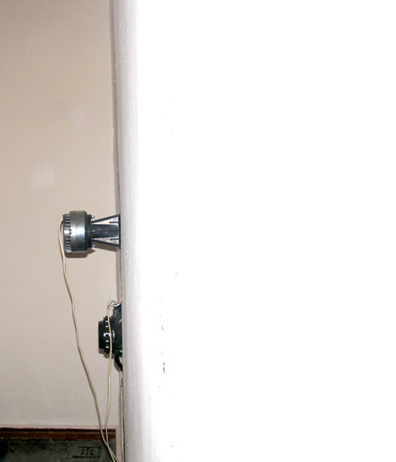

for my GF it's o'k:I measured the thickness of the wall yesterday, it is about 9 cm in total. I'm guessing that it means 70 mm wood/void and 2x12 mm plasterboard. What woofers are thin enough (maximum depth of 80 mm)?..

LF is 15", HF 2380 horn, wall - 2*(4cm wood + 1cm plasterboard)=10cm 😀
This setup is extremely more WAFed than ~1m long (whith driver) MB horn))
a massive 100mm front baffle
you are lucky to have a free adjacent room for the box
for horn construction this might be the perfect solution 😉

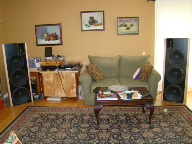

Speakers can be moved...You could use a planer on top of a woofer box disguised with the fabric of your choice...pushed right up too the wall most of the time, and pulled out into the room for "serious" listening.
My wife is very accepting but for me the speakers can't live out in the room where they sound best. Once and a while I drag them out to some marks on the floor and later they tuck back to the wall. As a side note the difference sound is almost not worth the trouble of moving them.

For me, there is a huge difference compared to my speakers with 3 feet behind or only 1 feet behind. The bass is booby as hell if they are at 1 foot, not defined, not snappy, boomy as hell, but when pushed at 3 feet, it sounds perfect
I agree some speakers are design to be close to the wall.That's because you experimented with speakers that were designed to be used in free space.
If the design is done right to actually take into account on wall mounting, the results can be excellent. Baffle step needs consideration as well as bass alignment.
but no matter what, bass is omnidirectional and so it will be affected by the back wall, you cant go agianst physics. and not only the bass is affected by the back wall, the whole spectrum will reflect on the back wall.
anyways, every speaker ive tried sounds better way into the room, they all benifit, some more then others and my main speaker bass sounds like crap if too close to the back wall in my room. Every room sounds different, but my 12 inch cabinet too close to a wall is boomy and at 3 feet, sounds amazing.
