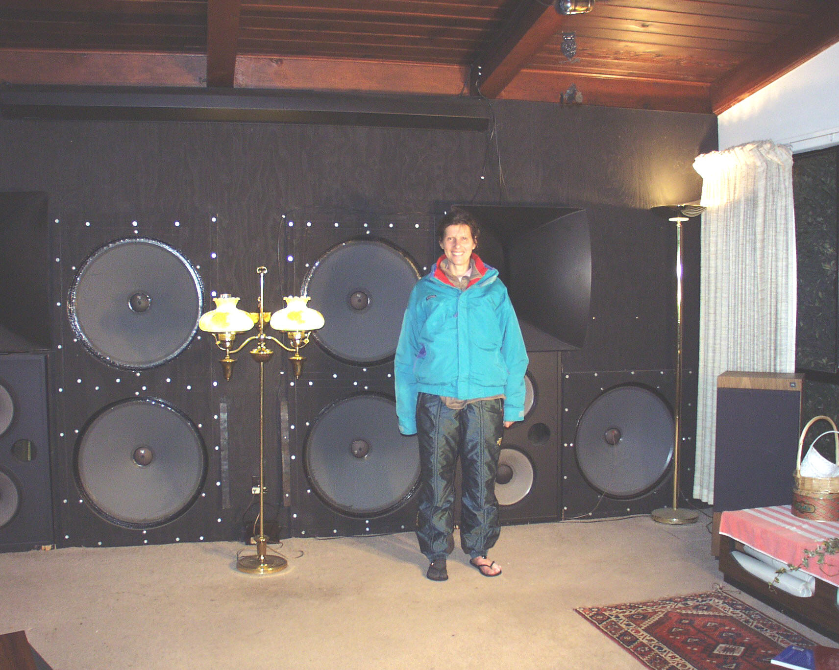

Dug Ronald's wife and speakers:
his speakers seem to have the right WAF factor
or his wife have the right speaker factor 😛
...that's what they call "knock her socks off" speakers!
OMG! 😀 From the site:Dug Ronald's wife and speakers:
"This is Kristin for a size perspective. She is 142 cm (5' 8"). Kristin is wearing a snow-suit indoors because after buying and building this system, I can't afford to heat the house. Don't ask about the missing sock..."

In the 70's i also ran a Pr of 30" EV's, the term back then was not subwoofer, but subsonic driver. With such humongous mass, you could not xover the driver much above 50hz, too much distortion if you did , so i settled on 55hz. The Lowbass was absurd, you cannot believe the detail this thing pulls out, or the limited amount of LP's that actual gave you much info below 50hz ..🙂
Sadly i had to sell when moving some 35yrs ago and could never replaced them years later when i wanted a pr again, so , sadly have to live with (4) 15's for subs.
Rats ..🙄
I cant even begin to imagine what 6 of them sound like but can speculate most of the bass is in his neighbors house ...

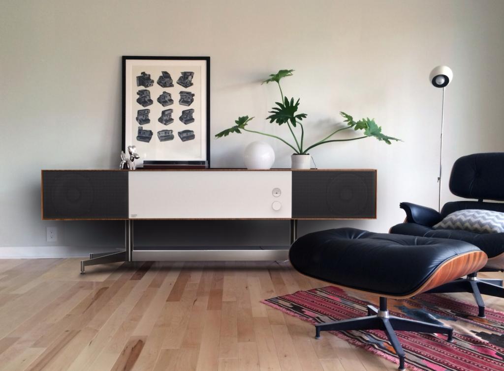

Not in our living room though, it has a way too strict/modern/scandinavian touch.
/Anton

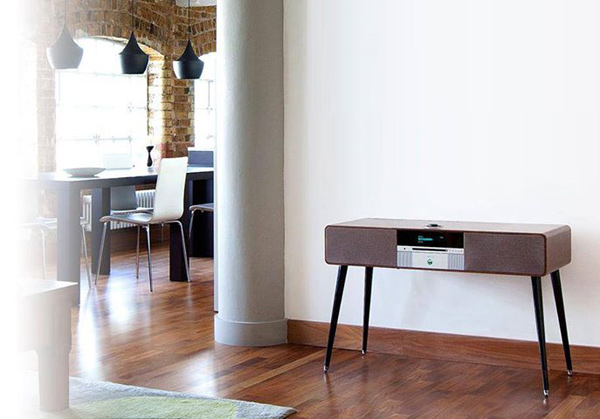

You'll need a modern console speaker. That's it 🙂
Or a bigger one

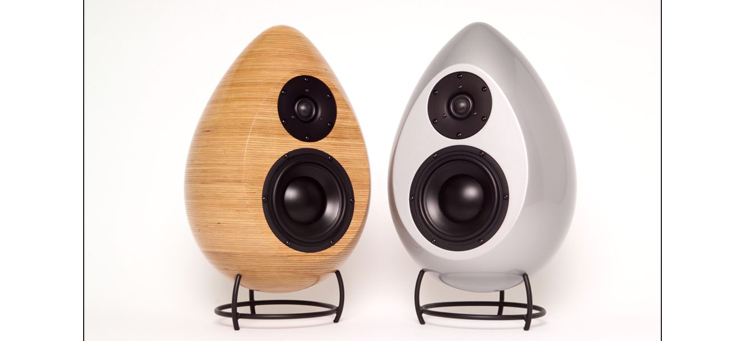

5. What about the spheres
After this I felt that my first (paint) sketches were a decent guess. She has two problems with the spheres in the bedroom:
a) The finish must be "like they are made in a factory". I think this is criticizing the fact that the spheres in the bedroom don't have an actual stand (only acoustic foam) and a screw sticking out.
b) They don't "catch the eye" enough. (Yes, she said that...) I.e. that a white subwoofer with a bamboo sphere on top would be too discrete.

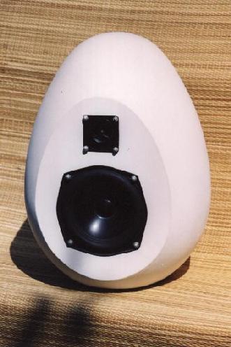

Have you seen the Focal Egg? It was pretty well known in the mid 80s. I have added a pic of a more modern version maybe this with a hidden subwoofer (I have also added pictures of credanzas that can accommodate a hidden subwoofer).
