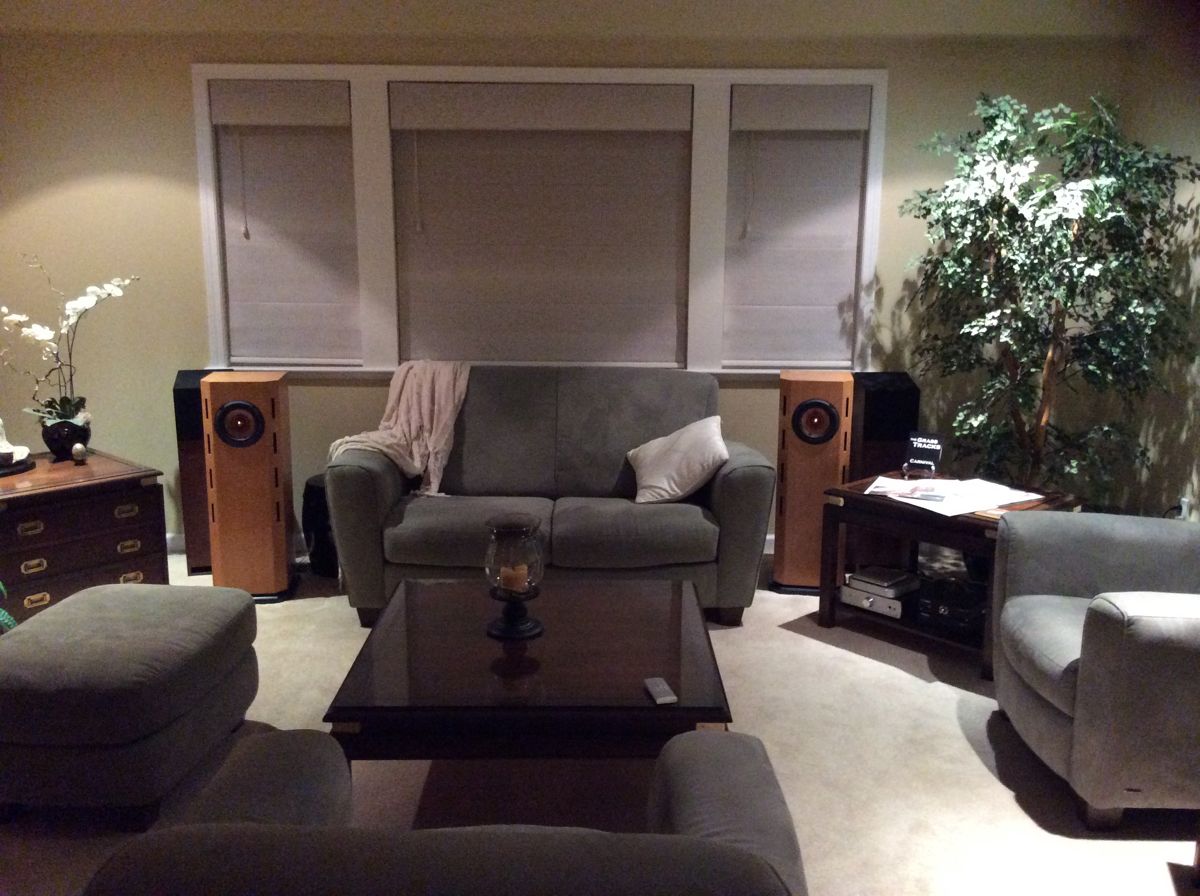

no treatment will change the fact that your speaker are on the wall. I have experienced immense difference by having the speaker around 3 feet minimum from the backwall. I beleive that it is, for hi fi, quasi obligatory.
I'll have to find a way around that. As there is no way of getting more than one foot of distance in our living room. There are a lot of on-wall speakers, are you saying that none of them will produce something that can be considered hi-fi?no treatment will change the fact that your speaker are on the wall. I have experienced immense difference by having the speaker around 3 feet minimum from the backwall. I beleive that it is, for hi fi, quasi obligatory.
/Anton
the distance of your speakers from the backwall is critical for many things, like soundstage, bass perfromance, ect.I'll have to find a way around that. As there is no way of getting more than one foot of distance in our living room. There are a lot of on-wall speakers, are you saying that none of them will produce something that can be considered hi-fi?
/Anton
Its all well known facts and documented, look around. I used to not care much about speaker placement, but after experiencing with this, I was shocked how much difference it makes to have your speaker to optimal placement. The optimal speaker palcement is 5 feet from the back wall, if you go under 3 feet, I have personnally noticed huge difference in bass performance and soundstage and imaging performance.

sorry came in late on this thread- is this about designing wife friendly cabinets? quite a hard task.
.... The optimal speaker palcement is 5 feet from the back wall, if you go under 3 feet, I have personnally noticed huge difference in bass performance and soundstage and imaging performance.
I agree with this but most of us cannot have speakers however small or large 1-2 meters away from the rear wall. Sensing this, some 30 years ago Polk realised this and in fact designed speakers with a bass response that allowed them to be close (less than 6") to the rear wall. I believe they were called the SDA series.
As DIYers we have the ability to tailor at least the frequency response of the speakers we build to accommodate the location and room they (the speakers) are living in.
That said bringing the speakers out into the room does help imaging depth as well. For this there is no real solution (if the speakers are flat against the rear wall).
