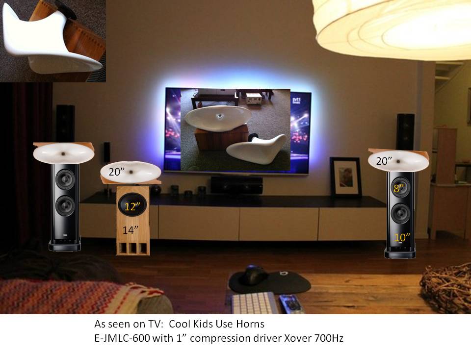

ONNI,
Think about extending your woofer box to a full speaker box with :
1) physical time alignment of a midrange and a tweeter(dome or compression driver + waveguide).
2) edge diffraction control
3) controling the polar response of against-the-wall speakers
Andrew,
The cool kids snuck a waveguide into your E1.
Your TAD E1 speakers use a coaxial tweet-midrange where the midrange cone controls the tweeter polar pattern as a waveguide.
Measurements illustrating the cone's polar control are here: TAD Evolution One Loudspeakers : Castle Hill Hifi
TAD: "Coherent Source Transducer – For highly improved imaging and a more consistent sound throughout an entire listening room, TAD’s Coherent Source Transducer (CST) was designed with the tweeter diaphragm mounted concentrically within the midrange cone. This design provides a point source of sound from 250 Hz to 100 kHz, enabling matched arrival times of midrange and tweeter sounds." "TAD's signature Coherent Source Transducer (CST) coaxial driver uses a 5½" magnesium midrange cone surrounding a 1 3/8" beryllium-dome tweeter. "
"The plot of the Evolution One's lateral dispersion, referenced to the response on the tweeter axis, indicates that the on-axis peaks and dips in the high treble tend to even out to the speaker's sides. The radiation pattern is commendably smooth and even through the midrange and low to mid-treble, something that always correlates with stable, well-defined stereo imaging.
The dispersion is also even and well controlled in the vertical plane, a benefit of the coaxial midrange-tweeter arrangement."
Linesource......Cool kids don't put horns onto my TAD E1 speakers ;-)
Andrew
Andrew,
