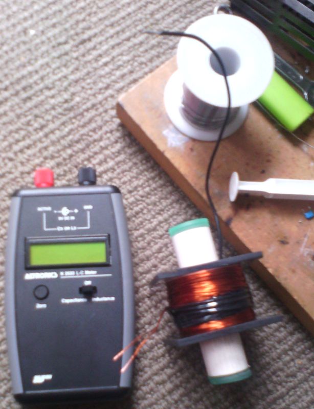

"Using my old rule of 1:1:4 (which may not be best)"
We will see. I like my own rules... Probably crash and burn, but learn something along the way!, possibly ???
"I wrap thick cotton/nylon thread in blanket stitch to help hold the turns together."

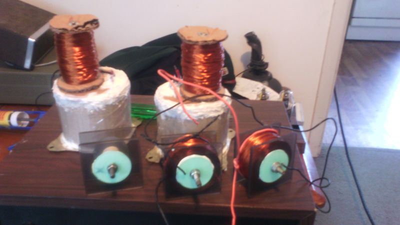

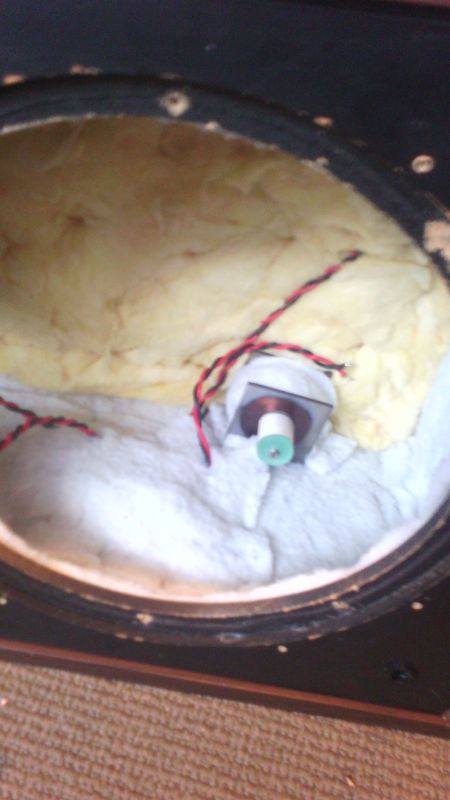

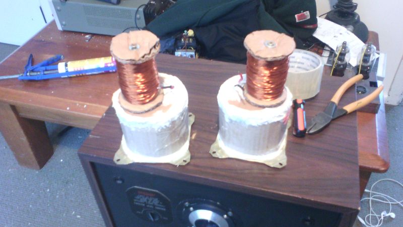

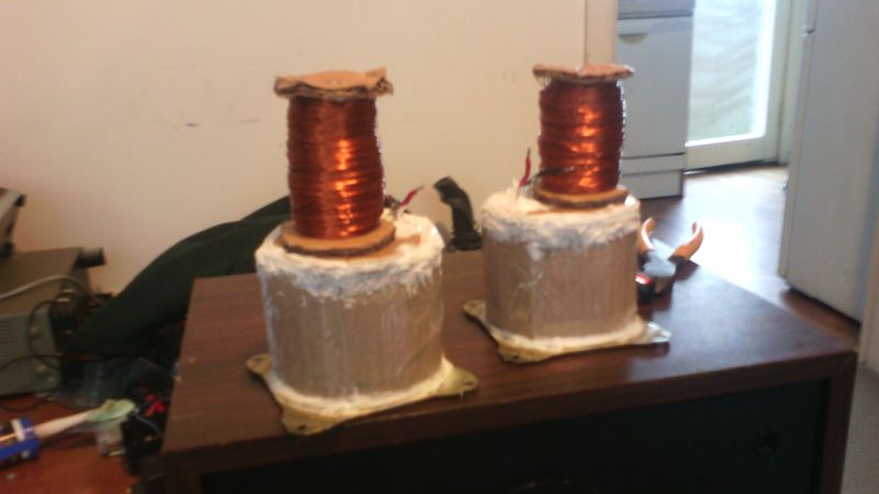

I nursing windings. Those little puppies can be rubbed against bricks. Sharp obstacles for us sensibles.. Producing inductors is fun. Should be undertaken and understood. Make one, stuff that up and learn but think about previous goal and move on...

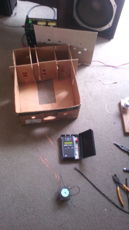

I measured 2.48mH. I require 2.54mH, so not bad! I need to wind on some more windings.
I had a bad thought that paralleling two inductors in parallel would half the inductance. My theory was luckily incorrect!
Also, DCR is 2Ω per winding. Paralleled up equals 1Ω (measured). This is a tad high. But acceptable as 60L cabinets with 12" drivers is not so good living with neighbors close by... So Z = 8Ω + 1Ω DCR in series. I might have to attenuate mids and tweeter somewhat. As I run .FLACs from my PC, I can use digital eq.
Total weight is just under 300g.
With our 12dB / octave designs, I may have to use thicker wire. I will provide photo of my mates 6 foot high home-wound NZ hardwood speakers and also mine (old Philips ones) at later date.

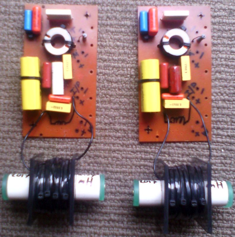

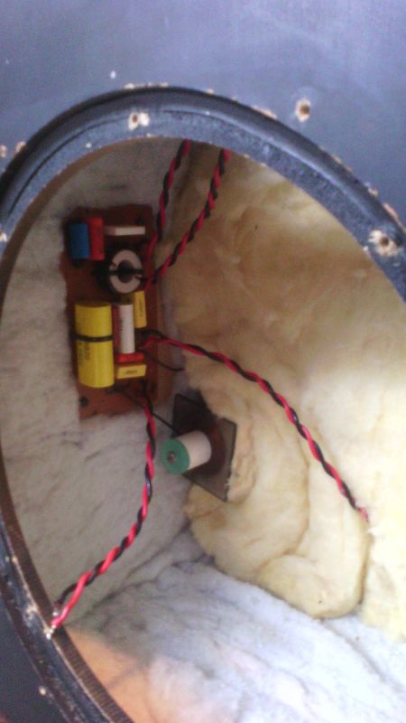

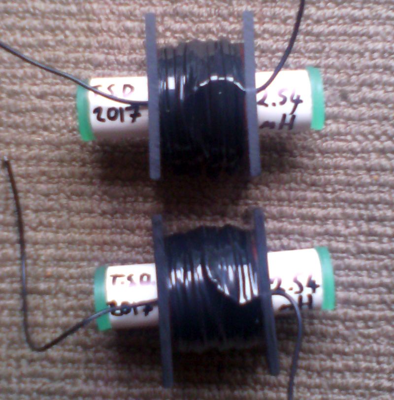

Congrats, they look good. Truly DIY.Completed inductors. They are both 2.54mH and WELL within ±1%.
Must be nice to know you can change them at will, without a 1 wk delay and shipping charges.
Hey DonVK! Thanks. Yes, shipping charges, GST (tax), not made in China (as opposed to NZ!), and My coils are spot on in inductance.
I may have to wind with thicker copper though.
Final dimensions are 27mm former, 35mm wide and 0.8mm copper windings (x 2 to make 1.6mm dia.) are about 14mm deep.
I might mount the board and inductor to a sheet of ply and screw it to inside of cabinet. Finally I am going to line all inside panels with stuffing from an old duvet and use some yellow glass fiber insulation that was installed previously. When I stick my head into the 60L cabinets and yell, there is a $hit load of echo. Hopefully they will sounds good!

I buy sheets of this stuff for proto PCB work. You can cut it to shape, solder to one side and drill it easily for mounted components. The only place I can find large sheets is HK.Hey DonVK! Thanks. Yes, shipping charges, GST (tax), not made in China (as opposed to NZ!), and My coils are spot on in inductance.

Thanks DonVK, yes Yuor prototype boards are looking good! Loop the legs of heavy components thru the board for extra support... I intend on getting my act together and make circuit boards. I have all them chemicals for photo etching. I just need to buy some lamps and mount inside an old flatbed scanner!
I like the sound of my 6dB board so far. I will build some 12dB ones for myself after completing my mates speakers...

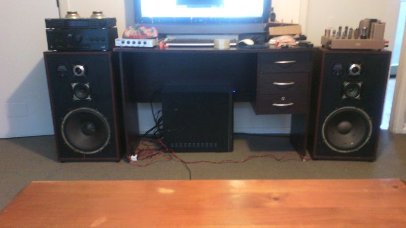

Here is my setup being tested (sort of). Still some work to do. Boy it sounds much better! I want to crank it...

Looks like you have some vintage gear. Do you collect? or resourceful 🙂Listening to some good music and allowing ears to adjust. Close eyes and focus into different instruments. Sounding real good... (Not quiet finished yet).
"Looks like you have some vintage gear. Do you collect? or resourceful"

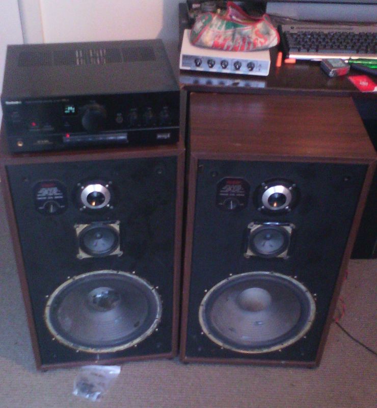

A bit of both really. I bought the Technics SU-X120 near new back in I think 1995 for $650. This included EQ, Tuner, Single CD player, double tape deck (anyone still use tapes?!). The bloke I bought it off of bought it from new. his misses told Him off for buying it and told Him to sell it! (I wonder who wears the trousers in that relationship?!)
The Technics amp is not standard. I upgraded the mains wiring and also wiring between reservoir caps and trannie (they used $hitty ribon cable!) and between caps and power amplifier IC. I also bypassed all the electros in the audio path and also bypassed all the power rails etc. These mods made a big difference! The amp no longer clips so my speakers are also MUCH happier! DC regulation is much better and more importantly, p/s is of much lower impedance.
The Leak Stereo 20 I got given (!!!) in non working state. i replaced all the caps with film types and upgraded all the resistors (carbon and gone high in R) to film types. I modified with a front end R attenuator to work at line level. Sounds bloody great! Uses all the original Mallard valves too!
Speakers I bought, probably in '94 or '95 for $100. I bought pair of 50W 12" speakers for it (another $120?) and they melted 🙂 (I think it was Smashing Pumpkins - Quiet). So I bought some 100W speakers. I upgraded the mids from old computer speakers (resourceful) and bought pair of Fostex FT15H tweeters 2nd hand for $10, I think. I stuck pair (x4) rubber feet beneath speakers.

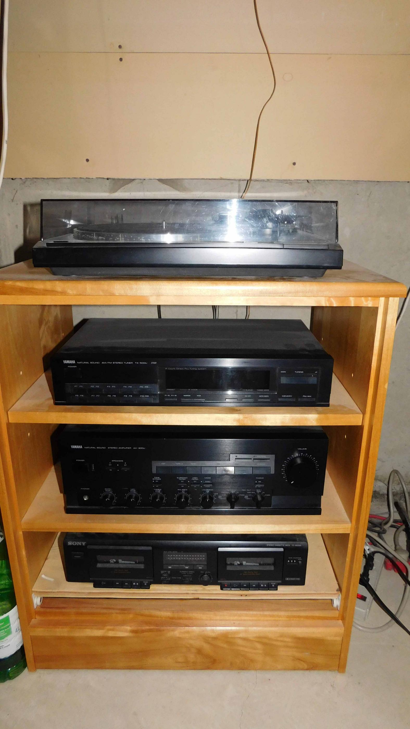

For my Omni project I use a Yamaha RXV659. I connect a PC to it, using COAX with SPI/DF, sending PCM to the AMP which has 24b DACs. I'll use >256MP3 or FLAC and 16bit @44Khz is sufficient for me. I can barely tell the difference on the higher bit rates or resolutions.
This is my 80's setup. I also have a 90's setup and early 2000's setup. They find there way into different rooms in different configurations as I see the need. I still occasionally use LP or Tape, but mostly it's digital as it's just too convenient now to load a playlist and enjoy. These Paradigms are old but probably my favourite, they are flat +/-1.5db even 30deg off axis. I don't believe you need to spend a lot to get good sound, it just needs to sound good to you. I've seen people spend way too much and it doesn't sound any better to my ear.
In the one picture (beside speaker) there is a grey floor lamp. The 1/2" steel tube from that lamp(s) are used as support posts in my Omni project. Pretty ECO green, eh?

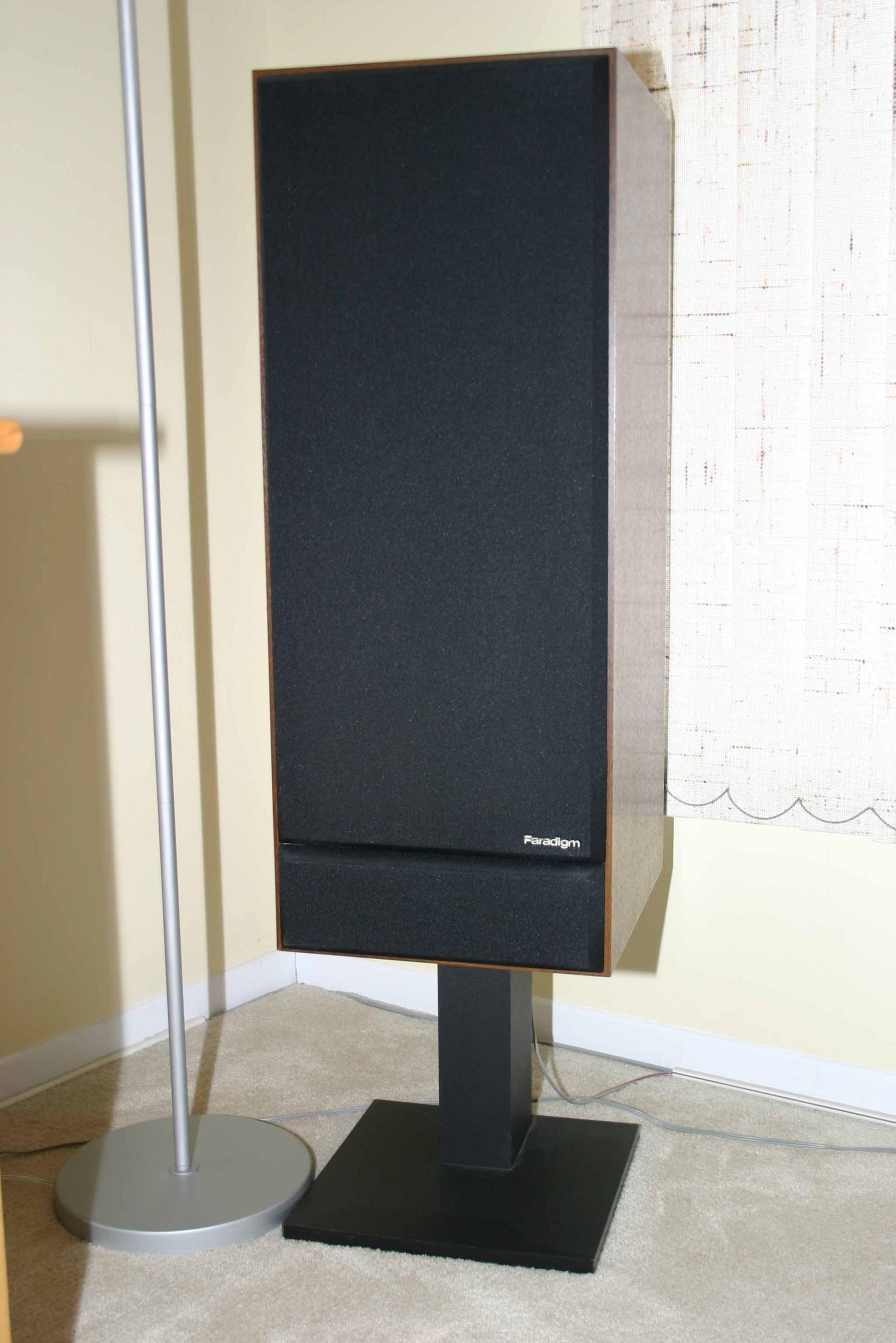

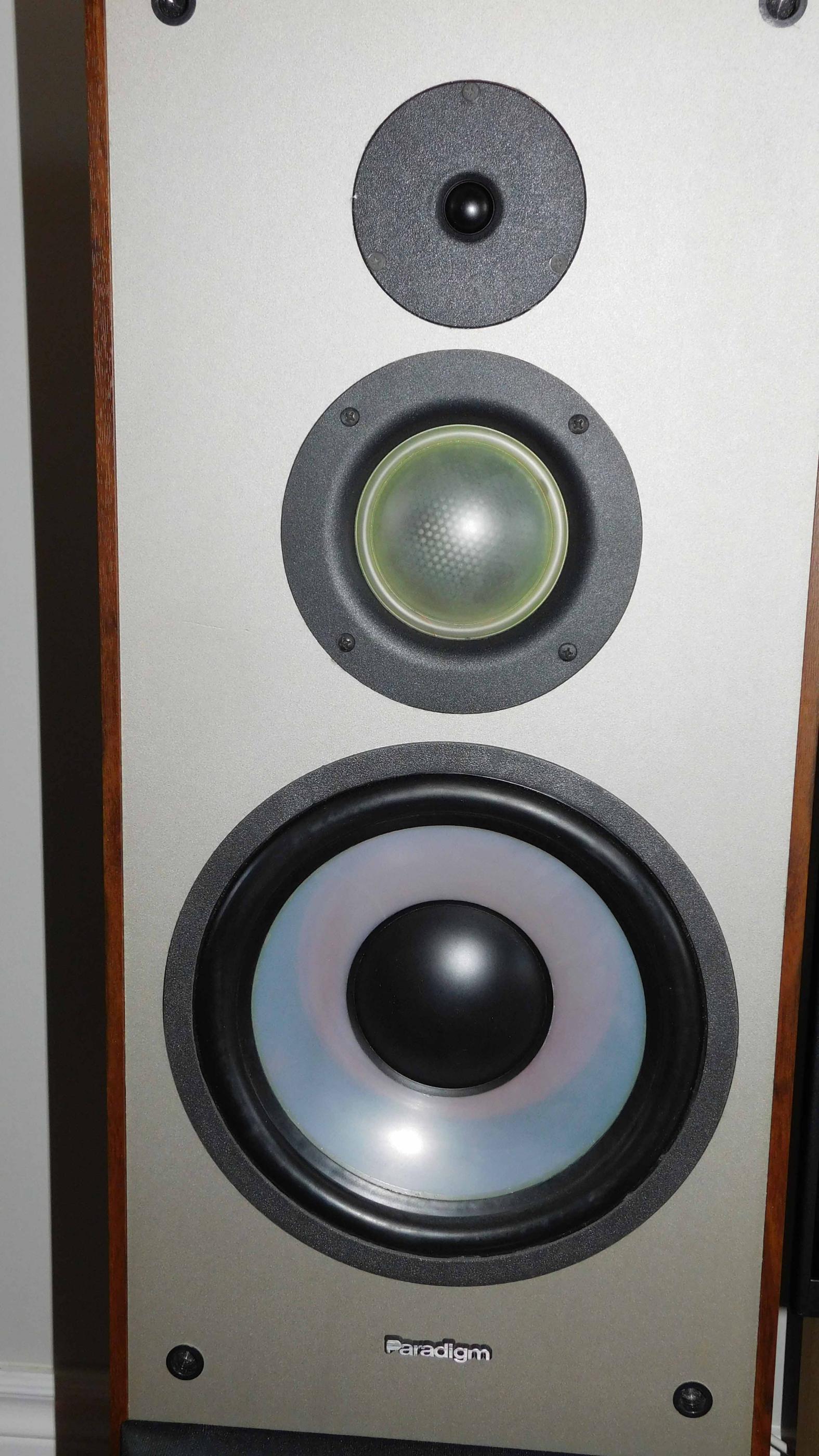

"These Paradigms are old but probably my favourite, they are flat +/-1.5db even 30deg off axis."
Wow. That sounds real nice. 1.5dB is really good! So, 30 degrees off axis is to do with how they sound when not looking directly at the front of the speakers, right? I am flanked by my speakers currently at my desk. When I sit on the couch, they do sound different.

"support posts in my Omni project"
Tell me more! Thanks for providing photos of your '80's setup. I have not yet played about with coaxial (spdif) much personally yet. I understand the benefits!
Oh and just a though. I hear of people "running in" capacitors. How the heck does that work?! Running in one's own ears (brain) perhaps? Thanks.
The Yamaha RXV659 is the system I use from the early 2000's. Its part of my 5.1 surround system. It's in the room with large dimensions that I use for my Omni tests. That's why I can connect it to a PC and it has built in DACs.
The 1980's system, pictures that I posted, is fully manual, no remote, no DACs, all RCA jacks and line voltage inputs.

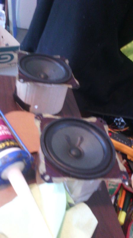

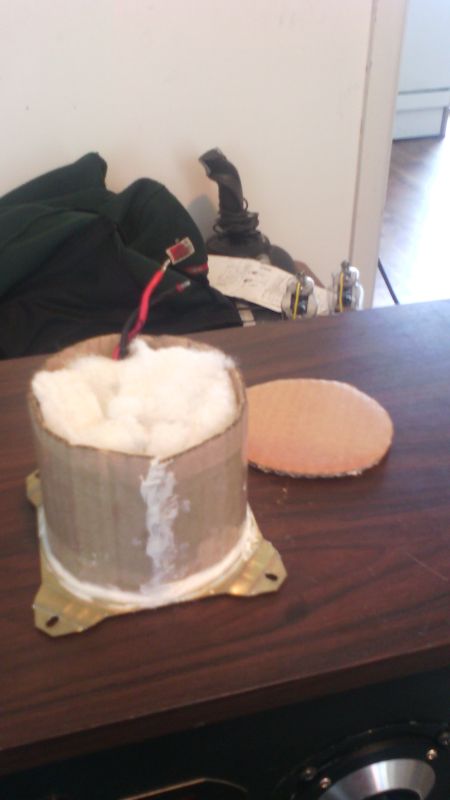

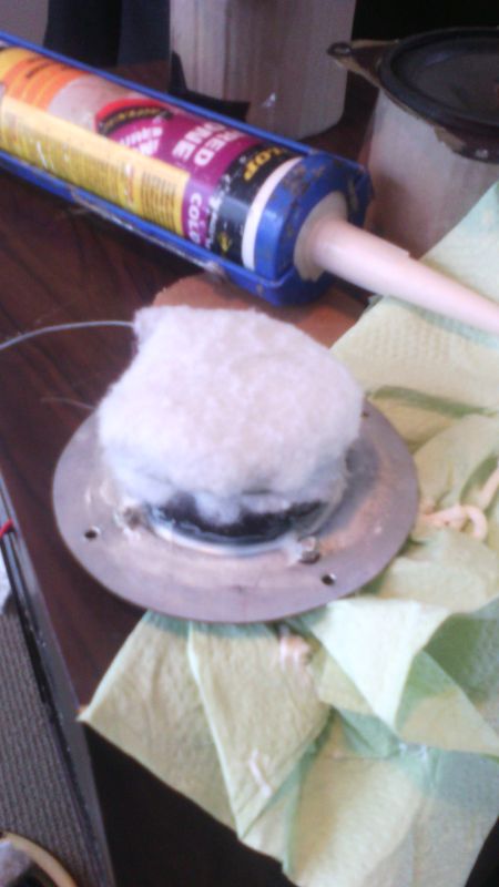

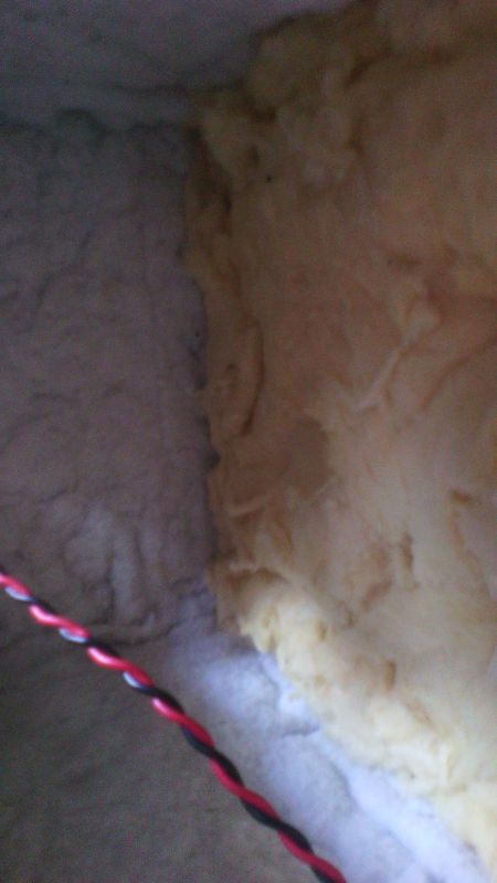

Progress. All I have to do is mount the mids in their cardboard pods into the mid holes. Bit tight so I will have to cut them out a bit, which is no problem. Just a bit of a PITA.
You will see my new inductors sitting on my speakers. I have made 1.8mH and 3.6mH ones for my bud's 12db / Octave speakers. Photos of them soon!

And the rest... Part 2 of 2. Thanks... Just need some 6mm s/s bolts for the inductors. Iron is no good 🙂 I wound 3 x turns of 0.8mm wire for the series 1.8mH. DC resistance was <1Ω. The shunted (parallel) 3.6mH was wound with 2 x turns of 0.8mm wire with DC resistance of about 1Ω2. Both coils are about the same physical size. Interesting, n squared! Works for me!
The cardboard spools is just 0.8mm wire stock...
