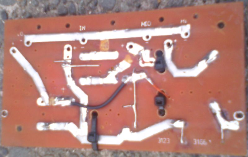

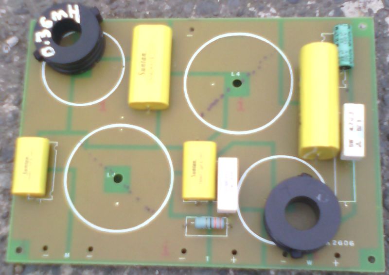

One thing that is often forgotten when using a printed circuit board where the inductor lays flat on the board itself and there is a circular path for current to flow in the copper on the opposite side to the inductor a loss of inductance will occur.
The copper in such a case will represent a short circuit'd winding to the inductor, particularly at high frequencies. How much of a loss ?
This is an excellent point. I hadn't really looked at the board. Apart from the shorted turn issue, mounting several inductors pancake flat to the board can also cause coupling between them. How important this issue is may perhaps be debated. Best to do some searches and see if you can find data on inductor crosstalk or inductor mounting orientation. Even better to test it yourself.

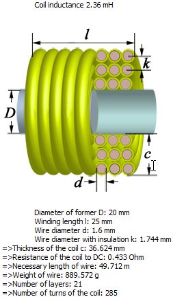

I punched some numbers in and realise we may need to use thicker copper wire! Might make some up from 2 x 20AWG conductors in parallel for $hits and giggles. I am guessing just the bass and mids will be attenuated slightly.
We will space inductors further away from the tracks using ply-wood.

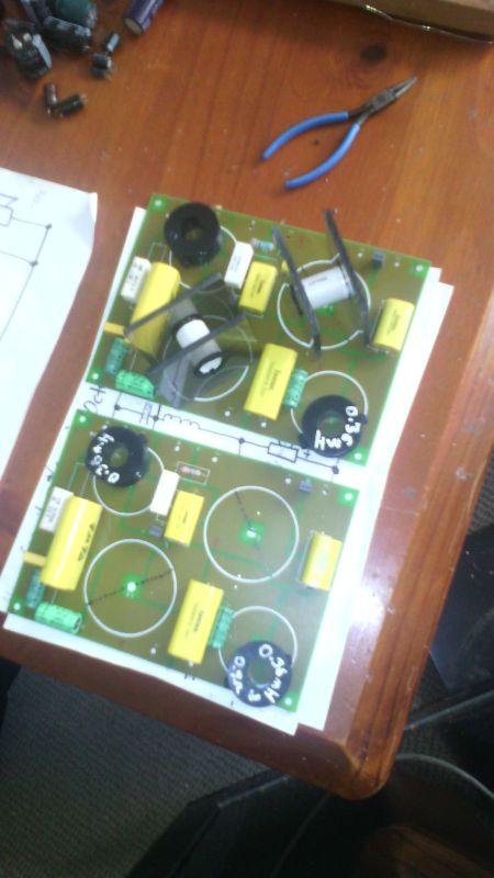

Anyhow, I have built my 6dB boards up. They were 6dB, but with iron core inductors. I have recycled them (Mr DonVK will like that!). I intend on mounting the 2.54mH inductor remotely, away from the PCB via flyleads. No issue with cross-talk between inductors then!
For 40uF (for mid-range), I paralleled up 2 x 10uF to make 20uF, 2 x 6.8uF, 1 x 4.7uF and 1 x 1uF. Looks a bit messy but better than $hitty electros!

Below are photos of near completed 6dB board (I know it looks rough!) Also, th 2.54mH inductors will be mounted to side of speaker cabinets with fly-leads.

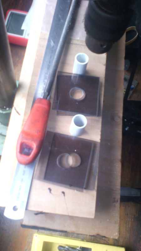

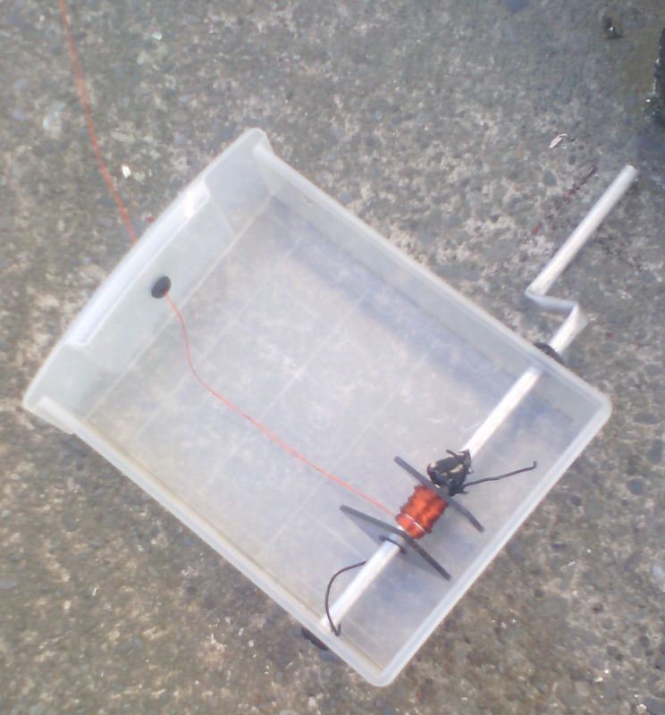

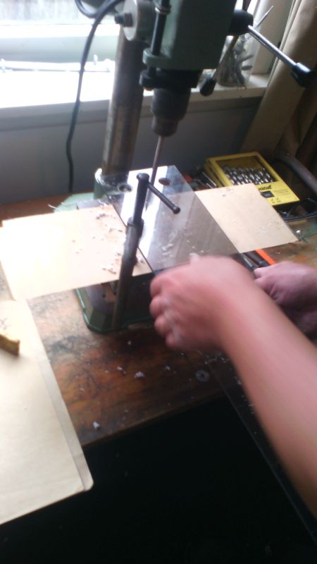

Not a complete success but not a complete failure either! We decided to use square perspex for the sides as this will make it easier to mount AND cut.
I discovered that MS is not good for gluing perspex to the 20mm O.D. PVC (no $hit). I will use Araldite epoxy (EE's never listen to your builder buddy's advice!..)
I am using recycled 0.8mm wire and am doubling it up with mild twist in it to hold it together. This makes 1.6mm over all diameter. Calculated total resistance is < 0.5Ω, so within my desired tolerance.
My winding box however works, miraculously!
Wires are fed thru rubber grommet. Propulsion is 'Armstrong' method. The blinking %$@#$% sides fell off as the silicon is rubbery...

If you put a paper tube + tape over your winding rod (before winding) it may be easier to remove the coil (slides off) after its wound. It would also allow you to temporarily tape the square sides to prevent coil egress as you wind the coil.

Good idea! That way paper tube locks spool in place (I used PVC insulation tape in a pinch with poor results!) and is easily removed.
Egression was symptomatic. Basically the perspex squares fell off. I expected no less as I observed very "floppy" sides! I dig that (non stretchable, paper tape) could be used to keep form. Good thinking 99! Afterwards, coil could be contained with cable ties.

Using your 20mm bobbin set the width cheeks about 10mm apart.
Now wind on your inductor till you reach an outer diameter of 40mm.
Thus you end up with a 10mm long inductor that is 40mm diameter and the cross-section of wire is roughly 10mm by 10mm.
You will find that this 1:1:4 coil height : coil length : Overall diameter gives very close to the minimum resistance for the inductance achieved, i.e. highest Q value. eg. using 1mm diameter wire wind on 10 turn per layer and use 10layers for a total of 100Turns.
Using a smaller bobbin diameter will result in a higher resistance, no matter how you change the height and length and number of Turns for that 1mm wire diameter.

Andrew T see post # 48 of mine. Basically I am using 20mm diameter former (pipe) and spaced "cheeks" at 25mm. This gave lowest DCR (resistance) according to Coil32. As Mr. DonVK stated, I'd like to know final DCR myself! I hope it will be < 0.5 ohm (DC) as this is in series with 8 ohm (impedance) woofer. This resistance of 0.5 ohm will need to be factorised. Obviously this will attenuate the woofer somewhat. I already know that my woofer is less sensitive compared to my mid, and especially my tweeter! so low DCR is very important, otherwise I will need to attenuate mid and tweeter quiet a lot, thus lowering efficiency of my 3 way speakers!
"You will find that this 1:1:4 coil height : coil length : Overall diameter gives very close to the minimum resistance for the inductance achieved, i.e. highest Q value. eg. using 1mm diameter wire wind on 10 turn per layer and use 10layers for a total of 100Turns."
Interesting. I will dial this into Coil32 and see. I of course need 2.54mH, so I may have to fiddle with the # turns p/layer, I guess?

Mine (Ours) will be 37 : 25 : 94. I don't feel like simplifying that ratio too much! (My poor brain), but according to Coil32, this is best. I factorised spacing of "cheeks" into software, with constant of 20mm "tube" O.D. Software churned out highest 'Q' (quality baby!) with said ratio...
