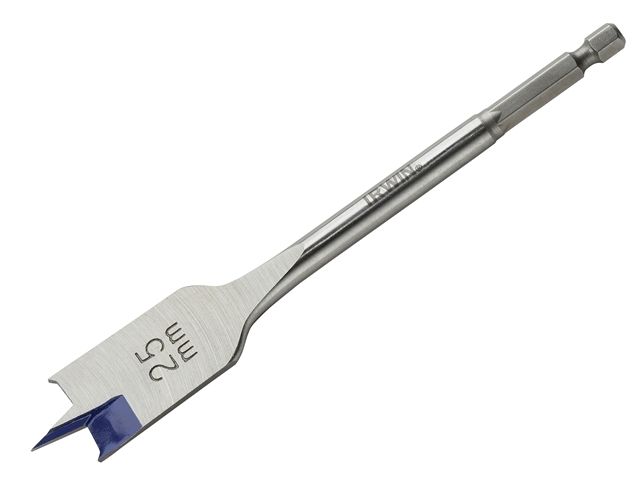

We used bit like this in drill press to cut out 20mm hole into perspex sheet before we cut out each square with hacksaw...

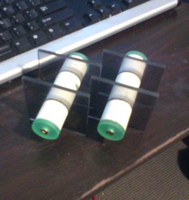

We struggled today to wind inductor without sides self destructing (tight coil wants to force sides outward. Unexpected, to say the least...). So I chose method using dowel (nobody will miss the broom!) and some larger diameter PVC pipe (27mm). This method clamps the former together WITHOUT glue, although glue will be used! I chose to use steal screws, screwed into the dowel. The screws don't penetrate (much, -they don't enter the coil zone, but probably will interact). this is why the ends stick out! The end washers (homemade) clamp the lot together. Hopefully you guy's can figure out how I accomplished this by the photo.
I intend on mounting the inductor inside the cabinet to the wall, as my xover boards are too small!
What do you guy's think??? ps. I was thinking about replacing the two screws with brass ones. Would that work better? Also, I intent on using this point to make some brackets up, may be out of alluminium sheet. then they would serve two purposes!
pps. I like your jig to manufacture inductors Wolf! Very crafty!

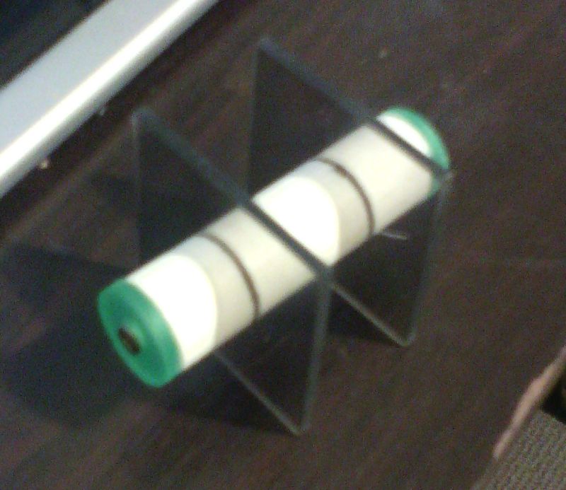

The twin is born. These puppies are vastly superior design. Call them the mark 3. got to wind 1.6mm diameter copper wire on next... Don't even need any gluing.
Very happy. DIY! (I hope they are big enough!)

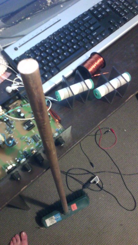

Some reclaimed copper conductor on spool and my new bass processor shown to the left (home wound. Modified Jaycar kit). My poor broom will pull thru all this abuse though!
Kudos jrh0516 (wooden doweling).
Inductors total cost = $0.
