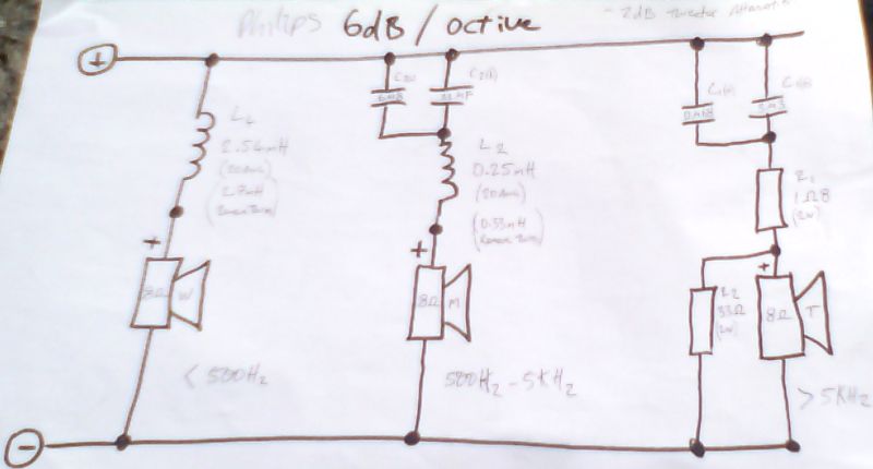

I was reading resistors of approx 1Ω to about 4Ω7. So it looks like I will be using w/w resistors afterall. I have spaced them off of the PCB so as to allow them to not get too hot or resistance will increase.
I am using a 33Ω resistor as part of tweeter attenuator (simple potential divider circuit for -2dB). I will measure that resistor as I presume it will have more windings. I guess higher wattage resistors use thicker wire and possibly less windings (? probably not less windings though).

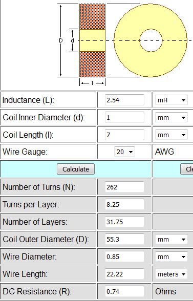

That calculator uses this formula
currentInd = ( diamavg / 1000.0 ) * diamavg * turns * turns / (( 18.0 * diamavg ) + ( 40.0 * coilLen ))
Generally such a simple formula will make assumptions on coil proportions that do not include a 1mm core and 8turns x 31layers
The only references I can find to coil formulas using 18 and 40 are for single layer coils, so that calculator is probably bunk.
I plugged your values into a calc I wrote and got <1mH, but about the same resistance calc.
For a 20 gauge ~2.54mH coil I get:
263 turns
Core Diameter 1.1604 inches
Coil length 0.5526 inches
Coil Diameter 2.1551 inches
Wire Length 1369.72 inches
Wire Length 114.14 feet
ohms/inch 0.0008
resistance 1.159 ohms
weight 0.36 lb
Feet and inches eh? !
I was wondering if the calculator I used was a little bit dodgy. Images I have seen of coil shape all seem to look like Brooks work.

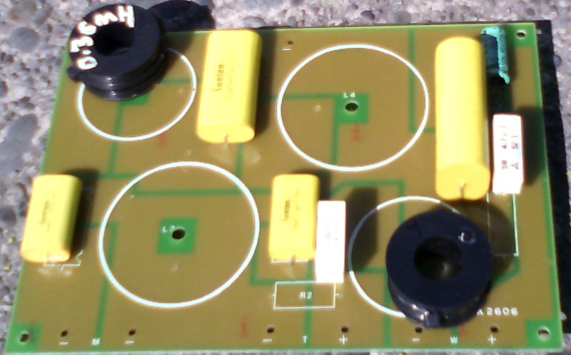

I am kind of trying to keep coils O.D. at 60mm (2.36") due to PCB size. This is for the 12dB/Octave boards. This board calls for 1.8mH and 3.6mH inductors for the LP and BP respectively. I am also designing a 6dB/Octave board for myself. This uses a 2.36mH inductor for the LP. I really should at this point upload photo of my boards...
Below is photo of the 12dB/Octave board / circuit and 6dB/Octave circuit.... (I also intend in preventing as much as possible cross-talk between coils. I will mount out of plane as much as possible (at right angles).

One thing that is often forgotten when using a printed circuit board where the inductor lays flat on the board itself and there is a circular path for current to flow in the copper on the opposite side to the inductor a loss of inductance will occur.
The copper in such a case will represent a short circuit'd winding to the inductor, particularly at high frequencies. How much of a loss ?
I just happen to notice the indicated placement of a large coil on your printed circuit board. Best to stand it in a vertical position I would think.
C.M
Thanks Ron E! Did you write that calculator?? I will punch some numbers into it after tea...

Interesting. I wonder how much difference that would make? I guess my trusty inductance meter (Jaycar / Silicone Chip) could measure it? Also, I'd be curious how far out the magnetic flux would travel outside of the coil? (I have seen the images of where the flux lines occur). This would not be much of an issue with iron core inductor, as field would be circulating much closer in. As I have not soldered the 0.36mH inductors in place, I could mount above board with wooden or plastic spacers. We intend on using MS (type of silicon) to mount inductors to prevent vibrations shaking the assy. I can't imagine much microphonics being generated in the inductors, but you never know. I may just use MS and cable ties with my one...
But really good point. I think when tuning the 0.36mH ones, I noticed a little bit of a change in measured inductance when measuring after removing turns to fine tune... I think about 0.03mH or so per turn. I realise that the N^2 ratio comes into play though (not as simple as that!)...
So yes, progress. We have obtained some perspex and some PVC pipe for the inner part. I figure we will need to use 18AWG wire to keep DC resistance down, especially for the 3.6uH and possibly the 2.36mH inductors. I might use twin 20AWG wire for my 2.36mH inductors to half 'R'.
I plan on making 6dB / Octave crossover for my speakers first and then a 12dB / Octave crossover and doing an A / B test 🙂
Thanks Tweet.
No, but it is one of the highest quality calculators I have seen. One quibble I have with it is that the automatically calculated insulation thickness seems rather large, but I haven't thoroughly evaluated it.
My calculator uses simpler wheeler formulas, and is reasonably accurate, although something seems a little off with the resistance calc in the example I posted. Another calc I have that works a little differently gives a better value of ~1.21 ohms or so for the same coil.
Most of the calculators online are javascript toys and many are copies of each other. They are easy to plagiarize since you only have to view source on the page to get the code.
