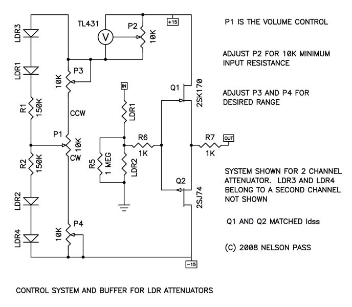

Thanks for your reply! Im afraid the information you gave me is a bit too condensed for a beginner like me 🙁
How do I find out if my phono pre can drive a 10k pot? Trial and error?
Why does the RF interference attenuation of the dr matter in this case?

The 1uF DC blocking capacitor driving a 10k input impedance will roll off the low bass.
I typically aim for CR= 80ms to 100ms at the input of the power amplifier and aim for a full octave below that in the earlier stages.
On this basis, I would use a 10uF MKP or MKT as the output blocking capacitor.

btw: i talked to the guy who designed my phono stage and he said the output impendancenis 10 Ohms. He suggested using a 100k pot or a buffer amp.
i'm a bit confused 🙂
1uF driving 10k gives an LF rolloff at 16Hz. You may or may not find that acceptable; this partly a matter of taste, and partly a matter of which speakers you have and where they roll off. If the 1uF is an electrolytic then you really need 10uF instead, so the cap has very little signal voltage across it at the bass end; alternatively, use a 100k pot instead.
10 ohms output impedance can easily drive a 10k pot. 10 ohms plus 1uF can only drive 10k if you are happy to have some bass rolloff.

i talked some more to the designer of the phono stage and figured out that a 20k pot would probably be ideal. i'll keep the phono stage as it is and in combination with a 20k pot the rolloff should be at 6 or 7 hz.

Less amplification after the pot will reduce noise levels
It won't be any louder but noise levels will be less. Lower resistance will also make it flatter response when driving cables or stages with larger miller input capacitance.
