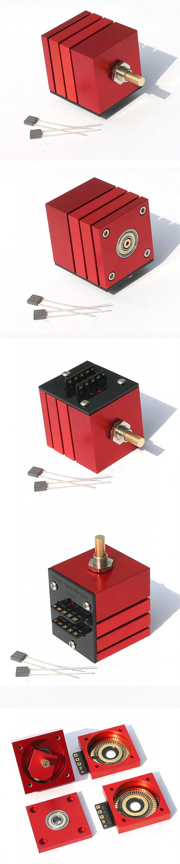

but I want more click stops at low volume, don't I get that with a linear pot ?
and if so, a log version of the Nobel will be worse than the linear I have.
Nope, a log pot gives way more clicks at low volumes.
Remember, a linear pot at the center of rotation is only -6dB.
A log pot at the center is about -20dB.
So below halfway in a pot that turns 270 degrees, there is
much more adjustment capability (135 degrees) below -20dB
than for a linear pot (27 degrees) for the same amount of attenuation.
So it's about five times easier to adjust with a log pot at low volumes,
than with a linear pot.

Why do you say 10k though, and why "usual"? Like I said, the stock pot in the amp is 50k and I'm only replacing it here - I'm strongly inclined to keep it the same value (as I'm happy with it otherwise) unless there's an explicit reason to reduce it with no potential downsides.
I'll wait for your reply, but I'm tempted to get the 50k (first) either way so I can have a variable-free comparison between the stock pot and an individual-resistor'd stepper for future reference. That way if there's any audible change other than improved balance I'll know why.
RE: Grounding, you mean the metal body is connected to the two signal ground terminals?
your initial description led me completely down the wrong path. Just carry on.
No worries. I wouldn't have even known enough to suspect a misunderstanding if I hadn't spent a while reading old posts of yours (and others) on here previously.
Checking back, it seems that the 50k amp input impedance includes the 50k pot, so yes,
using a 50k replacement pot should be fine.

I've been using one of these controls in a secondary system with KEF LS50s for months,
and honestly I have no problem at all with the step size. Extremely efficient speakers
might give a different result, though.
ah, so it's possible to get stepped attenuators with more positions. It seems they are also available in super-duper-cool looking too
24 stepper is expensive if not a cheapo from the Far East.
more than 33steps is very expensive.
Have you looked at the AIKIDO FP from the TubeCAD blog.
https://www.tubecad.com/2006/03/blog0057.htm
The resistor values in the first stage are wrong, but all of them can be changed to give the step values you require.
I set mine up for 2dB steps over the range from -0dB to -70dB
but you could do 1dB steps 0 to -35dB, or 1.5dB steps 0 to -52.5dB
