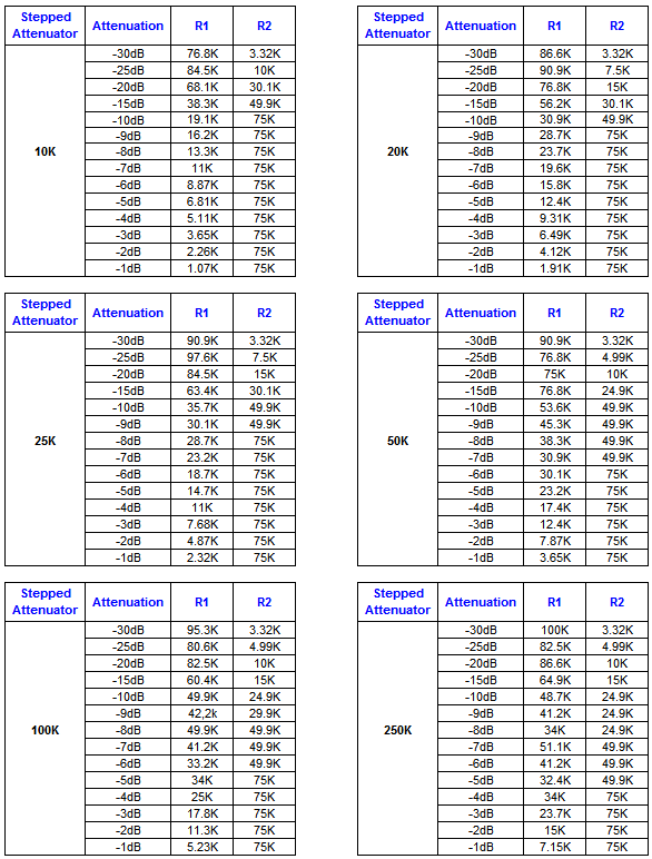

Help in choosing a potentiometer as a "Passive preamplifier"
Update:
Some time doing research seems to suggest that series resistor should be half of shunt. Also series resistor as low as possible, like 33K or less for input to a valve stage. Ideally much less. Found some comments:

34k input resistor value is a bit high. I like to do 50~70% pot value for input resistor value so loudness at 12 o'clock is about the same as a normal pot. Also did the Shunt mod today on my 50k pot tested with 25k and 47k, and 33k has a better control of the volume.
91k to 191k for a 100k pot, 47k to 97k for a 50k pot, 18k to 38k for a 20k pot. I'd recommend going Vishay Z foil VAR (thru hole), VSM (surface mount). It will be well worth the extra.
I have followed the recommendations by Gold Point for this type of adjustment.

I want to ask about a quite different design approach based on the fact that most modern amps have gain settings (mine has 4).
So instead of the full range attenuation you set the amp to the lowest gain and design a stepped attenuator from very low to the volume level you need 90% of the time. When you occasionally need higher volume just change the gain. I think this can potentially improve the sound quality and any imperfections inserted by the volume control to the minimum.
Do you have an opinion on this approach?
In particular, I have 75 Ohm DAC output and 10 kilohm power amp input. I think this is very typical for many people here. What would be the potentiometer value if I need only a narrow range of attenuation? I can certainly add some fixed resistors in line and in Lpad to narrow the potentiometer requirements.
I think that this is an excellent observation and can go a step further by using those special high dollar resistors in the places where they will get used. I am not sure how/where the gain setting is placed in the circuit. I thought that it was at the input but that approach doesn't really change the gain of the circuit, it just reduces the signal voltage. I am interested in knowing more because I have a similar situation that I want to sort out. Seems that many of the preamps that I build have too much gain and I end up with a voltage divider at the input.
