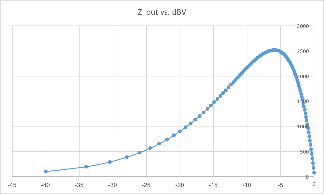

Thevenin source impedance is a general concept, but it is simple in most audio circuits.
For a pot, short the input (top terminal of the pot) to ground. Then calculate the impedance
from the output node (wiper) to ground. That would be the top section of the pot in parallel
with the bottom section of the pot.
The maximum source impedance would be when the pot is set at the electrical center (both sections equal).
Then for a pot resistance equal to R, we have a maximum source impedance equal to (R/2) // (R/2) = R/4.
For a 50k pot, that is 12.5k maximum source impedance.

Here is a graph of the output impedance of a 10k pot. Notice that it peaks at -6dB (electrical half) output.
Recalculating for the two pot values of 10k and 50k:
10k (Zout = 2.5k) + 656 pF = 97kHz rolloff point (you won't hear this)
50k (Zout = 12.5k) + 656 pF = 19.4kHz rolloff (*you may hear this*)
10k (Zout = 2.5k) + 164 pF = 388kHz rolloff point (no-one can hear this)
50k (Zout = 12.5k) + 164 pF = 77.6kHz rolloff (you won't hear this)
20k (Zout = 5k) + 656pF = 48.5kHz (you won't hear this)
A 20k pot might be the best compromise for a 'passive preamp'. It won't load down weak sources as much and it won't cause too much of a HF rolloff with reasonable length cables. No?
