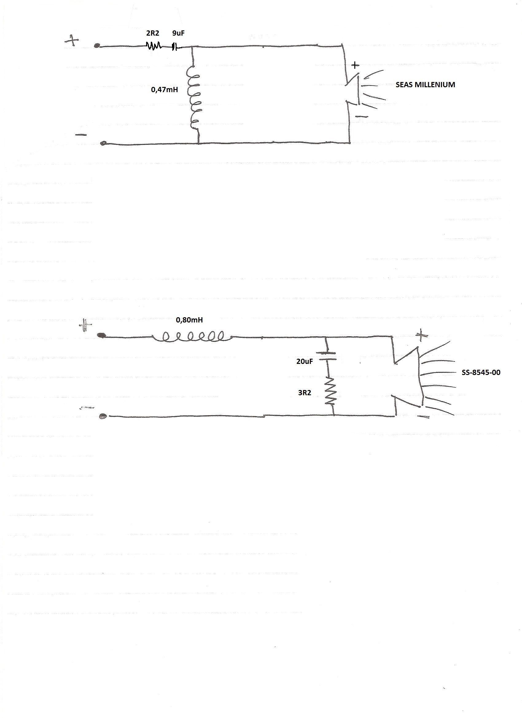

I wanna know if can go active for the 3er way woofer, I own this active filter:
http://www.reckhorn.net/pages/active-x- ... ssover.php
Isnt modified for high voltage output, the question is: ¿Could I use it for the woofer SB Acoustic?
Also I have a couple of pcbs from a GB diyAudio "My Ref Fremen Edition"
http://www.diyaudio.com/forums/chip-amp ... ation.html
First to make the two ampli I want to know if can be enough power for the SB Acoustic woofers?
...woofer SB Acoustic?

I only need advice to know if My Ref. Fremen Edition power amps can be enough power for the SB Acoustic SB Acoustics SB23NRXS45-8 and also if the active Xover http://www.reckhorn.net/pages/active-x-%20...%20ssover.php is ok for the LF Xover for the SB Acoustic SB Acoustics SB23NRXS45-8? If yes after will speak about the cabinet if it's better or not better BR or closed, etec.
The 2 ways & the power amps for the 2way is ok as is.
SB Acoustics SB23NRXS45-8 driver would need >40W RMS minimum in a reflex (driver is 60W RMS) to cover <65W RMS for the SS 18W/8545-00 also in a reflex (driver is 100W RMS).
I don't know the power RMS for the "My Ref. Fremen Edition power amps". 🙂
The problem with SB Acoustics SB23NRXS45-8 driver in sealed enclosure (50L), besides LF extension, is that for the Xmax 6.5mm you have 10W RMS only and a lower SPL output, lower than 98dB/speaker (for the same theoretic ~105dB in the main satellites).

My Ref. Power amps have 40W @ 8 ohms.
That's about what the woofers SB Acoustics SB23NRXS45-8 are going to use per channel (if two drivers) if in a reflex enclosure. That's my modest opinion and I already mentioned that in post#385. 🙂
The (2) mono-blocks Erno Borbely Millenium 75WRMS class A (I'm not acknowledge in this amps) are also enough for a full range 3-way with the same drivers. 🙂
