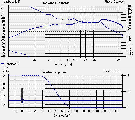

Thanks Dave make sense, how to measure the raw drivers without box?
Sorry - I didn't mean raw drivers out of the box - I meant raw drivers *in* the box assuming your box is similar in dimension and driver placement to another proven designers speaker with raw measurements available.
If you can only measure above 500Hz (as indicated in your gating marker on one of your FR plots above) then baffle size doesnt' matter when comparing your box with another designers. Driver placement and baffle dimensions will affect the ripple (baffle signature) on the response - but again, most 2 way "box" designs follow a very similar baffle size / driver placement on baffle so baffle diffraction will be similar.
All I'm saying (as others have said) is:
1. set mic position and levels (do not change). Set these low enough so you don't blow the tweeter (I make sure the voltage output is <= 0.5v on the amplifier output terminals). you won't need a protective cap on the tweeter (or put a 30uF or larger one on for peace of mind if you insist)
2. measure tweeter in box (gated - but do not move the gate when measuring the woofer)
3. measure woofer in box (gated)
The trick with gating is to set it based on the driver that is furthest away (to eliminate first room reflections). Usually for a 2 way - you will measure on axis to the tweeter (listening height), so set your gate (impulse) based on the woofer, since it is furthest away from the mic.
Are you absolutely sure you aren't changing anything between measuring one driver and another in the box? because your levels are different between the woofer and tweeter measurements in your graphs.
your woofer should measure about 3 - 6dB lower average than the tweeter on average.
So for example - if your reference level (doesn't matter what this is) - shows the tweeter measurement at -15dB, your woofer should be measuring about -21db to -18db on average. your tweeter is more sensitive so you would expect a higher average FR curve
compare the above graphs to the manufacturers, others designs etc....
Once your graphs are within say 10% - you know you are in the ballpark. Any variation will be measurement setup (mic not recording flat unless you have had it calibrated), driver variations, baffle variations etc...

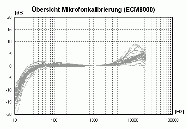

This is a wise piece of advice. AFAIK the tweeter has a very flat frequency response up to 20 kHz, but the measurement shows a rise of 4 dB after 5.5 kHz and a peak of 9 dB at 13.5 kHz. Taking this as reality will be very misleading...
Can be the mic ECM8000?
Yes, it's the frequency response of the mic. You need to install a correction file.
Attached are measurements of the Behringer ECM8000 determined by a german site: 200 Mikrofonkalibrierungen - eine Übersicht
