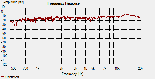

Hi Bob,
Attached is the measurement of the tweeter on axis at 50cm from the driver in box without filter, what kind of filter will you use? will be necessary notch or zobel filters?
TIA
Felipe
The peak at about 13kHZ will color the sound a bit, but the response is generally relatively flat. I would just use a high pass crossover filter on it and see what it sounds like before playing with EQ filters. You'd have to measure the impedance of the tweeter at 13kHZ, to know how to calculate the part values for a Zobal filter, if you wanted to deal with that.Hi Bob,
TIA
Felipe
I take measurements above about 10kHZ with a grain of salt, since the wavelengths of the signal get so small that the slightest misalignment of the microphone to the tweeter can make a big difference in the measured result, plus not all "calibrated mics" are as accurate up there as they often lead you to believe (the Behringer mics for example).

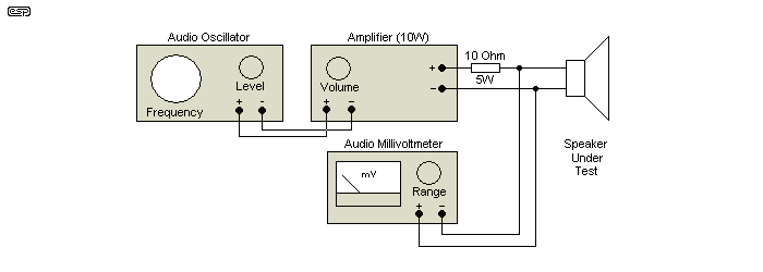

Yes Re is voice coil resistance, I measured the drivers following Elliot sound pages so function generator 10 ohms resistor & true RMS DVM.

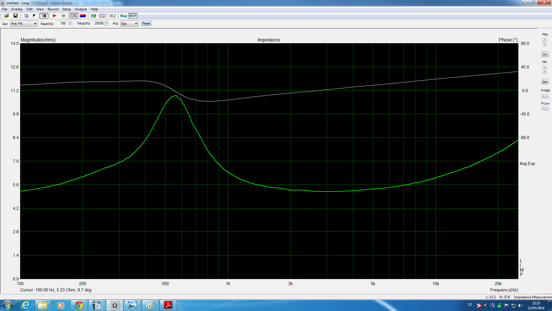

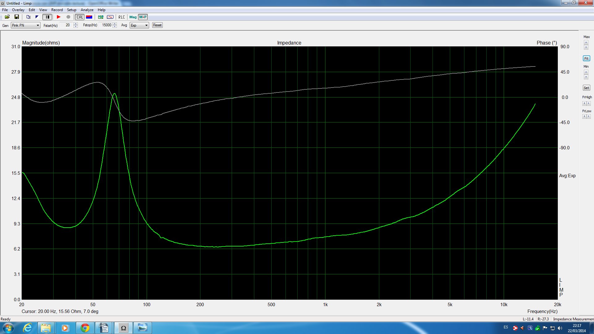

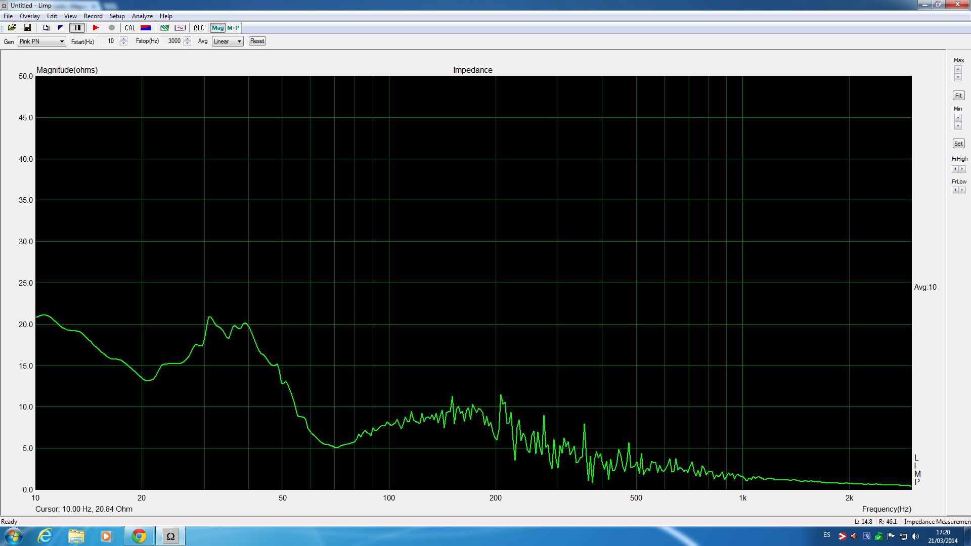

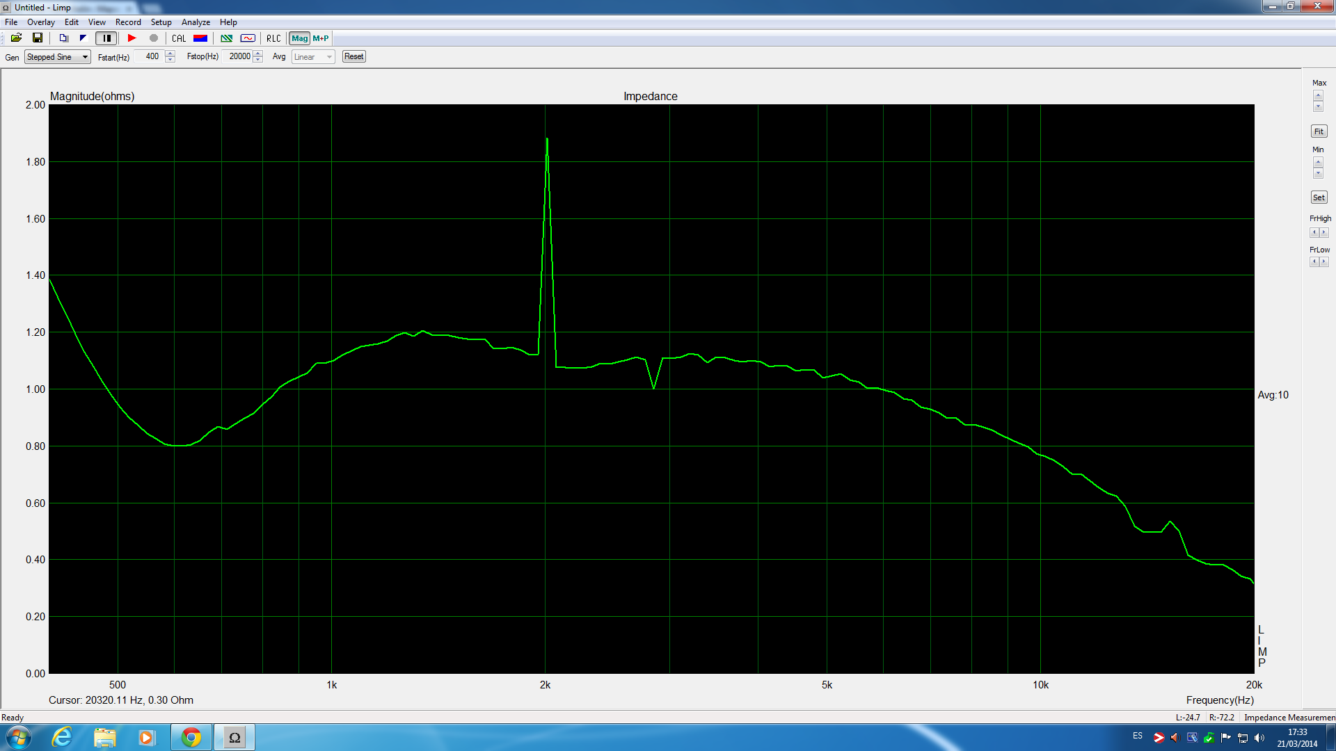

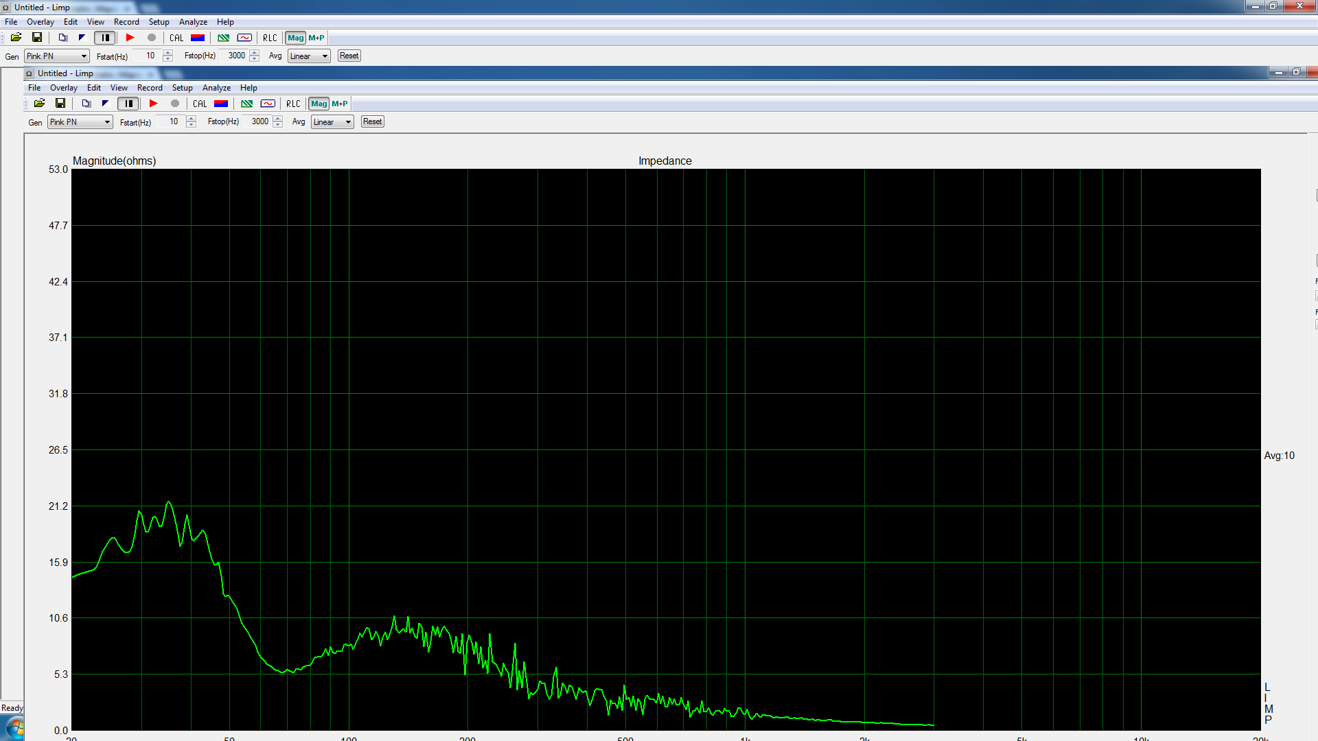

Limp measurements 110 ohms resistor
1st pic SS 18W-8545-00 left
2nd pic SS 18W-8545-00 right
3rd pic Seas Millenium left
4th pic Seas Millenium right
Attached new measurements, 1st pic SS-18W8545-00 left channel, 2nd pic SS-18W8545-00 right channel, 3rd pic Seas Millenium left channel and 4th pic Seas Millenium right channel. I guess now are OK🙂
Post 377 with measurements done with 100 ohm reference resistor, how I to proceed with the information to make my xover?
