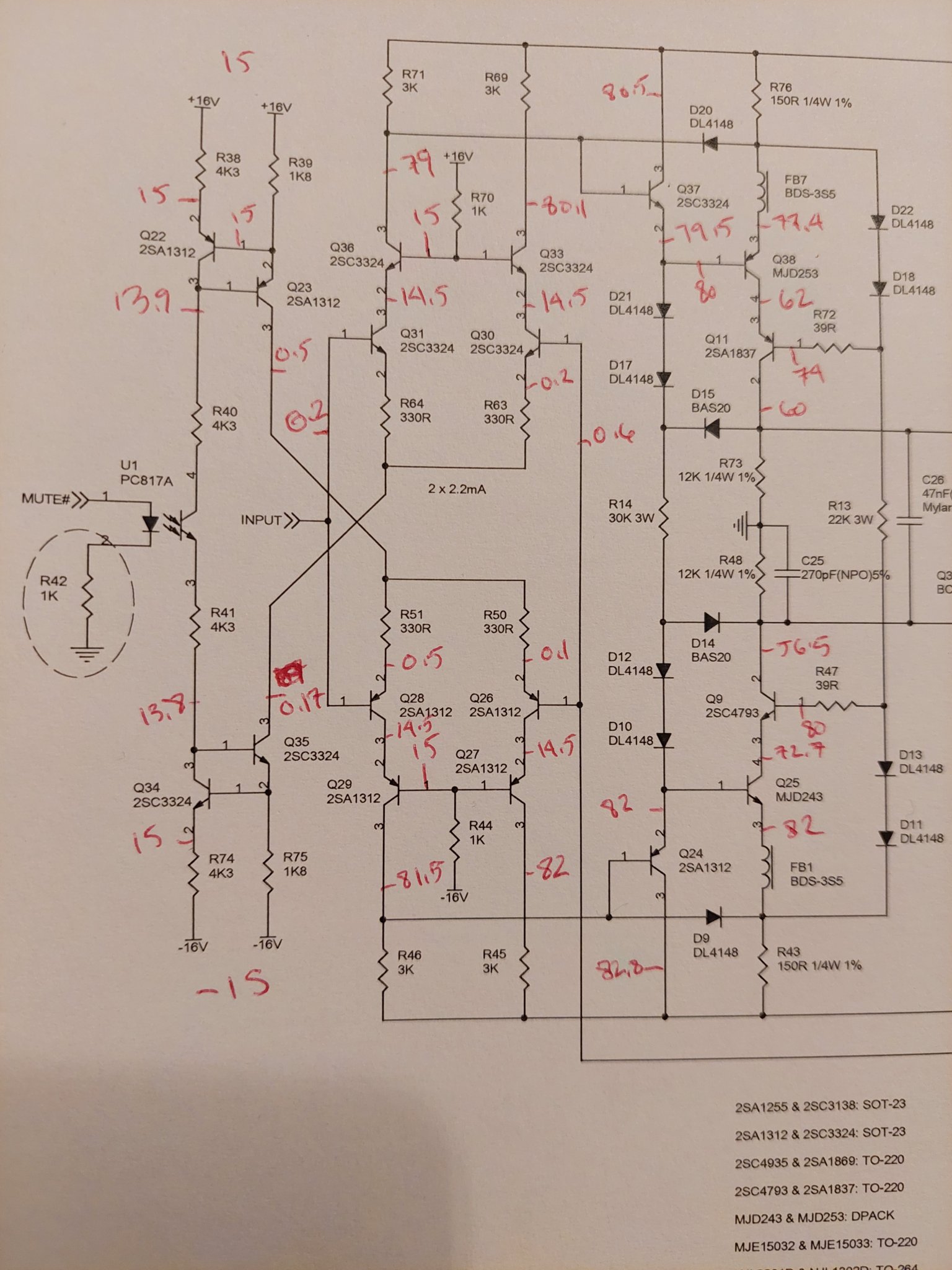

If you're seeing 0.5V at all four resistor pads, the defect must be along the trace that should connect the "ground" pad of R57--- but isn't. Said differently, all four resistor pad show conduction to the base of Q31, so the open has to lie somewhere beyond the ground pad of R57, "north" of the R57 symbol on page 108.
I checked continuity between R57, R58, C28 and pound 1&3 of J1. All good. To make sure J1 digital ground was complete, I installed the amp assy into the case so I was able to install J1. I checked TP4 as a reference and it hasn't changed from the 35V as before.
Looking at the measurements in post #138, I'm curious where the extra 2V comes from at R50 & R51 junction, Q23 collector and Q26 emitter.
Something still is not correct. Connect black meter lead to speaker ground. Probe path from Q31 base along each pad of R58 and R57 toward the ground pad of R57. If you’re seeing 0.5V, there’s still an erroneous open. There should be only a few mV at Q31 base.
An alternate attack: with power off, measure resistance from Q31 base to speaker ground. Should be 23k, then 22k at junction of R58 and R57, and 0 ohms at ground pad of R57.

These voltages make more sense, given about 0.5V at base of Q31. It appears you've repaired something along the R57, R58 path, since there are now voltage drops--- in contrast to previous measurements where there none in posts 140 and 144. Can you identify what you repaired? That is, can we be confident that the repair is recognized and will be reliable?
The vexing coincidence(?) is that the bias observed at Q31 base remains at about 0.5V despite a R57,R58 bias string that appears operable. 0.5V/23k is about 22uA which may be a bit high, but may be reasonable if Q28 and Q31 base currents aren't canceling each other.
That you've seen output drop to 35V is at least movement in the right direction. Would you take another look at overall bias:

Given the measured voltages and the nominal resistor values, I estimate the Q30 base voltage should be about 1.17V. That's lower than what you measure, so I'm not sure what to make of it. With power off and charges bled away, would you measure in-circuit resistance of R56.

Quite a number of posts back, I believe we had a larger bias spreader voltage than the most recent 1.5V . I'm thinking we should attack the problem from that direction since we're stalled at the front end. I believe that with Q18 and Q6 removed, we had larger spreader voltage. Would you see if that's consistent with your notes ant try to get back to that state?
That's a good observation about spreader voltage being larger with U1 not jumped. I regret to confess, I had not noticed that.
I presume Q18 and Q6 are removed. So with U1 not jumped, would you monitor Q32 CE as you decrease R53 resistance? Its voltage should rise smoothly with reducing resistance. Return R53 to max resistance (minimum spreader voltage) to minimize risk to other devices.
With U1 still not jumped, would you report collector voltages at Q36, Q33, emitters of Q38 and Q32.
Then with U1 shorted, please repeat these same voltage measurements.

My recommended plan of attack is to "cleave" the amplifier between the Q18/Q6 "front end" and the "back end" with Q18/Q7 and all the power devices that follow. The idea would be to get the entire front end including bias spreader and voltage bias working properly, independently of the output stages. Then we can contemplate how to integrate the output stages with minimal risk.

With the current limit resistors in place, I think it's relative safe to "dive in."
To minimize changes, I suggest disabling drive to the output section by removing base current to either Q6 or Q18. Maybe there's a jumper that could be opened, but removing either transistor is the alternative. The expectation is that all the output devices will be disabled, but that global feedback bias voltage will be maintained from the output via R55 back to the input stage. The output voltage should be about 0V. The bias spreader voltage will be displaced a couple of volts from its normal center voltage because of drops in the transistors, but the spreader should respond to the adjust pot.
I could be overlooking some detail or there may be a defect in the output stages that intervenes, but I think it's low risk to see what presents. Let me know how you elect to disable the drive and what you see.
Okay,
Q6 & Q18 removed
Current limiting resistors installed.
Here are the numbers of the first stage. It looks like the big changes are between Q23 & Q35, along with the collectors of Q25 & Q38.
