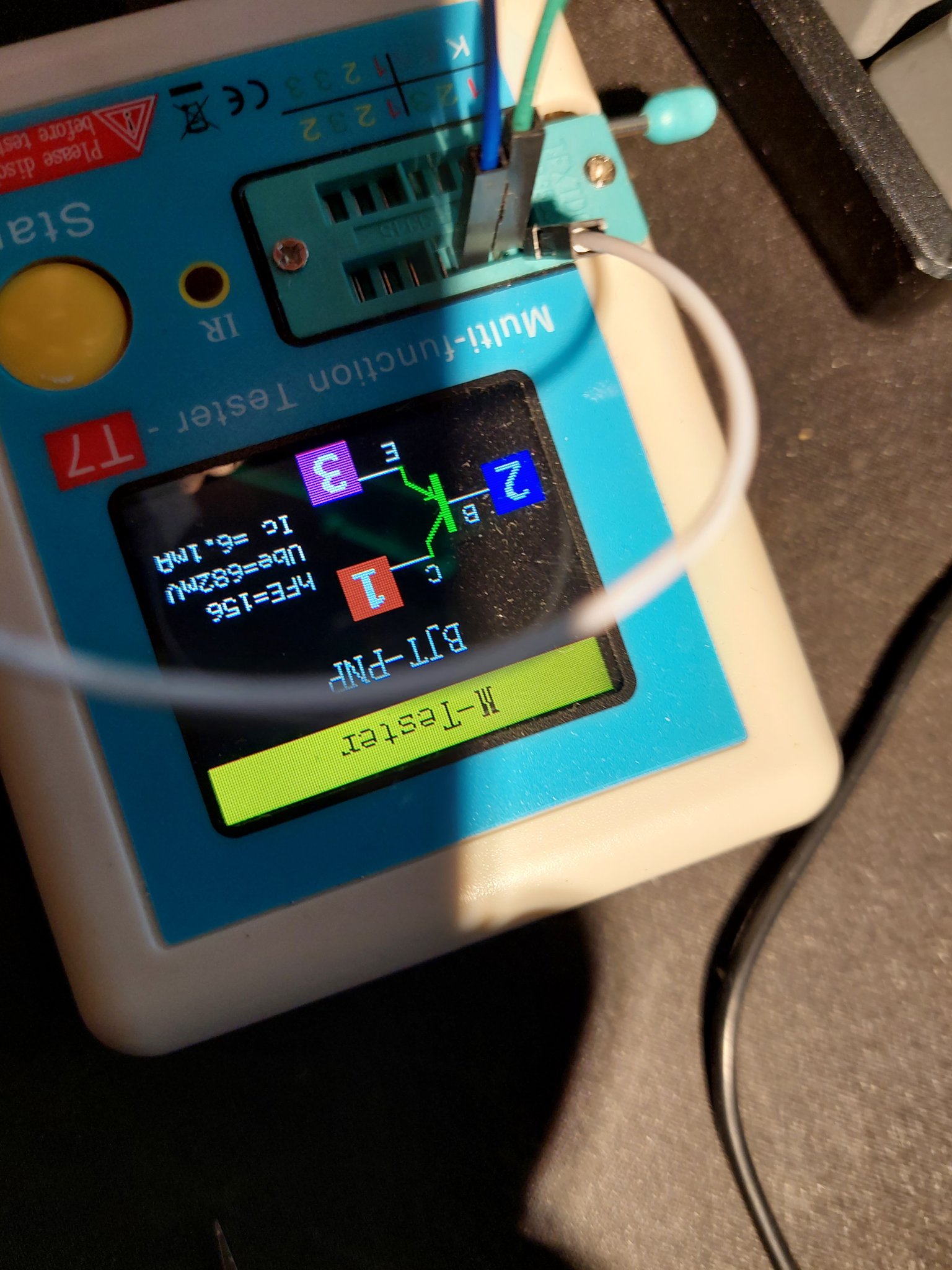

How can Q23 have a collector value of 2.2 and Q35 have 0.4 when they have the same emitter and base values?
I'm guessing that the Ic number means that the tester is measuring hfe with collector current driven to 6.1mA. I'm not spotting the 2.2 and 0.4 numbers; can you advise where to find them?

The observed voltages on Q23 and Q35 are governed by the loading presented at their respective collectors. Both Q23 and Q35 implement constant current sources, each delivering about 4.4mA. Note the different emitter voltages at Q30 and Q31 vs. those at Q26 and Q28. They correspond to the differing collector voltages you ask about.
