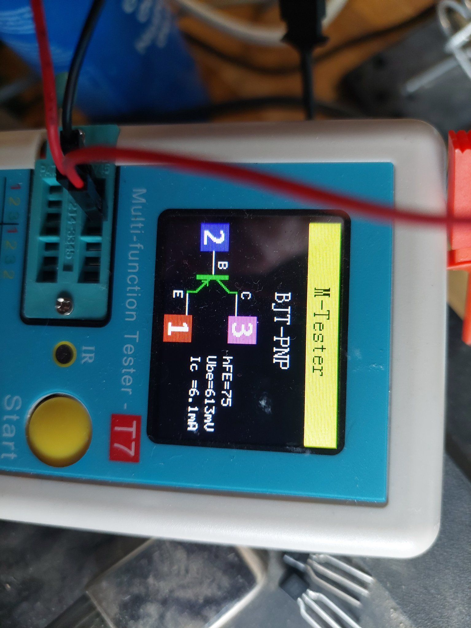

Well, I pulled Q11 and tested it.
It doesn't exhibit the same symptoms as it did in-circuit, but did seem to measure low in hFE, which should be 100-320.
Ic should be 1, according to the datasheet. So maybe it is bad?
