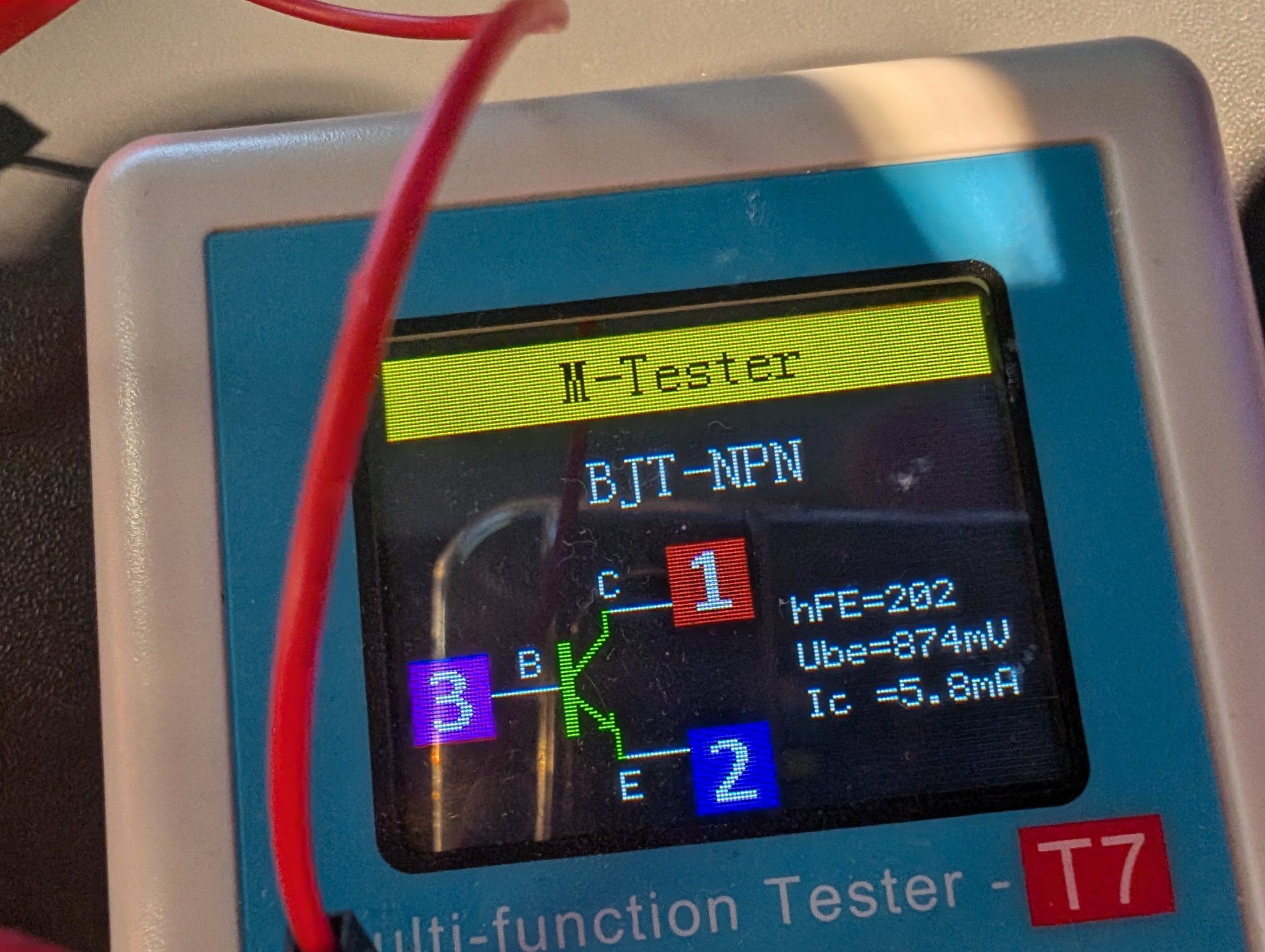

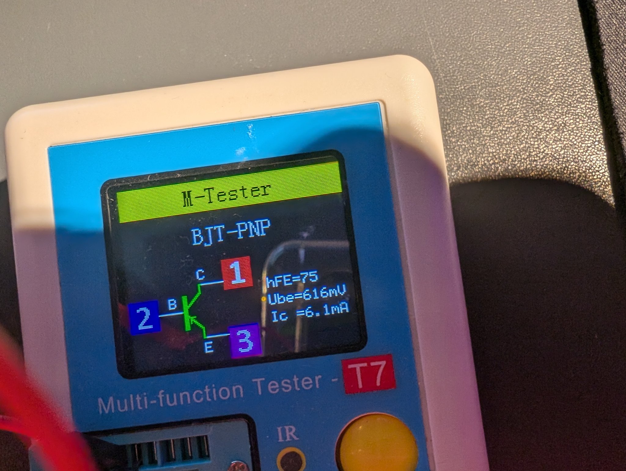

I pulled Q9 to compare to Q11... big difference in hFE. I think I'll find a replacement pair to put my mind at ease. I see they're obsolete, so it might be a bit before I get them.

So, I took the other 2SA1837, which is the removed Q6 and measured it. hFE of 160, so closer than the other. However, the numbers for Q11 still have a low emitter number:
Q11 64.6, 47.8, 51.2
Q9 -69.3, -46.5, -70
I measured the 2SC4793 from Q18 and it measures as two resistors. So I assume defective/blown/junk.
