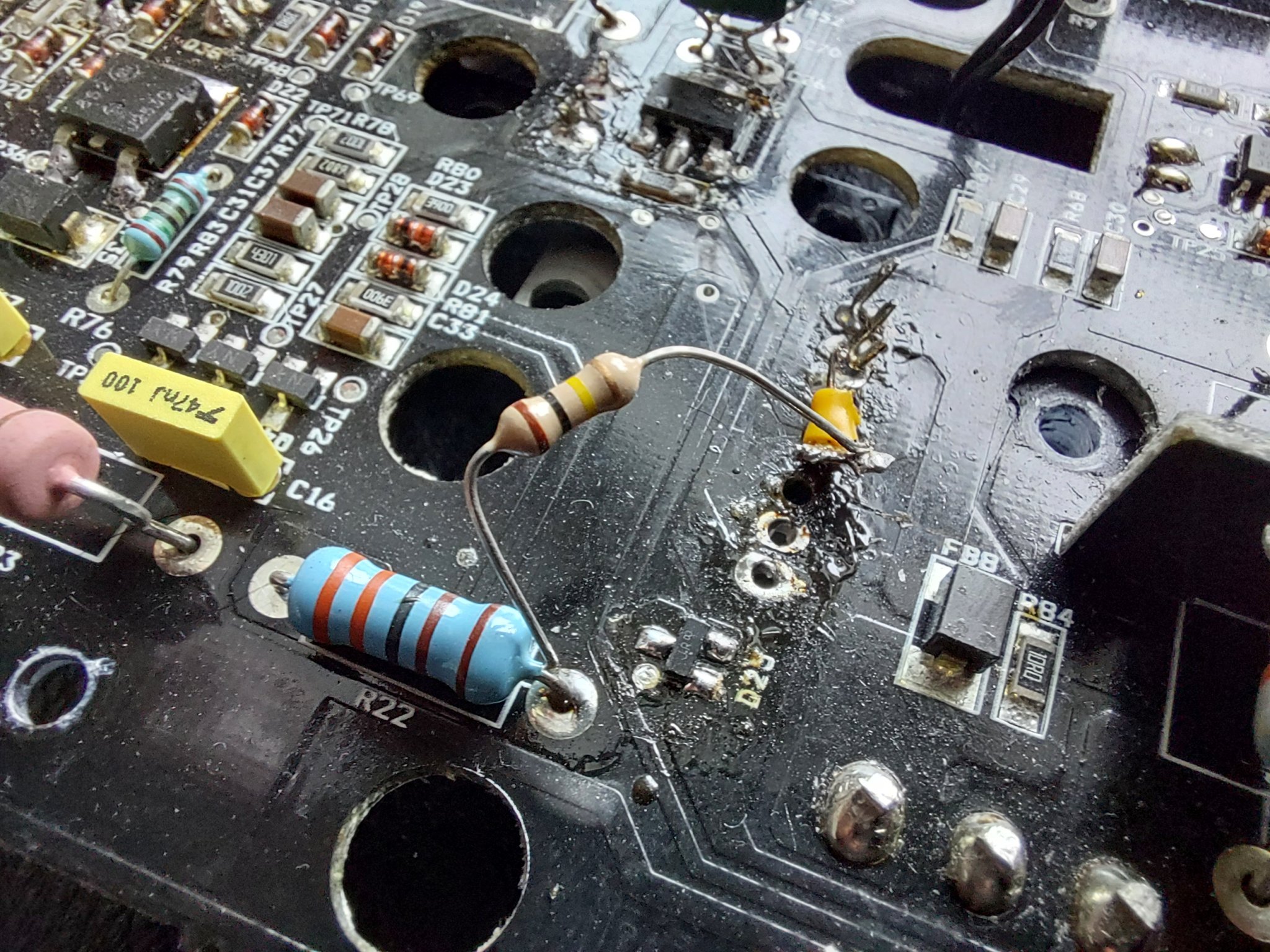

So returning to the 4V base-emitter puzzle: referring to the schematic, there are three components joined at the Q24 emitter: Q24 emitter, Q25 base, D10 cathode. Would you measure voltages re ground of these three connection points, directly on the component leads--- thus exposing possible open traces.
Would you post a closeup pic of the suspect area so I have visual reference?
Thanks again.
So I interpret that the C26 node is stuck on the positive rail, irrespective of bias imposed on Q31 base. There was some suspicion that oscillation was confusing DC voltage measurements, but these experiments suggest closed-loop oscillation is extremely improbable.
Note that with -16V driving the 22k, C26 should properly peg on the positive rail, yet the observed ~4V base to emitter of Q24 phenomenon persists. If you are not able to find a defect with suggestions offered below, don't hesitate to change back to +16V where the expected result is C26 on the negative rail.
In the interest of collecting as much info as possible, with -16V driving the 22k, would you report bases of Q30 and Q31 voltages re ground.

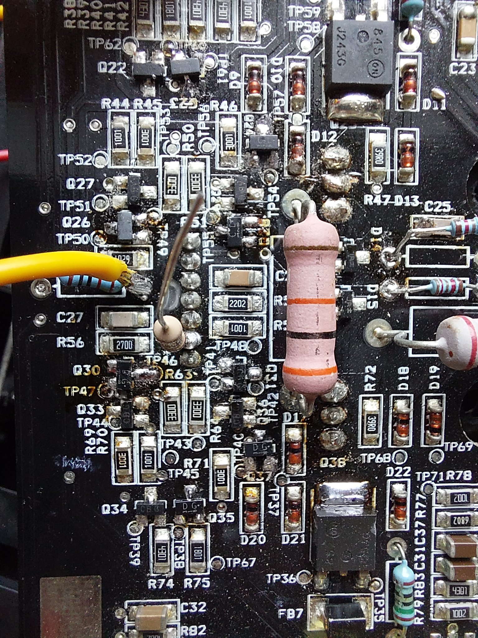

Hi Peter,
Thanks for the photos!
So the emitter of Q24 continues to measure 4V lower than its base, measured in two individual measurements---in other words, voltage re ground at base of Q24 followed by measuring Q24 emitter re ground. Of course, these two voltages shouldn't coexist. Would you also provide the voltages seen at terminals of Q9 to give a more complete picture?

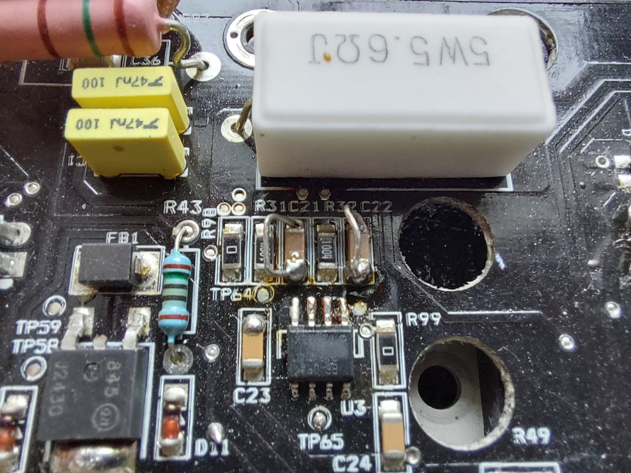

I'm wondering if Q25 is really conducting current. According to above voltages, there should be about 6.7V across R43, i.e. [-76.5V - (-69.8V)]. That's about 0.3W dissipation and R43 is indicated to be a 1/4 W resistor, so it should feel hot. Does it? Do you find 6.7V across its terminals?

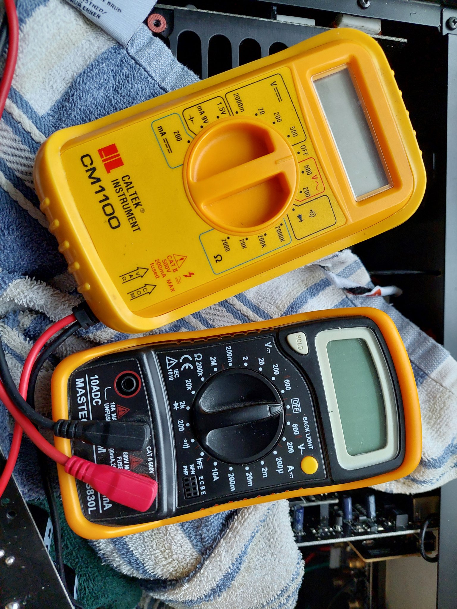

Please tell me about your voltmeters in case we need to use them simultaneously.
Thanks.
Thanks.

So let's return to the Q24 4V base-emitter phenomenon. Would you reconfirm the voltages reported earlier, i.e. the 4V drop persists, then connect one voltmeter from the base of Q25 to ground in a hands-free arrangement. That will leave the other meter free to probe other nodes.
First confirm the two meters agree at base of Q25. Then probe emitter of Q24, then base of Q24. Of course, watch for any change of the first meter's reading. What happens with readings? If you probe Q24 base-to-emitter, any change? This was the baffling data noted in an earlier post. I'm hoping these experiments will make something become clearer.
Thanks.
