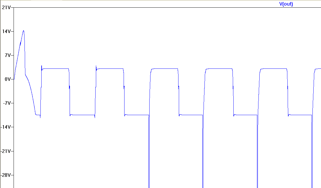

Hi Wahab,
> Using more cycles in sims didn't change the picture.
Hmm....
In my sim it took some time before the DC level got stable, see pic.
If the DC component is still drifting, I get a totally erroneous THD figure. If taken from the 1st cycle for example, THD20k = 18%, instead of 425ppm when taken from a stable cycle.
Apparently, you have tackled this problem in a different way.

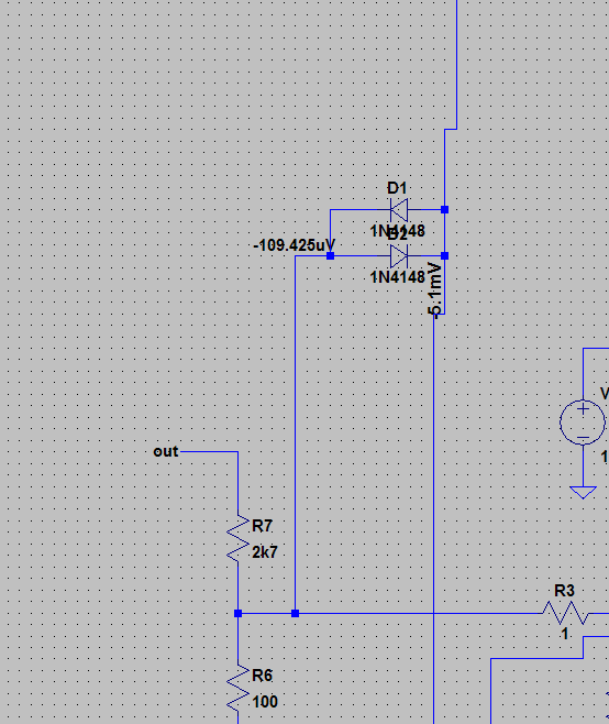

Hi Arthur,Hello Edmond
[snip]
But interestingly diodes D1 and D2 have to be individually boot strapped for the clamp to work in my hands I could not get your approach to work as tying the other ends of the diode together created a problem.
Regards
Arthur
Hmm... That's a bit weird and against all logic. Perhaps it has something to do with a DC offset. Have a look at the voltages across the diodes (should be as small as possible). Maybe this will give a clue.
E.
Hi Arthur,
E.
Hello Edmond
The voltage across is shown in the attachments, are these voltage low enough.
Regards
Arthur

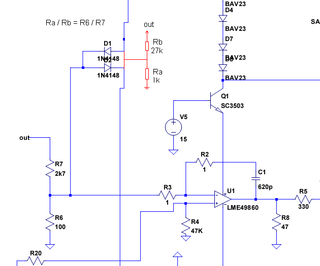

Bootstrapped clamp
Hello Edmond
Here is the single boot strapped clamp.

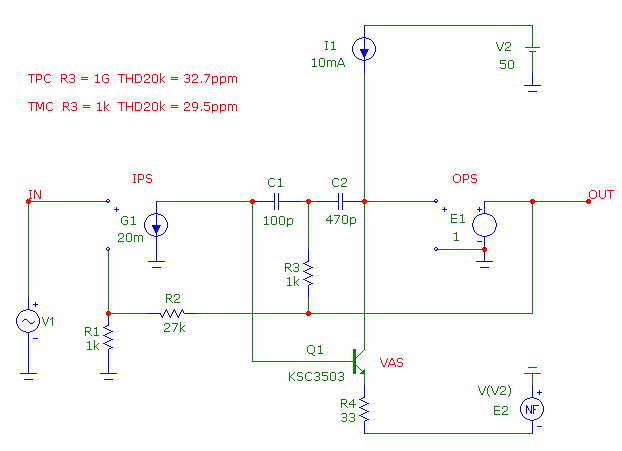

With MicroCap I can specify to ignore the DC component but it can't ignore the effect of DC drift.
Therefore, may I suggest to use another test circuit, that doesn't suffer from DC drift altogether?
What about this one as shown below? An idealized 'blameless' amp, except the VAS, which is a 'real' tranny. The IPS is a transconductance stage with a gain of 20mA/V and the OPS is a simple voltage follower with a gain of 1. THD20k-TPC = 32.7ppm; THD20k-TMC = 29.5ppm.
Since the effect of TPC vs TMC is only marginal, I think that the slight improvement should only be attributed to the unloading of the VAS. If the VAS has benefited from TMC to the same extent as the OPS, then the improvement should be much higher, in the order of 10...20dB, which is not the case.
E.
Hello Edmond
Here is the AC performance with the diodes tied together, with 1.5 V sine wave at input the output should be a sine wave.
Regards
Arthur
Hi Arthur,
Do I understand correctly that if you also connect the diodes together at the right side, the voltage across them rises from a few mV to several Volts???, that is, under normal operating condition. Why? Do I overlook something?
E.

Stupid error
I made a stupid error/typo. In the above text, TPC should read as conventional Miller compensation (CMC). So:
THD20k-CMC = 32.7ppm; THD20k-TMC = 29.5ppm.
Since the effect of CMC vs TMC is only marginal, I think that the slight improvement should only be attributed to the unloading of the VAS.
My humble apologies for the confusion.
E.

Hello Edmond
Attached is the circuit in MC9 format with the same models. All the circuit variations work in MC9 unlike what happens in LTSPICE although I get (check numeric output window for warnings) in MC9.
I am a little confused.
Please forgive my circuits for not being as neat and well drafted as yours.
Can this circuit be modified to accommodate ETMC and CMCL
Regards
Arthur
Hi Arthur,
I've simmed your circuit too and it works as expected.
As I don't have a 100 inch flat screen, I've shrunken your schematic a little bit 😉 and remedied the warnings (see phoenix1).
In version-2 I've lowered the ULGF of the second Miller loop (C2 & C3) to a safer level: from 3Mhz to 1 MHz (by adjusting R9 & R10) and increased the OPS bias to compensate for higher distortion. Also, I've added a kind of 'bleeder resistors' R7 & R8. Together with D1 & D2 plus bootstrap, these guarantees that no current leaks to the inverting input (under normal conditions, of course). At high output voltages (50V) at least one of these two measures are necessary, but to be on the safe side, I would do both.
In principle, yes. But it's not that easy. If you don't mind, I'm not going to figure out how exactly, as I'm not specialized in BJT output stages and already a few month behind schedule. Sorry.
E.
Stuff
Hello Edmond
Thanks for the reworking and I appreciate your effort and time. I would like to ask you a few question on Pheonix 2 . The C4( 8pf) how did you came to this value. How do you check the phase margin of the clamp .
The attached file shows an attempt at how you measure phase margin and ULG is this how you do it. On other R15 and R16 should be 22R its best in practice and in simulation.
I gave a link a couple of threads back for TEN FOUR LTD , did you pick it up they can get the Mosfets that your are after. Have you sorted the supply of these parts.
Regards
Arthur
Hello Edmond
Regards
Arthur
Hello Edmond
Hi Arthur,
I did it the empirical way. Just run an AC or trans. sim and select C4 for the lowest voltage across the clamping diodes at say 20...100kHz. (see my *.CIR files)
How do you check the phase margin of the clamp.
I didn't check it yet. A simple way it to apply a DC voltage of 2...3V at the input and put a gain probe between the diodes and the inverting input of the op-amp.
This is how you get the open loop response. Feedback loops have to be determined in another way. There are two of them: an inner loop and an outer (or global) FB loop. See the attached files and run the AC analysis.
In the mean time I've changed the Miller compensation a little bit: I've moved the take off point to the emitters of the pre-drivers (instead of the VAS output). The reason why I've done this is because the VASes themselves have no current gain (just 1x), so hardly any Miller effect. Including the pre-driver inside the Miller loop provides the necessary gain.
Next, we have to choose appropriate values for the FB resistors to the op-amp output. R11, C2 and C3 determine the ULGF of the inner loop: 1/(2*pi*R11*(C2+C3))
Appropriate values lie between 0.5 and 2MHz. For 1MHz, and C2=C3=47pF, R10 becomes 1k5. Next, we have to choose a suitable ratio between R11 and R10. It should be considerably lower than the closed loop gain (CLG=R3:R4), but not to low, otherwise the op-amp can't handle the voltage swing. As a rule of thumb I set it to about sqrt(CLG), so R10 ~= 270 Ohms. In this case the max. output voltage of the op-amp is 8V.
Run an AC analysis on PHEONIX3-Inner-Loop.CIR to verify the ULGF and phase margin (PM)
Now we have to choose appropriate values for R9 and C2 in such a way that not only the ULGF of the outer loop is the same as the inner loop, but also the (closed loop) step response is critically damped.
This is not as strait forward as in the previous case, as several factors are involved. I think the fastest method is an iterative process and/or a little bit of trial and error. We first start by setting C2 = (C3+C4) * (R11/R3) * (R10+R11)/R10 = 408pF -> 390pF and set R9=0
If you run PHEONIX3-Outer-Loop.CIR you will get an ULGF of 800kHz. Almost good, but at 1MHz the phase response deviates from 90 deg. by as much as 20 deg. and I don't like that. With R9 = 220R, the response is much nicer: ULGF = 980kHz and PM = 87 deg, almost perfect. Now check the step response. In this case it was okay, though in many other cases I had to adjust the components for a better step response, then check the ULGF and PM again, etc. etc.
In what respect? better stability, lower THD? According to John Curl (and many others) 4.7R is optimal
I gave a link a couple of threads back for TEN FOUR LTD, did you pick it up they can get the Mosfets that your are after. Have you sorted the supply of these parts.
Regards
Arthur
I'm almost out of supply, so I visit that website, but got the message: "No matching part numbers found". So, what next?
BTW1, distortion is slightly higher compared to your previous design, but I think better stability is preferable over lower THD at the expense of the phase margin.
BTW2, as you see, now the resistors at the output of the op-amp are much higher, instead of those stupid hot running R's like in the Alexander amp.
BTW3, we are still not done!!! PM check of the compensating and clamp loops, output stage protection, HF input filter, bias generator, Zobel thingy, SOA checks, 15V regulators, etc.
E.
